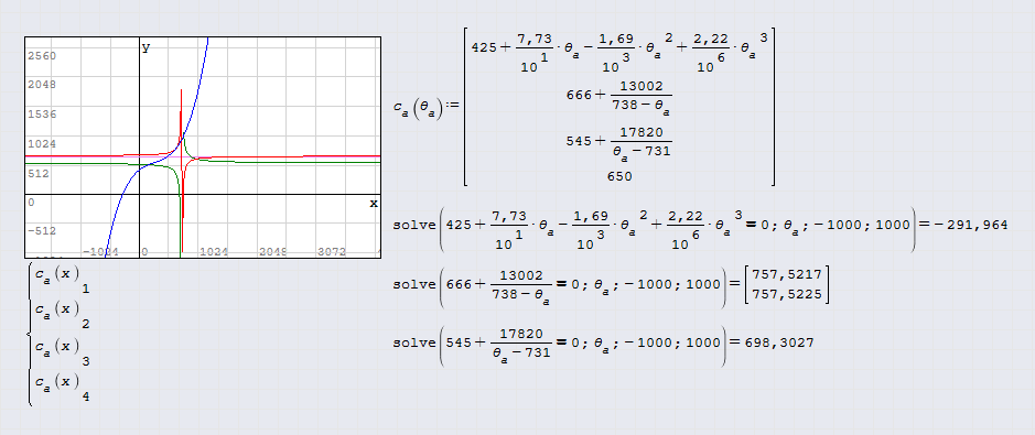

#63 Posted: 5/4/2018 8:55:01 PM
hanskl
hanskl
7 likes in 158 posts.
Hi guys,
I'm back again with more headaches I'm hoping you can help me with.
The last time I wanted (we succeeded ) to make a calculation for the temperature development of UNPROTECTED steel sections during fire.
This time I want to make a similar calculation for PROTECTED steel sections. Most of the work that was done on the last sheet is reused. However, the expressions for temperature development this time seems (to my eyes) to be a bit trickier. In the sheet I have pointed out where I am stuck. The image shows the example I am trying to follow.
Any help on this is greatly appreciated. :d

#64 Posted: 5/5/2018 11:23:07 AM
Hello ! Hans
Will be back on that soon ... cheers.

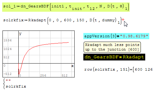

#66 Posted: 5/6/2018 10:41:18 PM
I have added some graphic illustrations to highlight what is going on with some of the variables..
All the graphs down to the DE solvers work fine ... but
======== the suite of 6671 is not compatible with 6179 ========
Simply disastrous that dn_GearsBDF 6179 is not compatible 6671.
The suite 6671 looks correct, sorry for this handicap.
Maybe more collab will terminate checking.
Cheers Hanski ... Jean

#67 Posted: 5/7/2018 12:43:21 AM
... going back to your original 6671, the suite looks ok.
Not sure if I understand the meshing of the solvers from
the stacked "res"... missed something in there.
See you Norway ! ... Jean

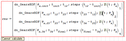

#69 Posted: 5/7/2018 3:39:09 AM
hanskl
hanskl
Temperaturforlop i isolerte stalkonstruksjoner ved brann page2.sm (57.26 KiB) downloaded 1235 time(s).
Jean,
I must be missing something.. I tried to downgrade to suite 6671, and dn_GearsBDF still tells me it cannot calculate.
I don't understand why the DE cant handle e^ø. Or have I constructed the DE wrong?
Best regards,

#71 Posted: 5/7/2018 10:22:45 AM
Jean,
The books style are very difficult to put it executable.
Your DE setup looks quite correct: proof the first one works
but the 2, 3, 4 "Division by 0". It must have to do with the
meshing of the Solver. It does not like something in there.
Should work in your latest 6671.
I simply reconstructed piece wise, simplified, on my 6179.
See U tonight ... Jean

You mean you downgraded 6179
#72 Posted: 5/7/2018 4:00:25 PM
hanskl
hanskl
Jean,
Temperaturforlop i isolerte stalkonstruksjoner ved brann page2 fixed.sm (269.27 KiB) downloaded 1257 time(s).
Jean,
I can not get it to work in my current version of Smath.
Is it possible another solver has to be used? One of the Runge-Kutta versions maybe?
You are quite right though, the fact that the first of the four equations work on your sheet suggests that it should work. However, that values in the solution you posted is quite wrong... Not quite sure why that is though, has to be something with the input.
I'm quite curious as to what the workaround/solution to this project will be. Looking forward to seeing what you will come up with
Best regards,
Hans Kristian
#73 Posted: 5/8/2018 12:47:40 AM
Jean,
Hanski,
A bit of headache
Those solver may fails ... guess the cause "Division by zero".
You should have the first segment running as the picture.
Just to show how difficult it could be, read the ODE Yuk.
Temperaturforlop Compactum.sm (60.13 KiB) downloaded 1097 time(s).

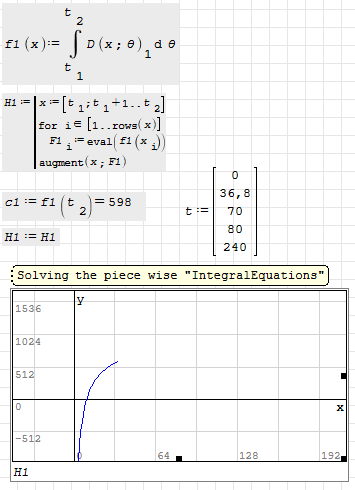

#76 Posted: 5/8/2018 8:12:25 AM
... Oh ! it didn't upload.
17 solvers, only rkfixed responds at very specific 'N'
ODE Yuk.sm (27.65 KiB) downloaded 1099 time(s).
#77 Posted: 5/8/2018 10:44:00 PM
Is Mathcad able to handle this DE? Can anyone try to solve it there?
I doubt because rkfixed, Rkadapt are same.
The first segment maybe ? from the "Stiff option"
Good news is that the project has an elegant solution.
It consists in solving the Integral Equation
Will post it before bed time ...
#78 Posted: 5/9/2018 12:03:51 AM
... maybe there is some applicable scaling factor ? ?
Temperaturforlop Compactum Copy.sm (48.23 KiB) downloaded 1159 time(s).

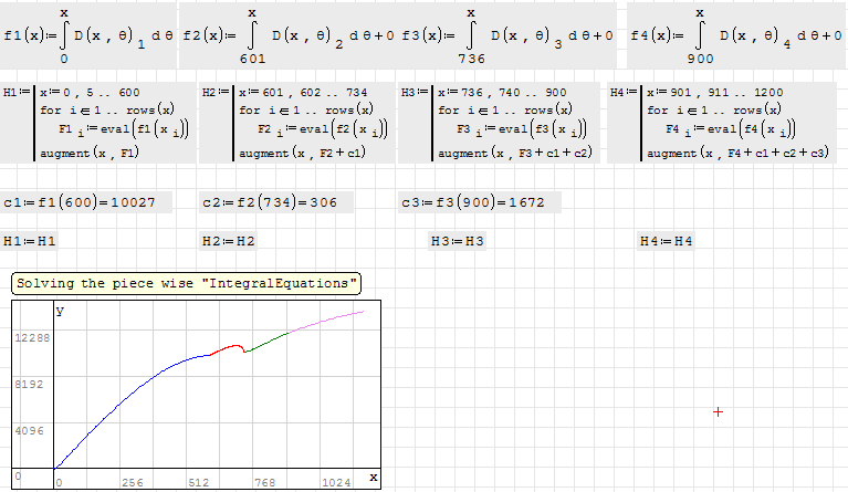

#79 Posted: 5/9/2018 4:31:13 AM
hanskl
hanskl
Interesting! I will look into this later this evening!
But from the top of my head - the X-axis should represent time in minutes, not temperature.
Also, it took quite some time for the sheet to finish calculating.
Best regards,
Hans Kristian
#80 Posted: 5/9/2018 10:55:01 AM
Best regards,
Hans Kristian
1. You can leave it in native 't'
2. the default Integration accuracy is 100, set it 50
it will have no influence in this application but much faster.
1.7 min in my 1.66 GHz laptop runs 225 greedy maths.
3. Does your version bracket t:=[0,5..600] ?
rather than Smath 6179 t:=0,5..600
Temperaturforlop Compactum Copy.sm (53.22 KiB) downloaded 1144 time(s).
