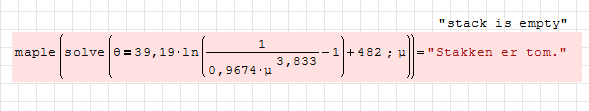

I just added the Maple plugin. It now tells me the input format is not valid...

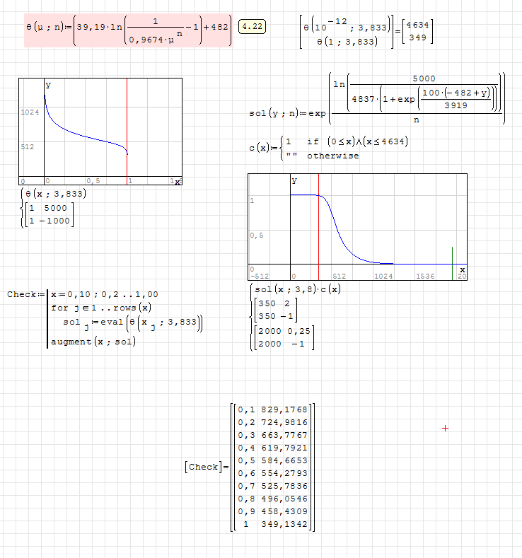

#26 Posted: 10/26/2017 6:25:00 PM
This is the result I get.. I don't understand..
Ah ! Your attempt is incorrect, why ?
Power function X^Y is devil to maths. It involves ln(x) & exp(x),
Thus too reflexive for any symbolic solver, you must generalize.
See attached all, correct now.
Cheers, Jean
4.2.5 Steel temperature development.sm (41.33 KiB) downloaded 1098 time(s).

I'm sorry, but I really don't understand your approach to solving the equation 4.22 for my.0. But the results in the Check-matrix are indeed correct. Can you please explain what you did there?
Thanks

#30 Posted: 10/26/2017 11:23:15 PM
By inspection, if μ is < 1, we know in advance the result will be complex.
The "check" was to confirm this assumption. When you say solve for μ,
you are correct in your own words. In fact the matter is to inverse the roles.
From the explicit f(x):= ... where 'x' is given on range, now you want the
inverse of the procedure, i.e: given f(x) solve for 'x'. The procedure is
called "inversing". The Maple solution is the InverseFunction.
On that, Smath/Maple companions are far superior to Mathcad 11/Maple.
Please, read more on the revisited work sheet.
I will look at Radovan.
Cheers, Jean
4.2.5 Steel temperature development.sm (38.13 KiB) downloaded 1073 time(s).

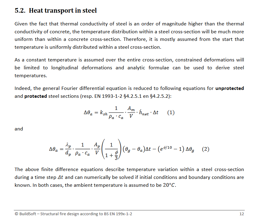

Edit: found a pdf which have tabulated θ.a(t) for different values of k.sh*A.m/V (=0.9V/A.m,b)
Page 7-10
tables for theta.a
Edit2: found another pdf which discusses the differential equation. It is apparently a Fourier equation, if that helps matters any.
Page 12-16
Fourier equation
