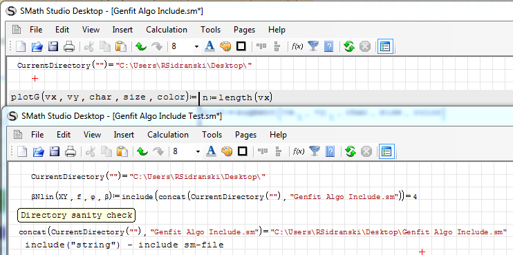

Using Jean's files in the same directory, I updated to Mike's sheet and compared it to UNI's pdf ... I still have an error in the re-definition of BETA. Using latest SMath and plugins.
This is on my work computer ... not the one at home.
BTW, I tried with both files on my desktop and in the "C" drive.

Not that BETA ... the one to the right of "FIT" per my screenshot. Everything up to that point matches UNI's PDF. I've tried moving the "BETA" down. I think that is why I have red boxes below.
#104 Posted: 4/16/2016 12:10:09 AM
уни
уни
156 likes in 355 posts.
βNlin() redefined (βNlin() := include() = 4).

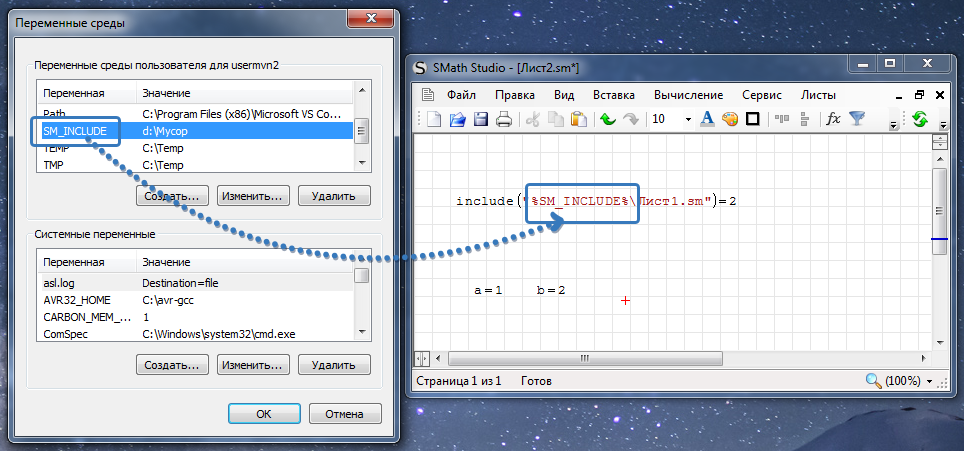

Access to Windows Enviroment Variables would be really nice:
include("%SM_INCLUDE%\fn.sm"=10
Do you think it's possible?
Thank you
#106 Posted: 7/26/2017 2:31:54 AM
1,555 likes in 1,867 posts.
Yes, it is possible. Will be in new release.

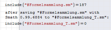

Hi!
I updated to SMath Version 0.99.6884.
Include() cannot read Sheets saved with this SMath Version. The result looks like include(...)=0.
By examining the files I found the new worksheet tag. And the regions tag moved downwards.
after saving with 0.99.6884:

Maybe that's the reason?

#111 Posted: 11/13/2018 7:41:52 AM
Updated (plugin version changed to 0.2.x.x). Try now.
Old worksheets must be saved in the new format.

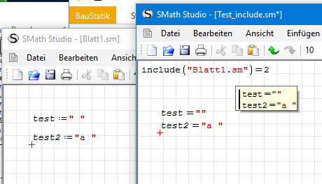

found a little bug in include():
Strings containing only one space " " are imported as an empty string.
Вячеслав Мезенцев 2/22/2019 8:40:00 AM
#113 Posted: 2/22/2019 8:40:39 AM
Updated. Try now.
Martin_B 2/22/2019 9:02:00 AM

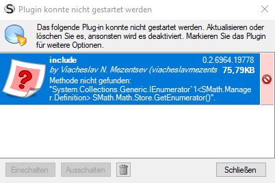

As the plugin is not offered through the plugins dialog, I downloaded the latest file directly and replaced the current one.
But that doesn't work:
#115 Posted: 2/22/2019 10:20:27 AM
1,443 likes in 2,936 posts.
I use the latest stable 0.99.6884.
The plugin was compiled for a more recent SMath Studio, that's why you can't get it through the extensions manager and why you get the error message (in short the library rely on a different interface than the one available in your version, they can't talk each other)

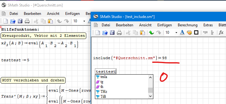

Edit:
I have a more comprehensive sheet, which I include:
now (0.99.6988 with updated include extension) the result of include is shown as usual (98 elements), but they are not accessible:
At first start a few equations were present, but finally I can't get it to work.
I can't even say, if the beta Smath app or if the extension is making troubles.
The old extension 0.2.6982.28030 works correctly, apart from " ".

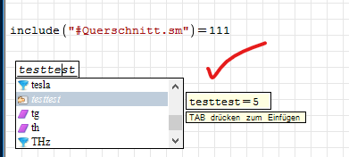

#117 Posted: 2/22/2019 10:14:45 PM
Updated. Added support for 0.99.6884.
Show me .log file from the plugin directory.

#120 Posted: 2/23/2019 9:24:05 PM
Updated. Try now.
Martin_B 2/24/2019 5:20:00 AM
