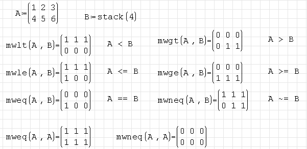

Updated. mwsign(1), mweq(2), mwge(2), mwgt(2), mwle(2), mwlt(2), mwneq(2) added.
Relational operations (Reference, p. 32).
Davide Carpi 8/20/2013 7:30:00 AM, Radovan Omorjan 8/20/2013 7:23:00 AM
#11 Posted: 8/20/2013 7:30:29 AM
Thank you uni. It seems I was right
By the way, the second argument does not need to be a matrix. Scalar will do the job as well

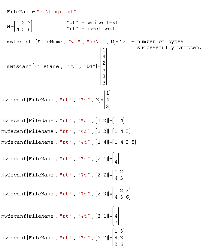

Updated. mwfprintf(4), mwfscanf(3), mwfscanf(4).
Quote
Yes, but it's an undocumented feature. The function takes a matrix as a parameter.

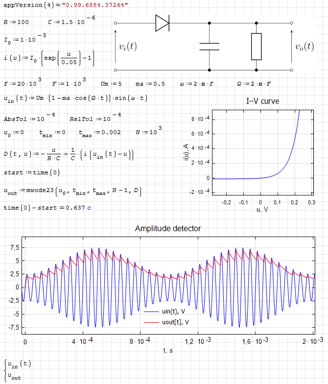

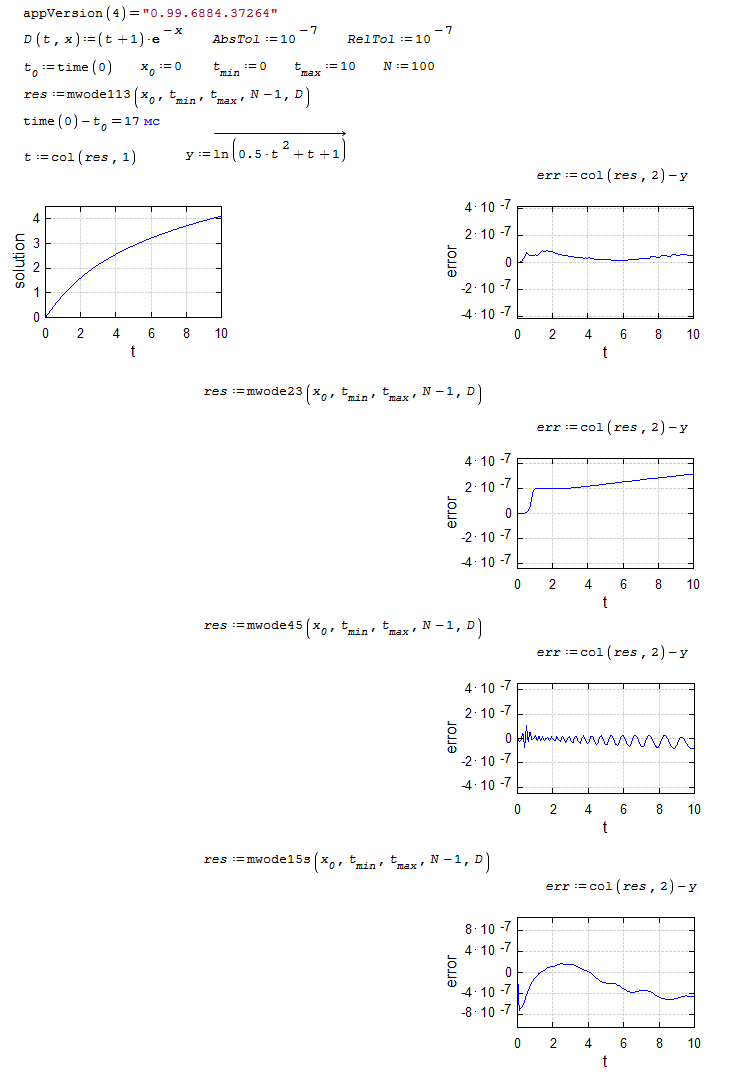

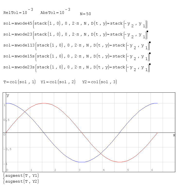

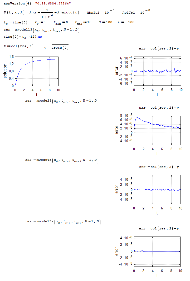

Updated. mwode45(5), mwode23(5), mwode113(5), mwode15s(5), mwode23s(5) added.
mwode45(5) - (init, x1, x2, intvls, D) solve non-stiff differential equations, medium order method.
mwode23(5) - (init, x1, x2, intvls, D) solve non-stiff differential equations, low order method.
mwode113(5) - (init, x1, x2, intvls, D) solve non-stiff differential equations, variable order method.
mwode15s(5) - (init, x1, x2, intvls, D) solve stiff differential equations and DAEs, variable order method.
mwode23s(5) - (init, x1, x2, intvls, D) solve stiff differential equations, low order method.
Matlab C++ Math Library. ODE solvers. Arenstorf orbit.pdf (99.13 KiB) downloaded 1353 time(s).

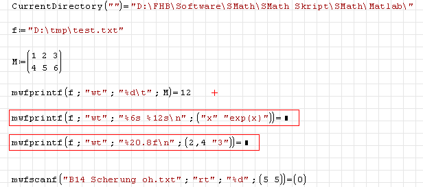

Quote
Now it is documented, but perhaps not officially supported ;-) Is there any chance to overload the operators? Do they have internal functions that could be overwritten?
Also, thanks for the file ops. Writing of strings is not supported so far?
I fail to read the datafile even if I remove the first line with the column titles. Would be interesting to see what performance we get.

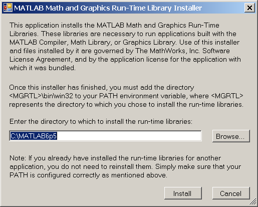

I would like to point the user to the environment variable editor using the command line
"C:\Windows\system32\rundll32" sysdm.cpl,EditEnvironmentVariables
in the plugin handbook page.
but I have no idea how that can be made a link target in the hyperlink region (due to the " signs in the link). Davide, any idea?
An alternative would be that the installer tests for the presence of dll and path entry and adds the entry if required.

I am using Win7 and got the command line from the program manager after clicking through the system control hierarchy. Faster is to locate the dialog via search for "Umg", german for "env".
#20 Posted: 8/23/2013 3:42:17 AM
1,361 likes in 2,275 posts.
Updated. Now the installer is located within the plugin.
There is an user interaction issue. After updating the plugin and re-starting smath,
the installer dialog pops up and offers installation. You are also informed that you do not need installation if you already have the runtime environment installed. In this case it is natural that the user chooses [Cancel]. Then, however, the dialog pops up every time you launch smath.
If you choose [Install] even if you know that nothing needs to be installed, then suddenly the installer gets aware of that and just finishes and no more messages appear on start-up.
