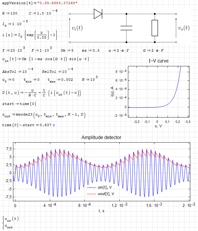

Matlab C++ Math Library. ODE solvers. Amplitude detector.sm (14,36 КиБ) скачан 2489 раз(а).

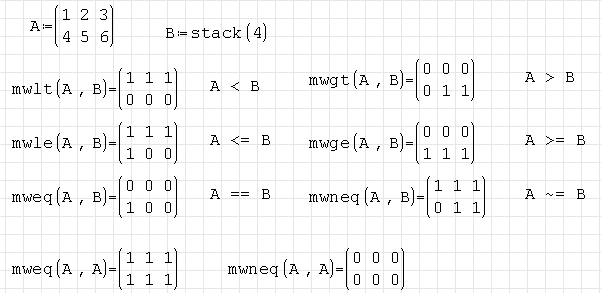

Updated. mwsign(1), mweq(2), mwge(2), mwgt(2), mwle(2), mwlt(2), mwneq(2) added.
Relational operations (Reference, p. 32).

#11 Опубликовано: 20.08.2013 07:30:29
Thank you uni. It seems I was right
By the way, the second argument does not need to be a matrix. Scalar will do the job as well

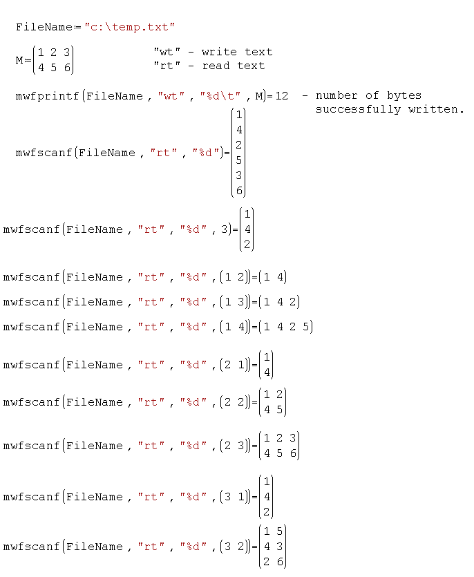

Updated. mwfprintf(4), mwfscanf(3), mwfscanf(4).
Yes, but it's an undocumented feature. The function takes a matrix as a parameter.
Martin Kraska 21.08.2013 17:46:00, Radovan Omorjan 21.08.2013 05:40:00

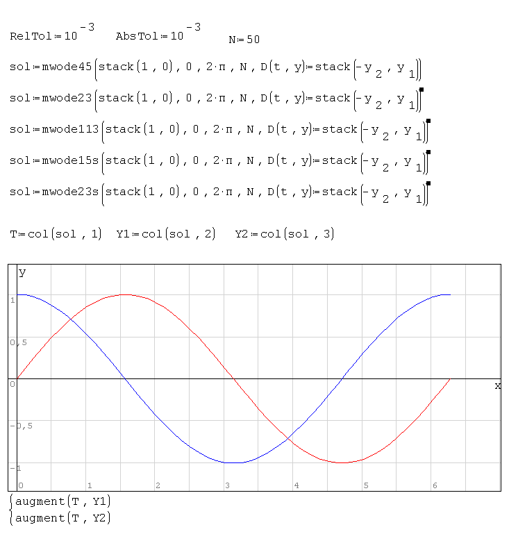

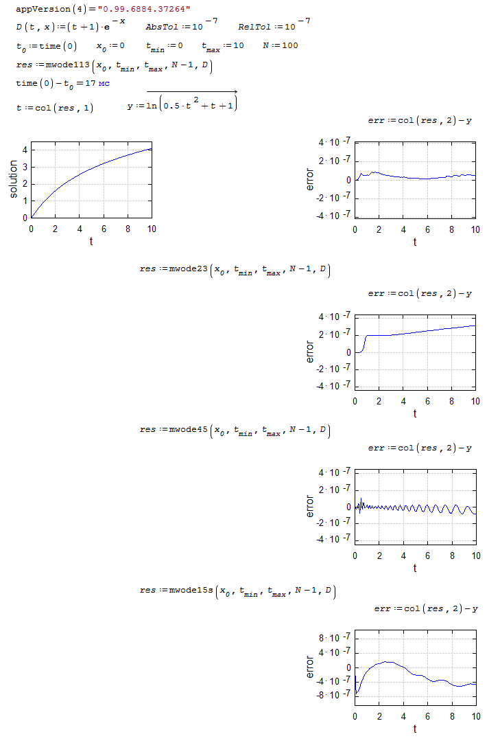

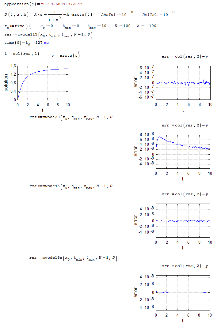

#13 Опубликовано: 21.08.2013 06:53:30
Updated. mwode45(5), mwode23(5), mwode113(5), mwode15s(5), mwode23s(5) added.
mwode45(5) - (init, x1, x2, intvls, D) solve non-stiff differential equations, medium order method.
mwode23(5) - (init, x1, x2, intvls, D) solve non-stiff differential equations, low order method.
mwode113(5) - (init, x1, x2, intvls, D) solve non-stiff differential equations, variable order method.
mwode15s(5) - (init, x1, x2, intvls, D) solve stiff differential equations and DAEs, variable order method.
mwode23s(5) - (init, x1, x2, intvls, D) solve stiff differential equations, low order method.
Matlab C++ Math Library. ODE solvers. Arenstorf orbit.pdf (99,13 КиБ) скачан 1353 раз(а).
Martin Kraska 21.08.2013 17:45:00, Radovan Omorjan 21.08.2013 08:11:00

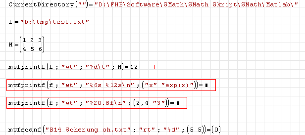

Now it is documented, but perhaps not officially supported ;-) Is there any chance to overload the operators? Do they have internal functions that could be overwritten?
Also, thanks for the file ops. Writing of strings is not supported so far?
I fail to read the datafile even if I remove the first line with the column titles. Would be interesting to see what performance we get.
One remark to function naming: This is of course entirely in the souvereignity of the plugin creator. Still I would make some recommendations, driven by

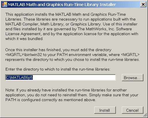

I would like to point the user to the environment variable editor using the command line
"C:\Windows\system32\rundll32" sysdm.cpl,EditEnvironmentVariables
in the plugin handbook page.
but I have no idea how that can be made a link target in the hyperlink region (due to the " signs in the link). Davide, any idea?
An alternative would be that the installer tests for the presence of dll and path entry and adds the entry if required.

#20 Опубликовано: 23.08.2013 03:42:17
Updated. Now the installer is located within the plugin.
There is an user interaction issue. After updating the plugin and re-starting smath,
the installer dialog pops up and offers installation. You are also informed that you do not need installation if you already have the runtime environment installed. In this case it is natural that the user chooses [Cancel]. Then, however, the dialog pops up every time you launch smath.
If you choose [Install] even if you know that nothing needs to be installed, then suddenly the installer gets aware of that and just finishes and no more messages appear on start-up.
