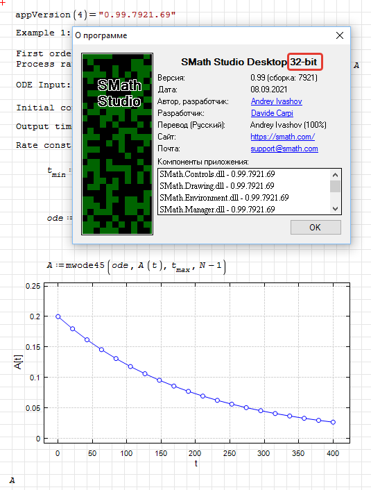

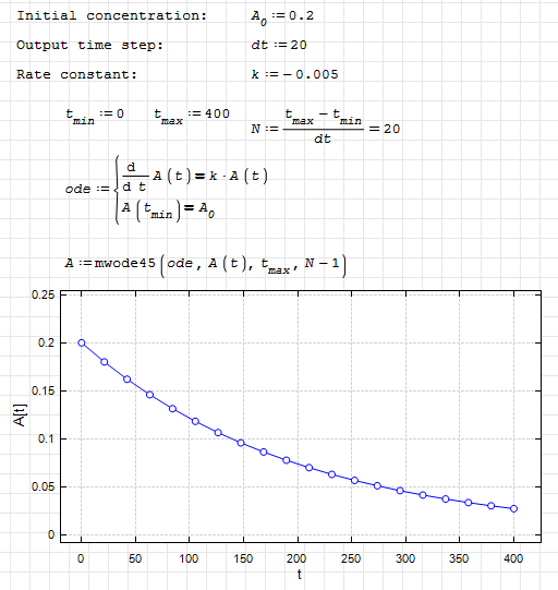

Plugin updated. Only the 32-bit version is available.
Changes:
- plugin renamed to Matlab Runtime Library;
- converting the task for the ODE solvers to the numerical form is now performed through the Mathcad Toolbox plugin (to avoid code duplication), so it must be installed;
- totally refactored.

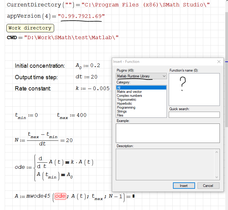

Dear Viacheslav,
thank you for the plugin.
Can I ask a quick question?
Does it work only with the older version?
By me, unfortunately, this plugin is not accessible.
Best regards,
Andrey
#84 Posted: 1/10/2022 5:41:40 AM
1,555 likes in 1,867 posts.

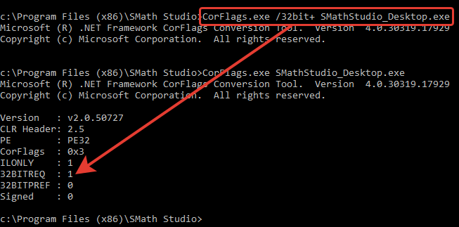

You need to switch the program to 32-bit mode. This is an old library and didn't exist at that time in 64-bit form. That is why I additionally pointed it out.

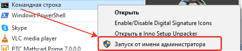

You must manually change the bitness of the executable file in administrator mode. After that, the library will become available.
CorFlags will help you to use this plugin on 64-bit system.
32-bit ON: CorFlags /32bit+ Solver.exe or CorFlags /32bit+ SMathStudio_Desktop.exe
32-bit OFF: CorFlags /32bit- Solver.exe or CorFlags /32bit- SMathStudio_Desktop.exe

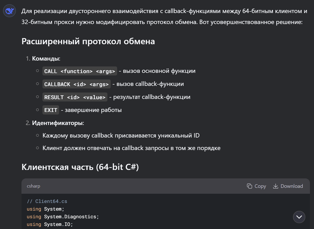

Deepseek advised how to use a 32-bit application in a 64-bit environment. It will be slower, but practically possible. If desired, it will be possible to connect the old engine. ODE solvers will also work. The slowdown will be due to the fact that the interaction interface will be string-based, but it is better than nothing.

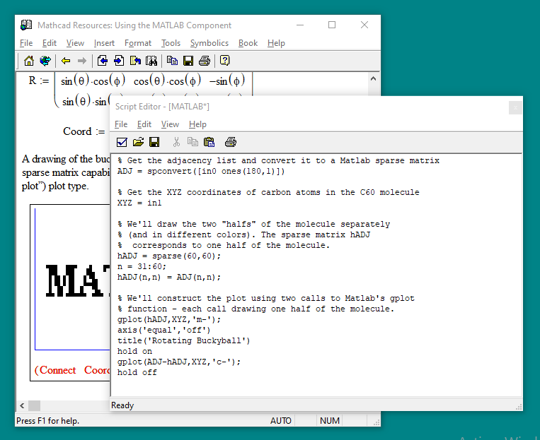

Hi. Maybe something like octave(string, A, B, C, ...) where string is the octave code, as string itself or the description in a variable. The code can include the smath variables in#1, in#2, in#3, ... which would be replaced by SMath variables A, B, C, ... Like in Mathcad matlab component, but with the sharp, so you can just make the subs with an strreplace instruction.
For simplicity, the result of the octave function would always be a single matrix, perhaps with some symbolic result, but always a matrix.
Finally, just as was implemented with Maxima, you can download a version of Octave for the user if the function don't find one already installed, as it is open source and does not require a special license to install silently.

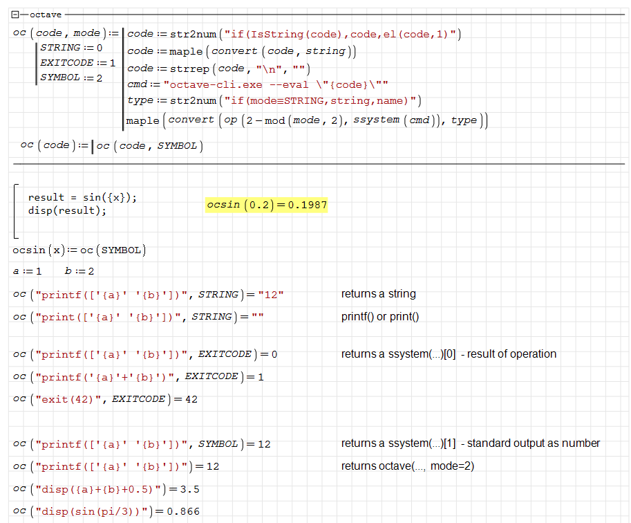

If the expression must be entered by the user and is not known in advance, then the following format can be used:
octave( "command({var1},{var2})" )      # var1,var2 - smath variables
This is inconvenient, if you use many functions in a program, then this octave() will be everywhere.

#95 Posted: 7/28/2025 7:33:26 PM
You can use an existing method. The octave-cli.exe interpreter must be accessible via known paths.
maple-octave-mode.sm (12.45 KiB) downloaded 1533 time(s).
