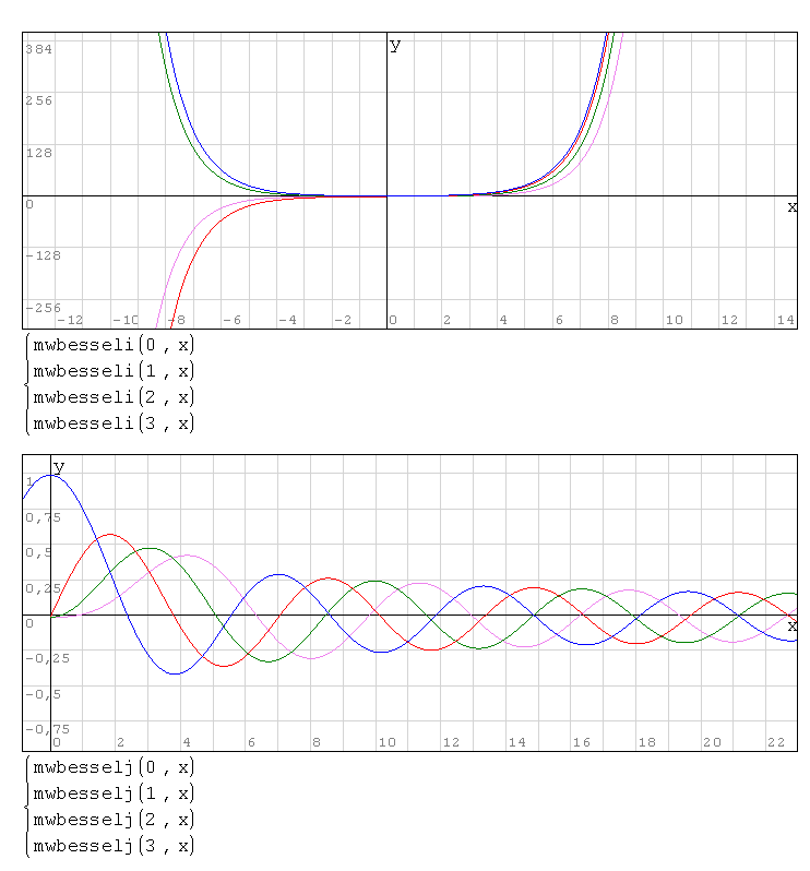

#31 Posted: 8/25/2013 7:35:46 AM

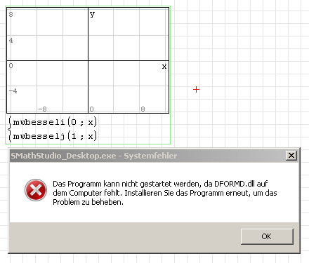

#32 Posted: 8/25/2013 8:29:05 AM
I confirm the problem. The log in bin/win32 says
25.08.2013 14:18:54 [ERROR] [mwbesseli] Failed to load MEX-File : besselmx.
25.08.2013 14:19:00 [ERROR] [mwbesseli] Failed to load MEX-File : besselmx.
25.08.2013 14:19:09 [ERROR] [mwbesselj] Failed to load MEX-File : besselmx.
25.08.2013 14:19:16 [ERROR] [mwbesselj] Failed to load MEX-File : besselmx.
25.08.2013 14:19:20 [ERROR] [mwbesselj] Failed to load MEX-File : besselmx.
25.08.2013 14:20:55 [ERROR] [mwbesseli] Failed to load MEX-File : besselmx.
and I get an error message from SMath (translated)
The program cannot be launched because DFORMD.dll is missing on your computer. Re-install the program to solve the problem.
such a dll is present on my system as part of the ANSYS finite element package.

#33 Posted: 8/25/2013 9:00:05 AM
I checked the log.txt file. There is only one message repeating when I call any of the bessel functions
8/25/2013 2:22:55 PM [ERROR] [mwbesseli] Failed to load MEX-File : besselmx.
when I try to use mwbetainc() there is only one message about the first argument
8/25/2013 2:45:00 PM [ERROR] [mwbetainc] X must be in the interval [0,1].

#34 Posted: 8/25/2013 9:13:29 AM
Updated. Try now. As for mwbetainc(), I don't know yet what's going on.
Radovan Omorjan 8/25/2013 9:20:00 AM
#35 Posted: 8/25/2013 9:21:39 AM
WroteUpdated. Try now. As for mwbetainc(), I don't know yet what's going on.
I can confirm that mwbesselx() functions are working for me

#36 Posted: 8/26/2013 5:37:51 AM
Updated. 112 functions.
