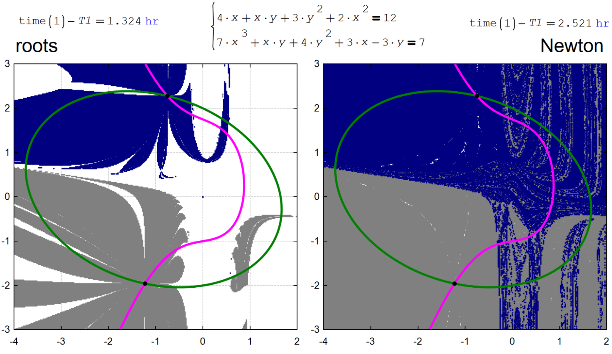

#6 Posted: 2024/2/11 02:53:28
Valery Ochkov
Valery Ochkov
66 likes in 690 posts.
Roots vs Newton
#7 Posted: 2024/2/11 07:55:50
oots vs Newton
No interest vs the codes
#8 Posted: 2024/2/11 13:41:06
Valery Ochkov
Valery Ochkov
Roots vs Newton
https://www.mdpi.com/2227-7390/10/19/3413

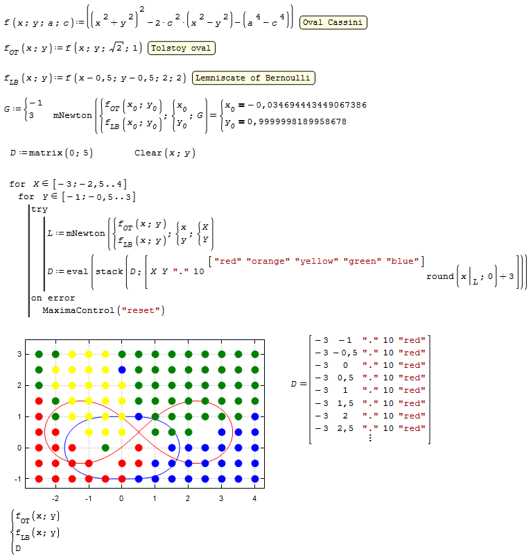

#10 Posted: 2024/2/13 06:19:59
1,355 likes in 2,271 posts.
mNewton() from the Maxima plugin is another option. It also may fail for particular initial guess values.
mNewton.sm (16.22 KiB) downloaded 1470 time(s).
