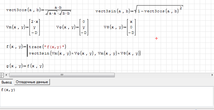

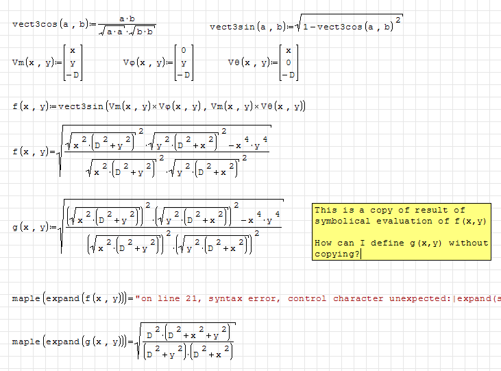

testassign.sm (14.53 KiB) downloaded 1030 time(s).
Sorry, have not found the answer. Attached is a sample with two functions f(x,y) and g(x,y).
In the sample I have just copied the result of symbolical evaluation of f(x,y) to g(x,y). How to perform this assignment directly? I need g(x,y) to be updated if input vectors change.
Easy to see that symbolical evaluation does not change f(x,y). Maple can undestand g(x,y) but not f(x,y).

#5 Posted: 2017/5/3 14:35:35
1,554 likes in 1,864 posts.
maple() function doesn't understand smath cross product symbol. It is not supported in the current version.

... just assign like this g(x,y):=f(x,y)
shown in red Smath 6179 attached.
Does it work for you ?
Hello Jean,
no, it does not work. It assigns original f(x,y) to g(x,y) and not symbolically evaluated, see blue fields in attachment.
testassign1.sm (18.6 KiB) downloaded 1018 time(s).

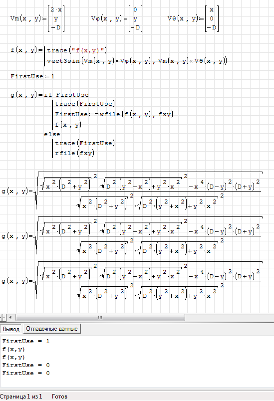

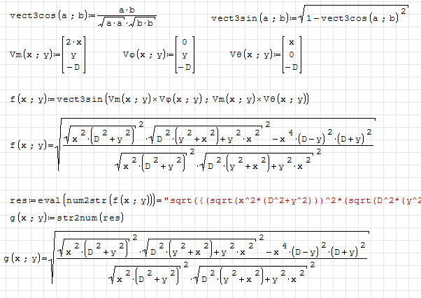

#7 Posted: 2017/5/3 16:57:46
1,355 likes in 2,271 posts.
This works.
testassign_Kr.sm (17.97 KiB) downloaded 983 time(s).

Thanks to Martin and Viacheslav for working solutions!
As I understood, there is no regular way in SMath to access already existing result of symbolic evaluation. The solutions are tricks to export the result to string/file and to import it back.
What looks irritating for me, some functions take symbol definition as input, e.g. maple() functions, other functions, like num2str() and wfile(), take the result of symbolic evaluation as input!? Is this the special property of maple() or num2str(), wfile() functions only? If not, how to determine what will given function take as input?

#13 Posted: 2017/5/4 14:34:02
... as far as I understand: you request for TWO cross-product.
In fact, there are more that you can collect/spool to file.
testassign_Kr.sm (11.95 KiB) downloaded 981 time(s).

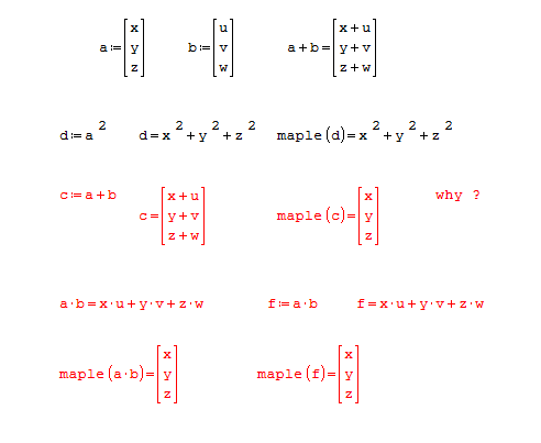

#19 Posted: 2017/5/6 04:20:38
I might be wrong here, but I think the question is about something like this regarding maple.
If you can not reproduce this, there might be something wrong with my SMath.
Regadrs,
#20 Posted: 2017/5/6 06:32:36
This is bug in maple() function. Not all operations are performed correctly during the conversion.
