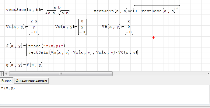

#3 Опубликовано: 03.05.2017 12:41:23
avanturist
avanturist
2 сообщений из 9 понравились пользователям.
testassign.sm (14,53 КиБ) скачан 1196 раз(а).

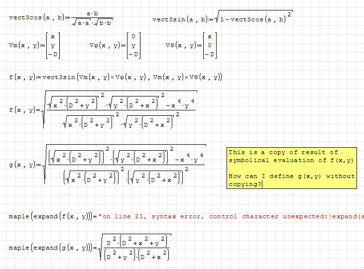

Sorry, have not found the answer. Attached is a sample with two functions f(x,y) and g(x,y).
In the sample I have just copied the result of symbolical evaluation of f(x,y) to g(x,y). How to perform this assignment directly? I need g(x,y) to be updated if input vectors change.
Easy to see that symbolical evaluation does not change f(x,y). Maple can undestand g(x,y) but not f(x,y).

#5 Опубликовано: 03.05.2017 14:35:35
maple() function doesn't understand smath cross product symbol. It is not supported in the current version.

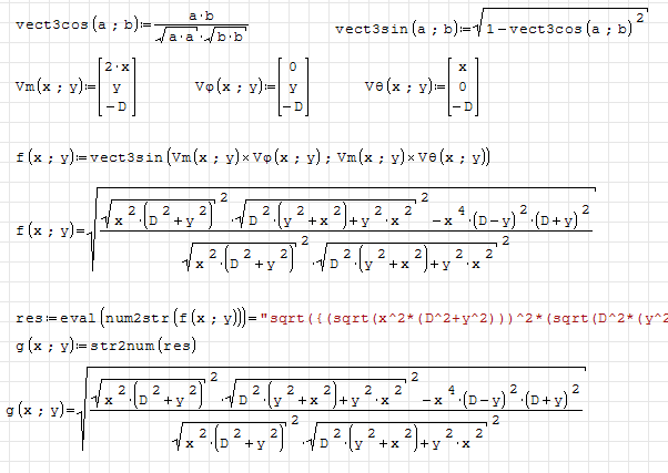

#7 Опубликовано: 03.05.2017 16:57:46
This works.
testassign_Kr.sm (17,97 КиБ) скачан 1145 раз(а).

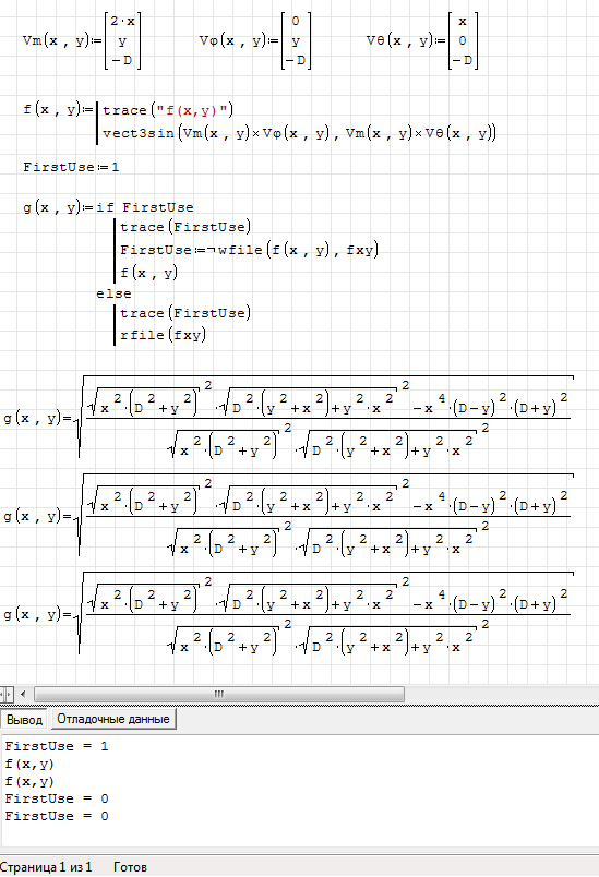

Thanks to Martin and Viacheslav for working solutions!
As I understood, there is no regular way in SMath to access already existing result of symbolic evaluation. The solutions are tricks to export the result to string/file and to import it back.
There is no trick spool to file the immediate maple,
no more trick spool back wherever you want.
Maple series.sm (23,83 КиБ) скачан 1205 раз(а).

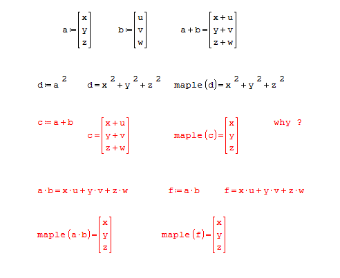

#19 Опубликовано: 06.05.2017 04:20:38
I might be wrong here, but I think the question is about something like this regarding maple.
If you can not reproduce this, there might be something wrong with my SMath.
Regadrs,
#20 Опубликовано: 06.05.2017 06:32:36
This is bug in maple() function. Not all operations are performed correctly during the conversion.
Davide Carpi 06.05.2017 06:40:00, Radovan Omorjan 06.05.2017 14:24:00
