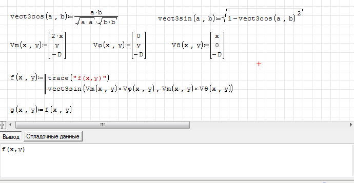

#4 Posted: 5/3/2017 1:30:19 PM
... just assign like this g(x,y):=f(x,y)
shown in red Smath 6179 attached.
Does it work for you ?
Hello Jean,
no, it does not work. It assigns original f(x,y) to g(x,y) and not symbolically evaluated, see blue fields in attachment.
testassign1.sm (18.6 KiB) downloaded 1191 time(s).

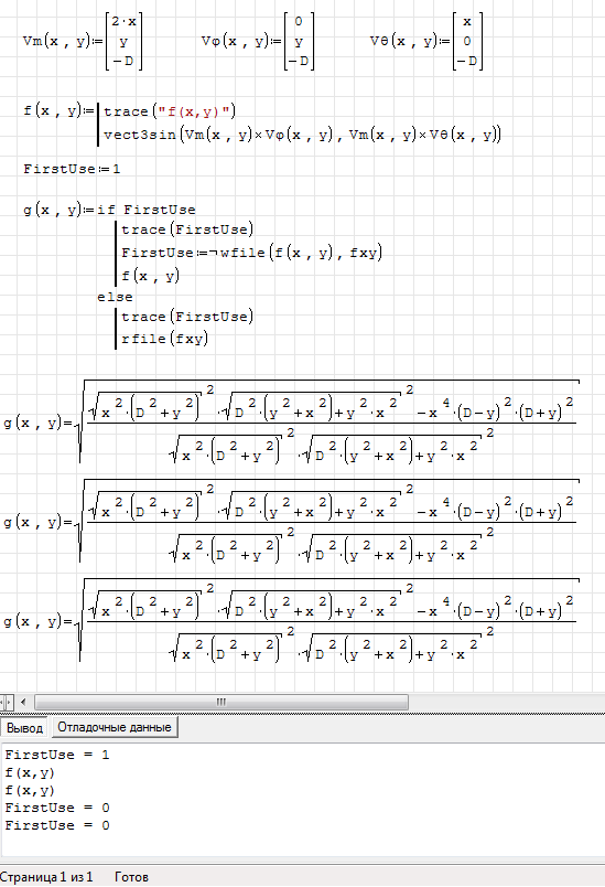

@Viacheslav
Hello Viacheslav, yes it is clear, that not everything can be translated to Maple, but this is also not necessary. The question is, how to use existing symbolic evaluation result.
This is necessary not only for Maple. If intermidiate evaluations are not used, with each new definition ALL previously entered definitions must be again and again evaluated.

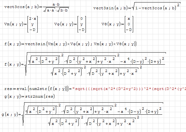

This works.
testassign_Kr.sm (17.97 KiB) downloaded 1145 time(s).

#9 Posted: 5/4/2017 1:34:25 AM
1,558 likes in 1,868 posts.
Something like this?

Thanks to Martin and Viacheslav for working solutions!
As I understood, there is no regular way in SMath to access already existing result of symbolic evaluation. The solutions are tricks to export the result to string/file and to import it back.
