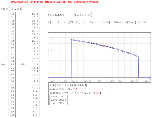

#12 Posted: 2019/2/15 00:41:09
1,078 likes in 1,749 posts.
Hi. You can do some plots too.
RMD CALCULATION.sm (10.79 KiB) downloaded 659 time(s).
#13 Posted: 2019/2/15 01:46:57
RegCurry
RegCurry
0 likes in 57 posts.
Thanks to all. I was able to find some useful stuff from everyone. Here is where I was headed.
RMD CALCULATION.sm (16.94 KiB) downloaded 612 time(s).

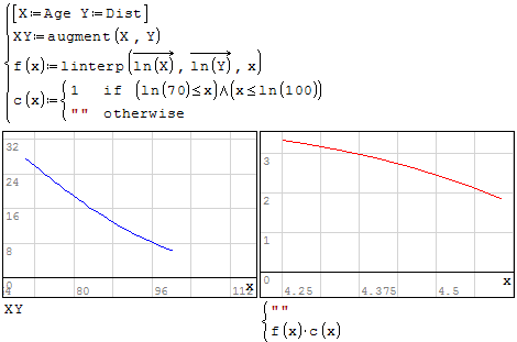

#15 Posted: 2019/2/15 03:51:44
Just a note.
Pay attention to the plot by Alvaro. He uses often neded lele() function (Custom functions plugin) for checking if the value is in a range: Xmin<=x<=Xmax
frapuano 2019/2/15 05:52:00

#18 Posted: 2019/2/15 22:48:25
Is this XY plot new?I find it really helpful.
Not new, just from applied Smath features as in older SS 6179.
