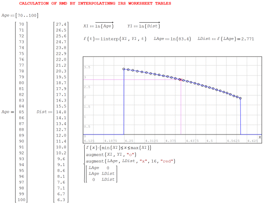

Some thing work like Mathcad and some don't.I need help with the correct syntax for the interpolation function linterp.
Read carefully: linterp, cinterp are 1/1 Mathcad
Smath ainterp has special virtues not found in Mathcad.
Smath linterp, cinterp, ainterp are 1/1 Mathcad as interpolation.
but are 0/1 as scalar functions. In many instances, it is possible
to recast the problem in the form of infinitesimal analysis.
I found no way to render a_c_l interp scalar Mathcad style.
Though, I have the Mathcad code. Don't confuse yourself, a_c_l_interp
they plot on the canvas, i.e: they plot scalar.
scalar is a kernel internal vanishing iterator
Next question: please attach the Smath document.
#7 Опубликовано: 14.02.2019 21:53:35
Oops I meant this way to no success.
Sorry, I downloaded the other one.
Either blue/red will each have an extraordinary good model fit,
for further processing [deriv, int].

RMD CALCULATION (J).sm (18,81 КиБ) скачан 1233 раз(а).
#9 Опубликовано: 14.02.2019 23:51:13
... a bit .
RMD CALCULATION (J).sm (26,09 КиБ) скачан 1243 раз(а).

... interesting stuff .
Interpolate [Linterp, Spline2D].sm (118,34 КиБ) скачан 1076 раз(а).

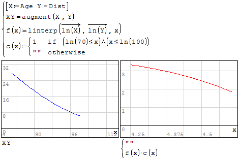

Hi. You can do some plots too.
RMD CALCULATION.sm (10,79 КиБ) скачан 1263 раз(а).

Thanks to all. I was able to find some useful stuff from everyone. Here is where I was headed.
RMD CALCULATION.sm (16,94 КиБ) скачан 1177 раз(а).

Hello Reg ... answered in blue
RMD CALCULATION (J in_blue)-1.sm (24,61 КиБ) скачан 1196 раз(а).

... more in there for publishing.
Little Smath doing so much, so nice !
RMD CALCULATION (J).sm (35,64 КиБ) скачан 1231 раз(а).

Is this XY plot new? I find it really helpful.
RMD CALCULATION.sm (18,33 КиБ) скачан 1186 раз(а).
#18 Опубликовано: 15.02.2019 22:48:25
Is this XY plot new?I find it really helpful.
Not new, just from applied Smath features as in older SS 6179.
