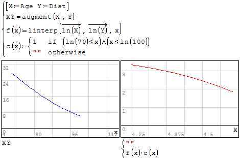

RegCurry

Hi. You can do some plots too.
RMD CALCULATION.sm (10.79 KiB) downloaded 1297 time(s).

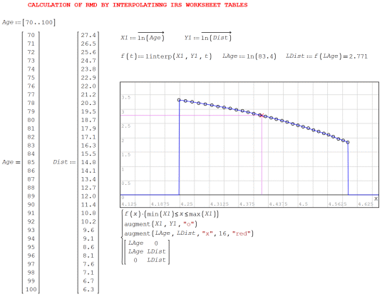

Thanks to all. I was able to find some useful stuff from everyone. Here is where I was headed.
RMD CALCULATION.sm (16.94 KiB) downloaded 1214 time(s).

Pay attention to the plot by Alvaro. He uses often neded lele() function (Custom functions plugin) for checking if the value is in a range: Xmin<=x<=Xmax

Is this XY plot new? I find it really helpful.
RMD CALCULATION.sm (18.33 KiB) downloaded 1220 time(s).

Is this XY plot new?I find it really helpful.
Not new, just from applied Smath features as in older SS 6179.
