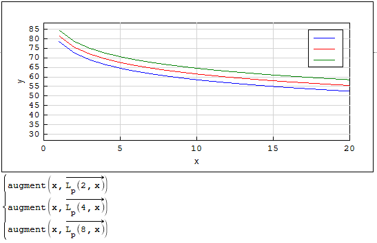

I think I need a program loop to get the graph to show up correctly. Suggestions?

Strict math seems correct to me; let's compare the values for different directivity factors at ssame distance.
we have:
log(a/b)=log(a)-log(b)
to simplify things we can get rid of the absolute value; in your example all numbers are above 1, plus logarithms' arguments are <= 8 in numerator and >= 12 in denominator (4*pi*distance_greater_than_1), thus:
|10*log10(a/b)| = 10*(log10(b)-log10(a)) = 10*(log10(f(x))-log10(Q)) = 10*log10(f(x))-10*log10(Q)
at same distance, log10(f(x)) is the same for every directivity factor Q
10*log10(f(x))-10*log10(Q) = const-10*log10(Q)
10*log10(2)=3, 10*log10(4)=6, 10*log10(8)=9 (approx)
Lp(Q,x)=Lw(Q,1.5)-|10*log10(a/b)|=Lw(Q,1.5)-const+10*log10(Q)
Lw(Q,1.5) loses -3dB when you double Q, but at the same time the absolute value term adds +3B -> so why values are so close (and functions overlapped in the plot)
In fact, if you go further, you can do the same for Lw:
Lw(Q,dist) = Ltot+|10*log10(Q/f(dist))| = Ltot+10*log10(f(dist))-10*log10(Q) = const2-10*log10(Q)
Lp(Q,x) = Lw(Q,1.5)-const1+10*log10(Q) = const2-10*log10(Q)-const1+10*log10(Q) = const2-const1 = constant
and decimal shown in the workshet are only because different decimal places shown in the results

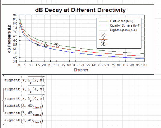

OK, here I am as I had done most of the items that Davide and Jean added. Now I would like to add a "dot" or a vertical line where the dB.final is. Please use this sheet
Quick Sound Loss.smz (135.1 KiB) downloaded 1056 time(s).
Jean, I did not see where you used a spline
All should I be using "cinterp" to place the "dot?
#9 Posted: 2018/4/10 19:30:35
CBG
CBG
78 likes in 312 posts.
Something like this?
Quick Sound Loss - rev.1.sm (134.93 KiB) downloaded 1008 time(s).

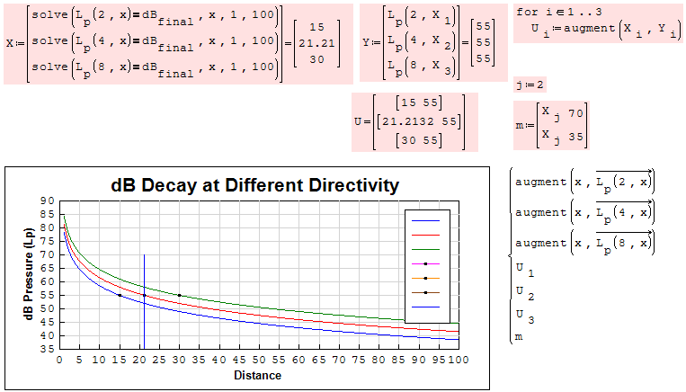

#10 Posted: 2018/4/10 19:43:06
1. spline is for line style ... line/spline.
2. what that gyzma #,#,#,,,does in maths ?
3. X_Y plot does not support " in your plot suggestion
4. X_Y is for final/final/final ... project
once done, if you rework something above=> it will freak the plot
X_Y plot has slightly pregnant memory. Doctored in red .
Quick Sound Loss (3).sm (140.83 KiB) downloaded 1243 time(s).

#12 Posted: 2018/4/10 21:18:04
CBG
CBG
Ok, This is the right file
Quick Sound Loss (1)_r1.sm (140.03 KiB) downloaded 1291 time(s).

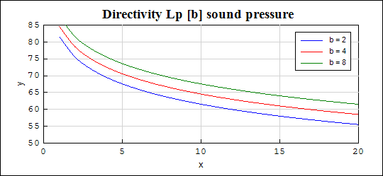

#18 Posted: 2018/4/13 11:38:07
Found the issue.I'll post revamp file.Still having issues in that X-Y plot Labels for the legend *zap*
Clik on "list", edit "series name".

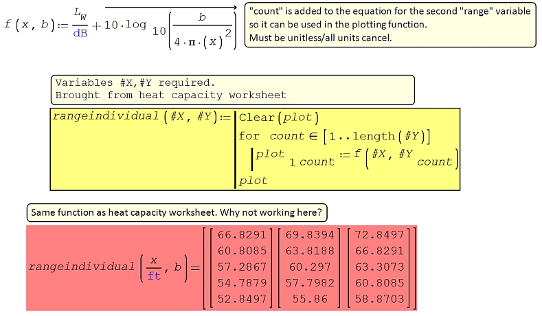

Revisiting this old calc with SMath newer features and some function definitions.
  1. No longer works if I redefine the logarithmic sum with vectorize
  2. I cannot get the "heat capacity function" to work for ploting
Sound Loss (Quick).sm (476.36 KiB) downloaded 1156 time(s).
Thanks for the help.
#20 Posted: 2021/1/25 21:34:45
1,123 likes in 1,795 posts.
Hi. Some notes, but I'm not sure if this solve all of the issues:
1. Use count inside rangeindividual, but not outside. You use it in f(x, b ), and guess that could be problematic.
2. After that, you divide x by 'm in f and x by feet in rangeindividual, choose only one.
3. Maybe here don't affect, but if rangeindividual have not f(#,#) as parameter, define f before rangeindividual, you know, just in case.
ElSid 2021/1/25 21:53:00
