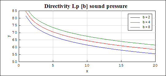

#1 Posted: 4/10/2018 11:40:58 AM
I think I need a program loop to get the graph to show up correctly. Suggestions?
Quick Sound Loss.smz (132.15 KiB) downloaded 1241 time(s).

#5 Posted: 4/10/2018 2:50:48 PM
What might be wrong...
You have sound pressure measured by the vendor -> You have to calculate the power level for the distance and directivity condition of the vendor
Then you have the sound power level of your source... it's a constant! Use this value to estimate the sound power at various distances for various directivity conditions!
Quick Sound Loss - rev.1.sm (134.93 KiB) downloaded 1231 time(s).

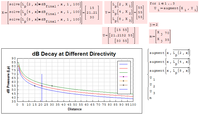

#8 Posted: 4/10/2018 5:41:23 PM
Funny ...
OK, here I am as I had done most of the items that Davide and Jean added. Now I would like to add a "dot" or a vertical line where the dB.final is. Please use this sheet
Quick Sound Loss.smz (135.1 KiB) downloaded 1255 time(s).
Jean, I did not see where you used a spline
All should I be using "cinterp" to place the "dot?

#10 Posted: 4/10/2018 7:43:06 PM
WroteJean, I did not see where you used a spline
1. spline is for line style ... line/spline.
2. what that gyzma #,#,#,,,does in maths ?
3. X_Y plot does not support " in your plot suggestion
4. X_Y is for final/final/final ... project
once done, if you rework something above=> it will freak the plot
X_Y plot has slightly pregnant memory. Doctored in red .
Quick Sound Loss (3).sm (140.83 KiB) downloaded 1443 time(s).

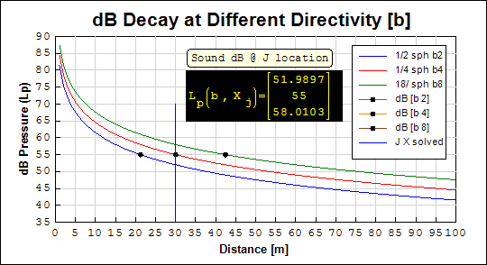

#15 Posted: 4/13/2018 2:23:09 AM

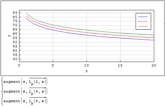

Well, Here we go again ...
I found a quirk. Depending on values dB initial values, neither solve nor FindRoot is functional. I was plugging in values by hand without seeing an issue. I tried a "higher" dB set of values (86 vs 75) for equipment and the calculation *zap*
Quick Sound Loss.smz (168.74 KiB) downloaded 1285 time(s).
Also, the X-Y plot legend information *ZAP*

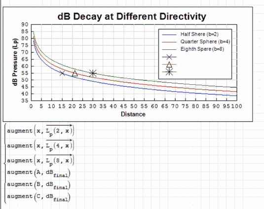

#17 Posted: 4/13/2018 10:33:23 AM
Found the issue(s). See revamped file. Still having issues in that X-Y plot Labels for the legend *zap*Quick Sound Loss.smz (142.28 KiB) downloaded 2037 time(s).
Edit: Two bugs
There is additional documentation and function definition updates. Sanity check the graph x scale (adjusted for feet since I'm in the US). Should be good now
Edit: Two bugs
- X-Y Plot. If functions crash, *Zap* to the legend titles. All other titles OK. Legend is empty due to laziness after last 5 crashes
- solve(4) did not like trying to cancel units in the denominator of the final function (#dist). As I was adding units to x:0-100 FT and dividing the units meters in the function, the function crashed in the solve block (Just the function, with all values plugged in except for x = vector, so it's a solve(4) issue).
#18 Posted: 4/13/2018 11:38:07 AM
WroteFound the issue.I'll post revamp file.Still having issues in that X-Y plot Labels for the legend *zap*
Clik on "list", edit "series name".

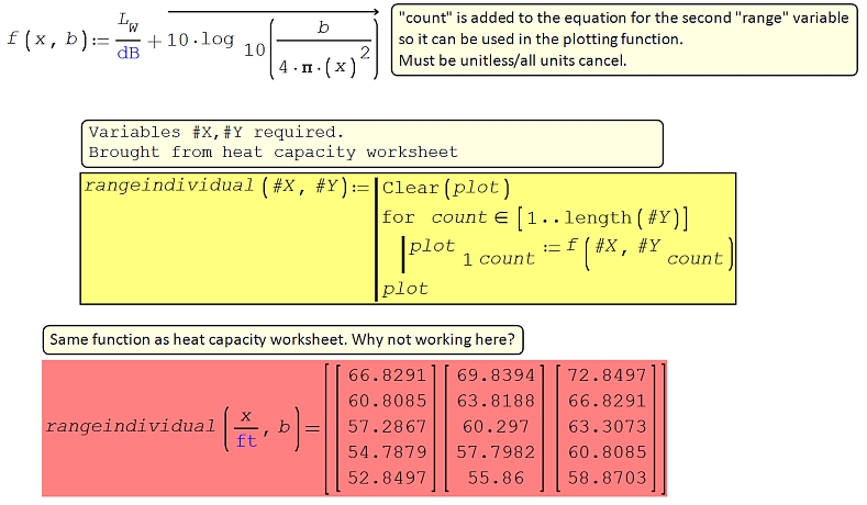

#19 Posted: 1/25/2021 8:16:25 PM
Revisiting this old calc with SMath newer features and some function definitions.
Sound Loss (Quick).sm (476.36 KiB) downloaded 1325 time(s).
Thanks for the help.
- No longer works if I redefine the logarithmic sum with vectorize
- I cannot get the "heat capacity function" to work for ploting
#20 Posted: 1/25/2021 9:34:45 PM
Hi. Some notes, but I'm not sure if this solve all of the issues:
1. Use count inside rangeindividual, but not outside. You use it in f(x, b ), and guess that could be problematic.
2. After that, you divide x by 'm in f and x by feet in rangeindividual, choose only one.
3. Maybe here don't affect, but if rangeindividual have not f(#,#) as parameter, define f before rangeindividual, you know, just in case.
