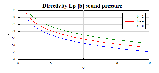

I think I need a program loop to get the graph to show up correctly. Suggestions?
Quick Sound Loss.smz (132,15 КиБ) скачан 1241 раз(а).
#2 Опубликовано: 10.04.2018 11:56:29
I think I need a program loop to get the graph to show up correctly.Suggestions?
"Why does log10 look different ?"
because you have two different formulas, thus two different results

Jean,
The second equation is off/not evaluated. Graphically log to base x and log10 display differently. Question is about graph though

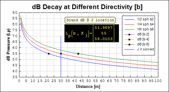

OK, here I am as I had done most of the items that Davide and Jean added. Now I would like to add a "dot" or a vertical line where the dB.final is. Please use this sheet
Quick Sound Loss.smz (135,1 КиБ) скачан 1255 раз(а).
Jean, I did not see where you used a spline
All should I be using "cinterp" to place the "dot?
#9 Опубликовано: 10.04.2018 19:30:35
CBG
CBG
Something like this?
Quick Sound Loss - rev.1.sm (134,93 КиБ) скачан 1176 раз(а).

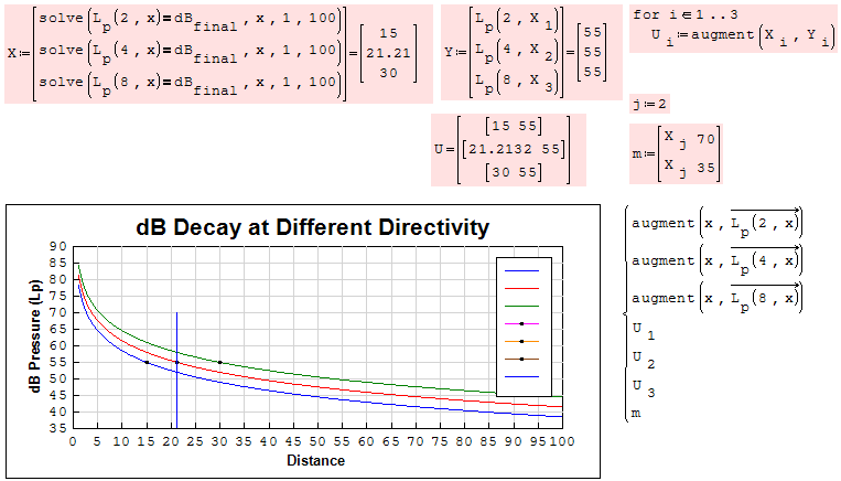

#10 Опубликовано: 10.04.2018 19:43:06
1. spline is for line style ... line/spline.
2. what that gyzma #,#,#,,,does in maths ?
3. X_Y plot does not support " in your plot suggestion
4. X_Y is for final/final/final ... project
once done, if you rework something above=> it will freak the plot
X_Y plot has slightly pregnant memory. Doctored in red .
Quick Sound Loss (3).sm (140,83 КиБ) скачан 1443 раз(а).

Ok, This is the right file
Quick Sound Loss (1)_r1.sm (140,03 КиБ) скачан 1480 раз(а).

#13 Опубликовано: 10.04.2018 22:38:04
Jean,
When I double click the graph on your latest file, my computer locks up.I'm on version 0.99.6671.
My 6179 opens your 6671 ... your 6671 freezes opening 6179
Is it a bug ?
BTW, attach an image of the polynomials that fail [as you reported].

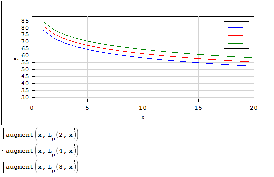

I found a quirk. Depending on values dB initial values, neither solve nor FindRoot is functional. I was plugging in values by hand without seeing an issue. I tried a "higher" dB set of values (86 vs 75) for equipment and the calculation *zap*
Quick Sound Loss.smz (168,74 КиБ) скачан 1285 раз(а).
Also, the X-Y plot legend information *ZAP*
#16 Опубликовано: 13.04.2018 08:55:34
Well, Here we go again ...
I found a quirk.Depending on values dB initial values, neither solve nor FindRoot is functional.I was plugging in values by hand without seeing an issue.I tried a "higher" dB set of values (86 vs 75) for equipment and the calculation *zap*
That one was Doctored and you don't use the Doctored version.
Explained before, if above X_Y something is Doctored, zap.
Quick Sound Loss (4) Doctored 20180413.sm (167,01 КиБ) скачан 1220 раз(а).

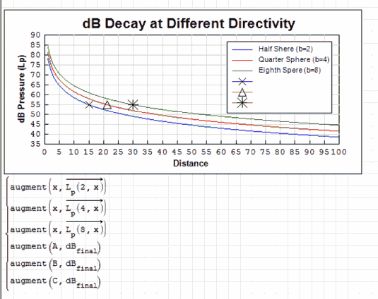

Found the issue(s). See revamped file. Still having issues in that X-Y plot Labels for the legend *zap*Quick Sound Loss.smz (142,28 КиБ) скачан 2037 раз(а).
Edit: Two bugs
  1. X-Y Plot. If functions crash, *Zap* to the legend titles. All other titles OK. Legend is empty due to laziness after last 5 crashes
  2. solve(4) did not like trying to cancel units in the denominator of the final function (#dist). As I was adding units to x:0-100 FT and dividing the units meters in the function, the function crashed in the solve block (Just the function, with all values plugged in except for x = vector, so it's a solve(4) issue).
This is one of those sheets where UNITS are huge! The equations are all based off of SI/metric references. Major issue
There is additional documentation and function definition updates. Sanity check the graph x scale (adjusted for feet since I'm in the US). Should be good now
#18 Опубликовано: 13.04.2018 11:38:07
Found the issue.I'll post revamp file.Still having issues in that X-Y plot Labels for the legend *zap*
Clik on "list", edit "series name".

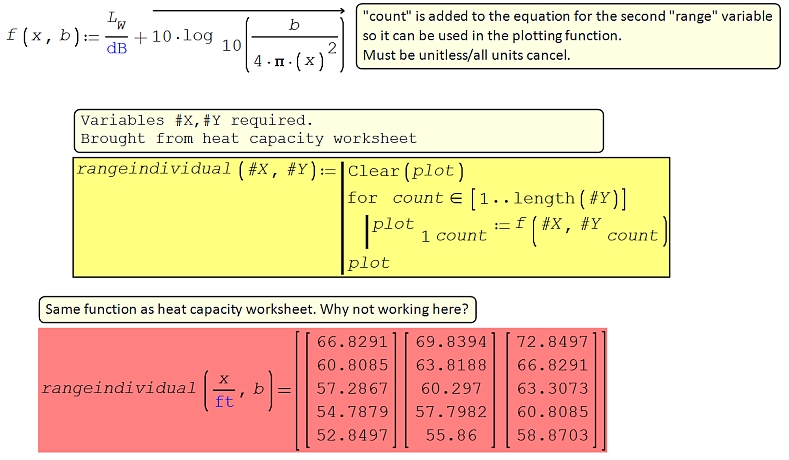

Revisiting this old calc with SMath newer features and some function definitions.
  1. No longer works if I redefine the logarithmic sum with vectorize
  2. I cannot get the "heat capacity function" to work for ploting
Sound Loss (Quick).sm (476,36 КиБ) скачан 1325 раз(а).
Thanks for the help.
#20 Опубликовано: 25.01.2021 21:34:45
Hi. Some notes, but I'm not sure if this solve all of the issues:
1. Use count inside rangeindividual, but not outside. You use it in f(x, b ), and guess that could be problematic.
2. After that, you divide x by 'm in f and x by feet in rangeindividual, choose only one.
3. Maybe here don't affect, but if rangeindividual have not f(#,#) as parameter, define f before rangeindividual, you know, just in case.
