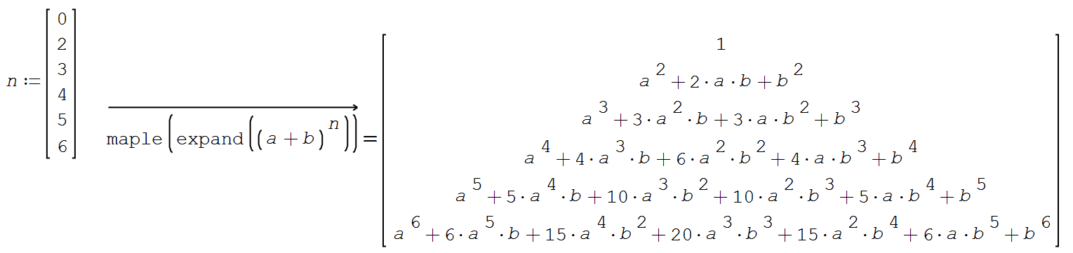

Can I do this with SMath/
See please Mathcad
#2 Posted: 2023/6/19 11:59:41
Valery Ochkov
Valery Ochkov
66 likes in 690 posts.
I know how create the first part. Has SMath the expand operator or some one?

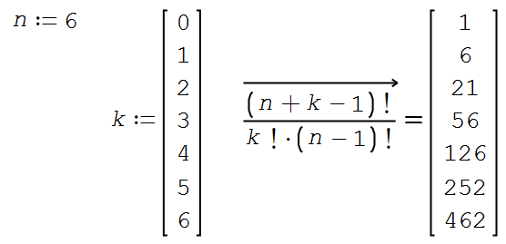

Can I have the combin from Maple?
#7 Posted: 2023/6/19 12:40:56
Your two demands honored.
#8 Posted: 2023/6/19 12:55:47
Valery Ochkov
Valery Ochkov

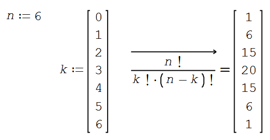

Pascal triangle
Thiago Pereira 2024/6/27 01:59:00

#10 Posted: 2023/6/19 18:23:49
Pascal triangle
Maths Pascal Triangle QUICK.sm (48.15 KiB) downloaded 1113 time(s).

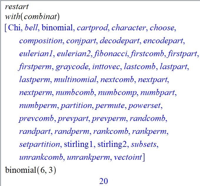

#12 Posted: 2023/6/21 05:36:00
1,554 likes in 1,864 posts.
Оно работает, только нужно в папке с плагином дополнить with.inc файл. Там содержится список пакетов, которые подключаются при вызове функции maple(). Заранее неизвестно что понадобится пользователю, поэтому список подключаемых пакетов ограничен и настройка их списка осуществляется внешним файлом.

#17 Posted: 2023/6/21 16:06:18
Usually, when working with Maple, you need to specify the name of the used package using the with() keyword.
To simplify the work with the maple() function, I make an indication of the packages used implicitly. When calling a function, a certain set of packages is always added.
These packages are listed as commands in the with.inc file. This text file is located in the Maple Tools plugin folder. In one of the subfolders (it seems bin).
You need to add the following text to the contents of the file:
with(combinat):
After adding this line, it will be possible to call functions from this package.

#19 Posted: 2023/6/22 05:25:34
Is that custom set of packages somehow stored in the document metadata?
No. Indeed, this will work only locally.
The function can be called like this
#20 Posted: 2023/6/22 10:49:51
How do you add this to the plugin? Could you show this ?
Does binomial work on your system ?
