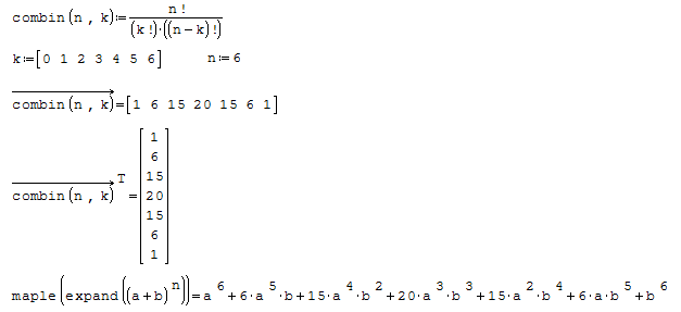

Can I do this with SMath/
See please Mathcad
#2 Опубликовано: 19.06.2023 11:59:41
Valery Ochkov
Valery Ochkov
67 сообщений из 713 понравились пользователям.
I know how create the first part. Has SMath the expand operator or some one?

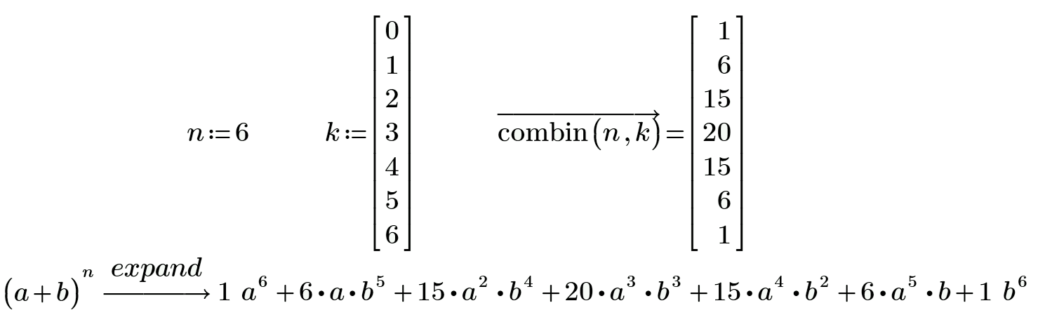

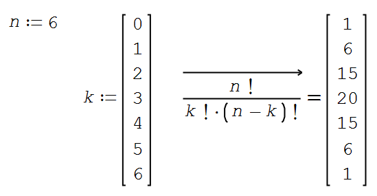

Can I do this with SMath ?
Smath offers more.
Maths Combine.sm (76,61 КиБ) скачан 1346 раз(а).
Smath offers more.
Thanks!

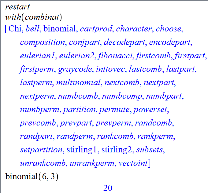

Can I have the combin from Maple?

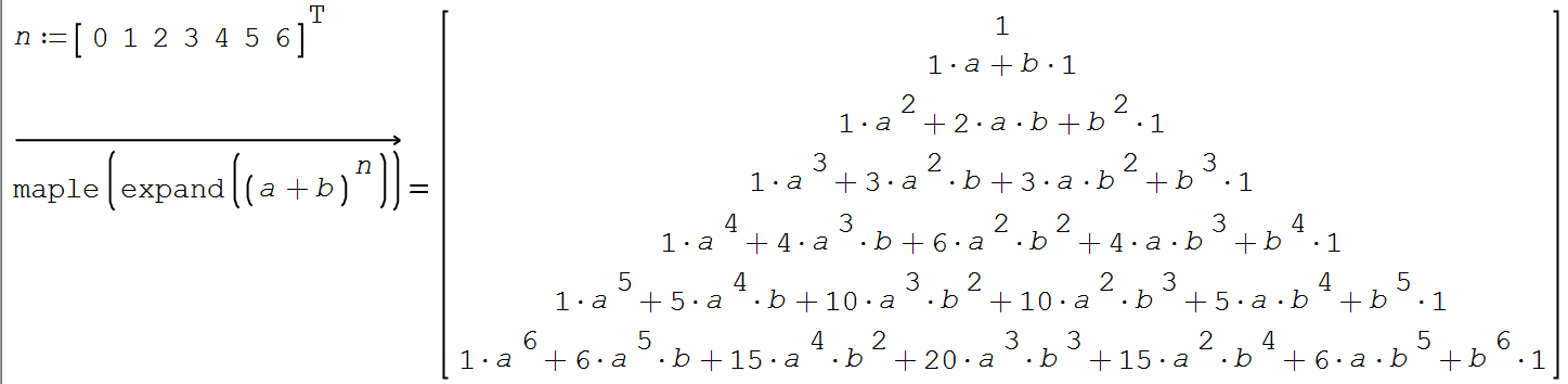

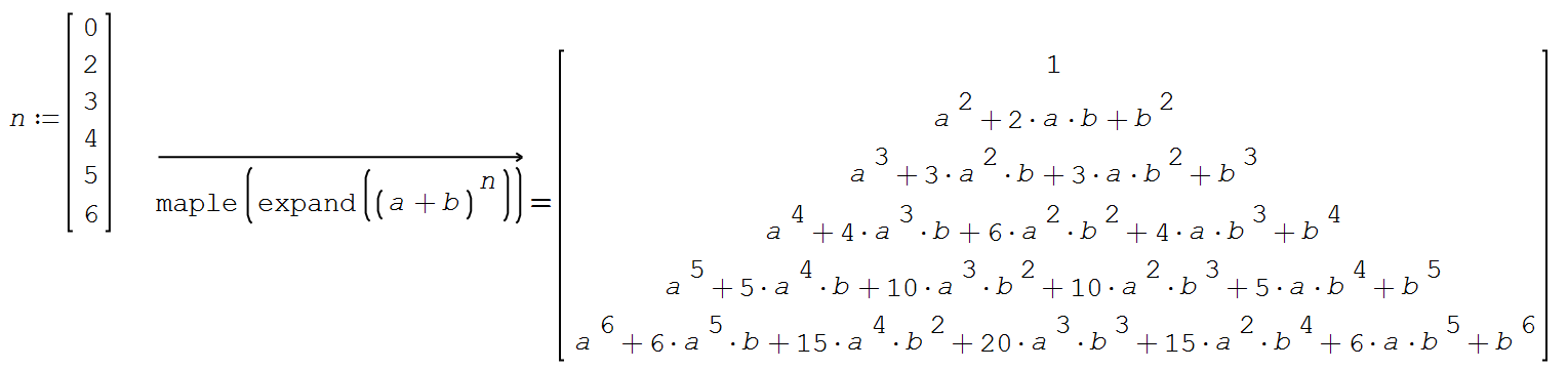

Your two demands honored.
#8 Опубликовано: 19.06.2023 12:55:47
Valery Ochkov
Valery Ochkov
Pascal triangle

#12 Опубликовано: 21.06.2023 05:36:00
Оно работает, только нужно в папке с плагином дополнить with.inc файл. Там содержится список пакетов, которые подключаются при вызове функции maple(). Заранее неизвестно что понадобится пользователю, поэтому список подключаемых пакетов ограничен и настройка их списка осуществляется внешним файлом.

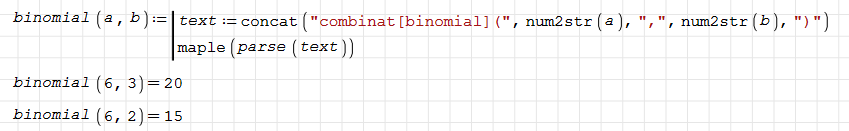

Usually, when working with Maple, you need to specify the name of the used package using the with() keyword.
To simplify the work with the maple() function, I make an indication of the packages used implicitly. When calling a function, a certain set of packages is always added.
These packages are listed as commands in the with.inc file. This text file is located in the Maple Tools plugin folder. In one of the subfolders (it seems bin).
You need to add the following text to the contents of the file:
with(combinat):
After adding this line, it will be possible to call functions from this package.
#18 Опубликовано: 21.06.2023 19:05:18

Is that custom set of packages somehow stored in the document metadata? Otherwise the document would not run on other installations of SMath, even if the maple plugin is there.
#19 Опубликовано: 22.06.2023 05:25:34
No. Indeed, this will work only locally.
The function can be called like this
#20 Опубликовано: 22.06.2023 10:49:51
How do you add this to the plugin? Could you show this ?
Does binomial work on your system ?
Maths Pascal Auto Companion QUICK.sm (4,89 КиБ) скачан 1301 раз(а).
