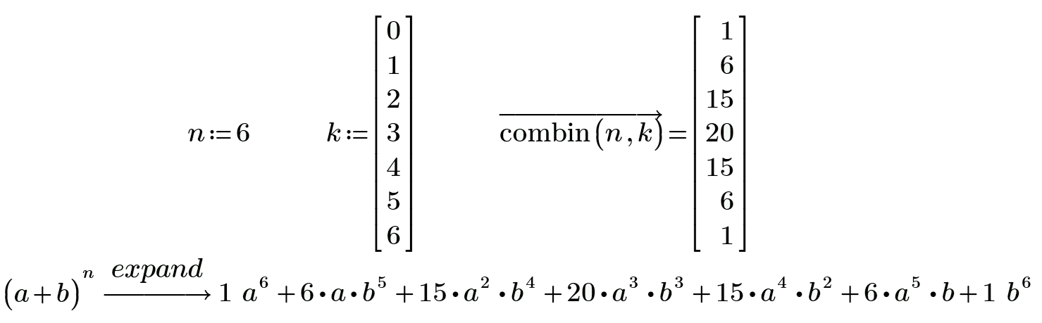

Can I do this with SMath/
See please Mathcad
#2 Posted: 6/19/2023 11:59:41 AM

I know how create the first part. Has SMath the expand operator or some one?

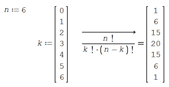

#3 Posted: 6/19/2023 12:21:12 PM
Can I do this with SMath ?
Smath offers more.
Maths Combine.sm (76.61 KiB) downloaded 1346 time(s).

Thanks!
But this

Can I have the combin from Maple?

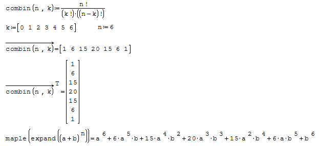

#7 Posted: 6/19/2023 12:40:56 PM
Your two demands honored.

But this Maple-function not work in SMath?

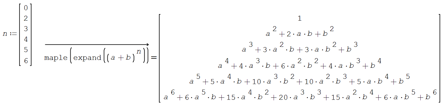

#10 Posted: 6/19/2023 6:23:49 PM
Pascal triangle
Maths Pascal Triangle QUICK.sm (48.15 KiB) downloaded 1295 time(s).

Оно работает, только нужно в папке с плагином дополнить with.inc файл. Там содержится список пакетов, которые подключаются при вызове функции maple(). Заранее неизвестно что понадобится пользователю, поэтому список подключаемых пакетов ограничен и настройка их списка осуществляется внешним файлом.

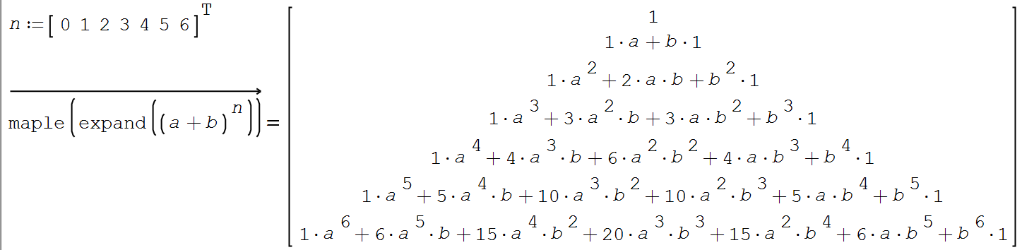

#14 Posted: 6/21/2023 11:41:59 AM
Pascal triangle
Fully automated.
Maths Pascal Auto Companion Copy.sm (36.62 KiB) downloaded 1279 time(s).

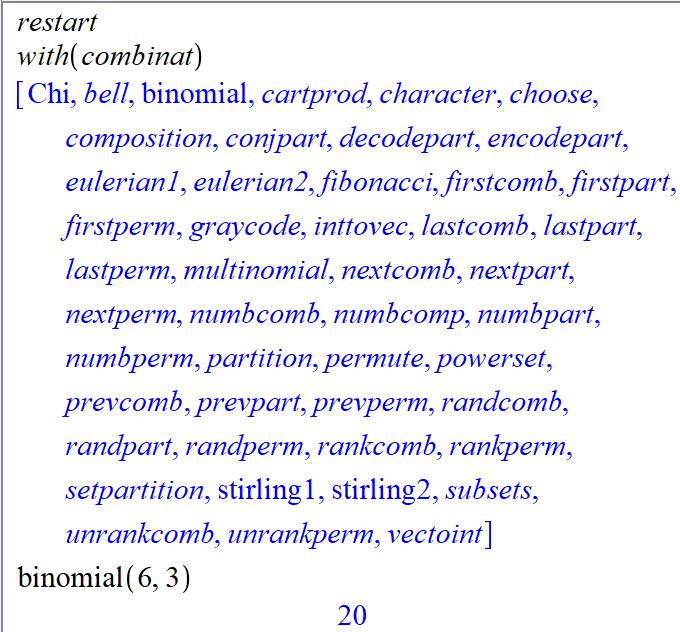

#17 Posted: 6/21/2023 4:06:18 PM
1,558 likes in 1,868 posts.
Usually, when working with Maple, you need to specify the name of the used package using the with() keyword.
To simplify the work with the maple() function, I make an indication of the packages used implicitly. When calling a function, a certain set of packages is always added.
These packages are listed as commands in the with.inc file. This text file is located in the Maple Tools plugin folder. In one of the subfolders (it seems bin).
You need to add the following text to the contents of the file:
with(combinat):
After adding this line, it will be possible to call functions from this package.

Is that custom set of packages somehow stored in the document metadata? Otherwise the document would not run on other installations of SMath, even if the maple plugin is there.
No. Indeed, this will work only locally.
The function can be called like this
#20 Posted: 6/22/2023 10:49:51 AM
How do you add this to the plugin? Could you show this ?
Does binomial work on your system ?
Maths Pascal Auto Companion QUICK.sm (4.89 KiB) downloaded 1301 time(s).
