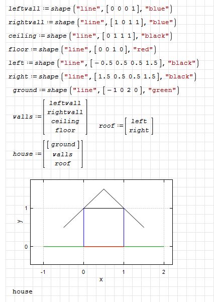

#5 Posted: 2024/12/4 20:07:59
1,554 likes in 1,864 posts.
An example of using a set of objects. As you can see, when used this way, the nested matrices are not so noticeable.
Oscar Campo 2024/12/4 21:34:00, francesco rapuano 2024/12/4 22:57:00, Alvaro 2024/12/5 21:06:00
#6 Posted: 2024/12/6 17:38:27
The same for polyline.
xyplot-polyline-house.sm (8.37 KiB) downloaded 1409 time(s).
xyplot-shapes-house.sm (11.72 KiB) downloaded 1469 time(s).
francesco rapuano 2024/12/6 19:45:00

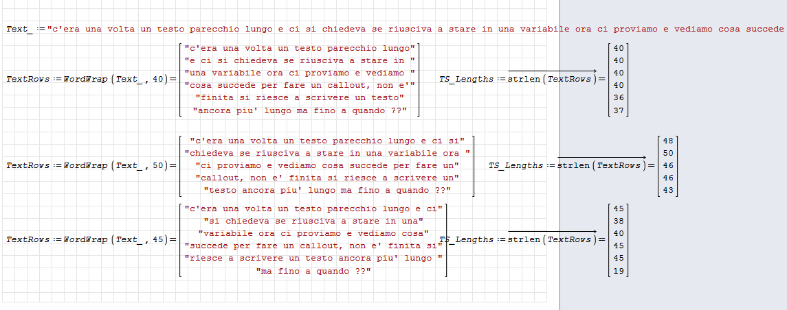

#12 Posted: 2024/12/15 09:38:24
Oscar Campo
Oscar Campo
135 likes in 309 posts.
Uni , I don't need an exact formula even if there is a rough extimation in excess it is ok .
Make me worry that it is not available for each font and specified size something that gives the max space as horizontal and vertical dimensions that any character that belongs to it can use , so that a rough estimate of the space occupied by a text string is possible.
Don't know if something empirical can be understood/developed with tons of trial and errors.
Moreover if I understand correctly there will be no possibility in the future to address the issue of the zooming of the text labels in a XY plot drawing for compatibility reasons.
Thanks a lot for your feedback and take care, Best regards,
Franco
I think you proposes is the way in which text is rendered on CAD software. So the text is converted to lines and splines and displayed on screen. In this way, this post is the most similar to that procedure.
Alvaro 2024/12/15 10:46:00, francesco rapuano 2024/12/15 18:02:00

#14 Posted: 2024/12/16 06:38:10
Oscar Campo
Oscar Campo
Yes Oscar, I was thinking about what was shown in the Alvaro's post but now in this last post of him here (Alvaro is really a force of nature ) there is another approach with some monospaced bitmap font scalable .
I need to study it in detail because due to my ignorance I do not undertand the whole method ( even if looks to me that he transit trough the creation of an image of what need to be typed on the plot and images are zoomable in XY Plot so this is a workaround to the zooming problem that we are trying to address) .
My original desire was to create callauts just with one font to semplify the project and I like a lot the Arial one ..but I don't know how to create a Arial Monospaced font with the Alvaro's method so I will try to use the Franklin font that is however a clean and elegant one and see if I am able to merge it in the other funtions that I have tried to develop by myself.
Franco
You need to create a BMP with the characters of your font. Look that this BMP must be 225x121 pixels (for compatibility with Alvaro's script)
This is the bmp for Arial font (please right click on it and "save as..." ) :
And this is the SMath script for read the bmp and convert it on matrix form for use with the Alvaro's script
Arial BMP.sm (1.03 MiB) downloaded 1507 time(s).
Best wishes,
Oscar
francesco rapuano 2024/12/16 12:41:00, Alvaro 2024/12/16 21:38:00

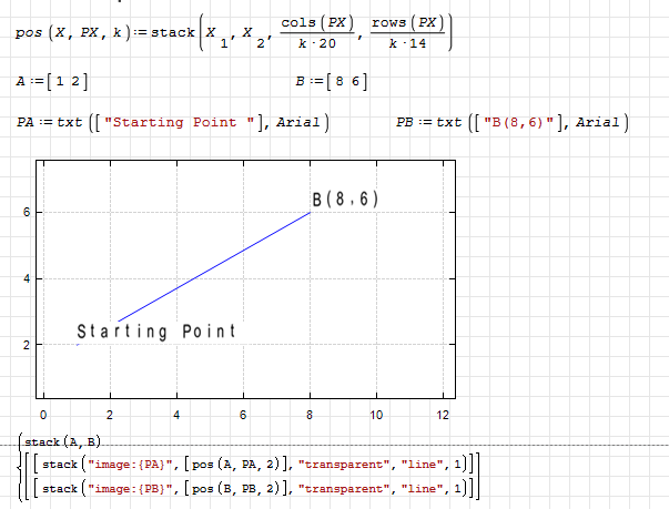

#17 Posted: 2024/12/29 01:56:00
francesco rapuano
francesco rapuano
15 likes in 38 posts.
Hi Alvaro,Oscar,
sorry for disturbing you but I would like to know if it is possible to draw the string of BMP text on the XY Plot Plugin but with a transparent background, as you can imagine going ahead with the project of drawing Callouts rise the problem to have a text that allows to see the background graph or whatsever is in the background otherwise I guess that we lose clarity in what we highlight through the Callout.
I know that BMP doesn't allow a transparent channel ( or not ? ) we should move probably to a PNG format and probably I would be able to save in PNG with a transparent background the font matrix that now are in BNP format but the possibility of the XY Plot Plugin will allow to draw/show images/picture in PNG format with transparency ?
I hope I was able to describe the problem decently.
Thanks in advance for your help and best regards.
Franco
P.S:Herewith we see that the text "Starting point" hide a little bit the starting of the line segment , obviously I have inverted the display order sequence despite the original Alvaro's file to show this.
Ricardo_Herrera 2026/4/25 22:27:40

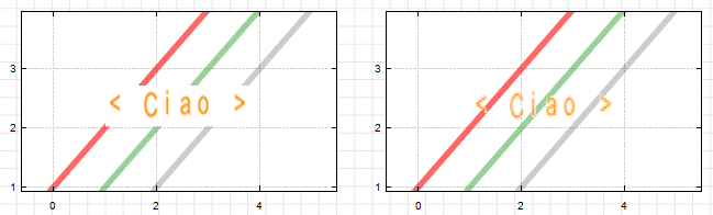

#18 Posted: 2024/12/29 10:41:07
1,123 likes in 1,795 posts.
Hi Franco. At this moment I think the XYPlot plugin supports only one matrix with the grayscale from 0 to 255 or three matrices with the colors [R G B], but not transparencies, to represent images. However, I am not sure and that is something Viacheslav can answer.
Ricardo_Herrera 2026/4/25 22:27:37
#19 Posted: 2025/1/2 18:07:10
Hi. A workaround.
XYPlot - Scalable monospaced bitmapped fonts COLOR.sm (2.17 MiB) downloaded 1598 time(s).
Ricardo_Herrera 2026/4/25 22:27:36, Oscar Campo 2025/1/3 08:08:00, francesco rapuano 2025/1/2 18:39:00
