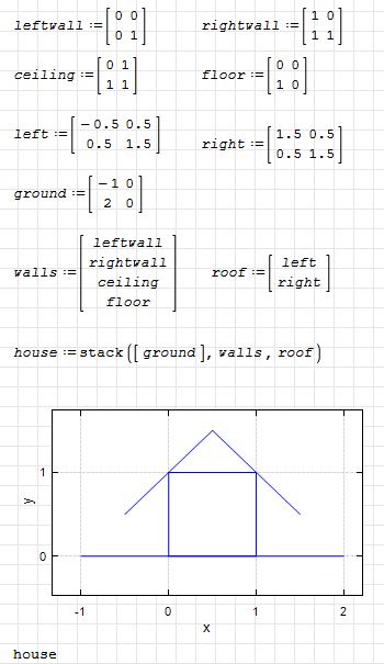

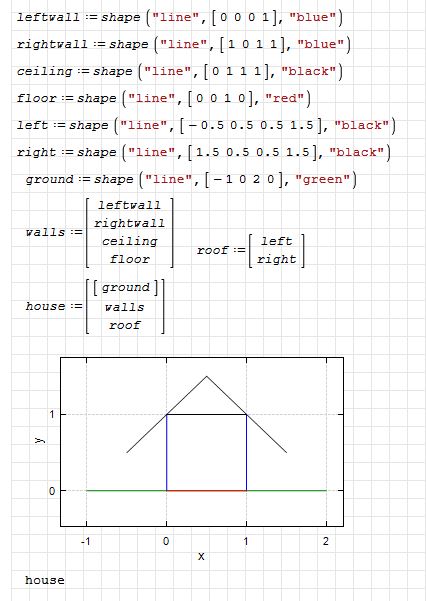

An example of using a set of objects. As you can see, when used this way, the nested matrices are not so noticeable.

The same for polyline.
xyplot-polyline-house.sm (8.37 KiB) downloaded 1621 time(s).
xyplot-shapes-house.sm (11.72 KiB) downloaded 1670 time(s).

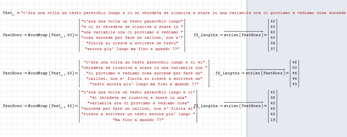

Hi Uni,
I am going ahead with the routine to draw a Callout and I have developed in the meantime a small function for the word wrapping of a long text stringXYPlot Word Wrap Tests.sm (21.4 KiB) downloaded 1650 time(s).
Now I would like to merge this function with the other one that draw the Callout arrow but to accomplish this I need to position vertically the substrings of text that are the output of the WordWrap function; so come out quite naturally the following questions:
1-When you define that the font of a text label is Arial10pt what does it means as a vertical dimension and which is the vertical and horizontal dimension of a letter Arial10pt
2-Which is the relationship - if exists - of the previous vertical dimension with the numbers that I use to specify the position of the label on the xy plane of a plot ( the coordinates where I place the text label) , Is it something with similar units ( which units? )
In the event of having these information probably I'll be able to position the substring of text correctly in the xy plane avoiding their overlapping and moreover I'll be able to evaluate the maximum horizontal length of each substring and define a correct size for a rectangle that will be the border of all the Callout text.
I hope that I was able to explain my concerns and that someone will have suggestions about the points above reported.
Thanks in advance to anyone and best regards

Determining the size of the rectangle in which the text will be inscribed is quite a difficult task, since its size depends not only on the font parameters. For a monospace font, this procedure may be simpler, but not much. I can’t give any formula, since a special function is used to measure the size of the text in c# - MeasureString. Obtaining size data is done dynamically for each specific case when drawing.
The ability to display text was added by analogy with the built-in component and I will not expand this function any further to maintain compatibility. There are already some differences in drawing that I need to fix.

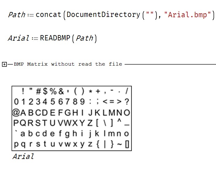

You need to create a BMP with the characters of your font. Look that this BMP must be 225x121 pixels (for compatibility with Alvaro's script)
This is the bmp for Arial font (please right click on it and "save as..." ) :
And this is the SMath script for read the bmp and convert it on matrix form for use with the Alvaro's script
Arial BMP.sm (1.03 MiB) downloaded 1713 time(s).

Indeed, Oscar describes the process accurately. He also produces better images than I did. Excel does not allow saving images directly, and looks like he uses a better intermediate program, I had not paid attention to that.
I store the image in a variable until there is a way to obtain the matrix directly from an embedded image in SMath, avoiding the use of external files.
The picture size is (6*20+1) x (16*14+1) . The plus one line and column is because of the border line of the Excel grid. You can leave it or remove it from the matrix, it has no influence.
Using bitmaps to go from a proportional font to a monospaced one is not my invention, there was a time when programmers did not like to count variable lengths of text and when users got bored of always using the same fonts, so this trick was used. It is actually still in use, I think.
There is a trick in the algorithm: The space character is not in the character list, and any character that is not found is written as a space, the zero character.

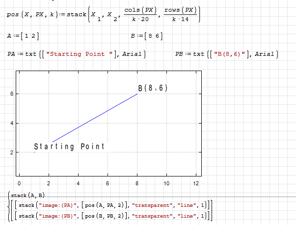

Hi Alvaro,Oscar,
sorry for disturbing you but I would like to know if it is possible to draw the string of BMP text on the XY Plot Plugin but with a transparent background, as you can imagine going ahead with the project of drawing Callouts rise the problem to have a text that allows to see the background graph or whatsever is in the background otherwise I guess that we lose clarity in what we highlight through the Callout.
I know that BMP doesn't allow a transparent channel ( or not ? ) we should move probably to a PNG format and probably I would be able to save in PNG with a transparent background the font matrix that now are in BNP format but the possibility of the XY Plot Plugin will allow to draw/show images/picture in PNG format with transparency ?
I hope I was able to describe the problem decently.
Thanks in advance for your help and best regards.
Franco
P.S:Herewith we see that the text "Starting point" hide a little bit the starting of the line segment , obviously I have inverted the display order sequence despite the original Alvaro's file to show this.

Hi Franco. At this moment I think the XYPlot plugin supports only one matrix with the grayscale from 0 to 255 or three matrices with the colors [R G B], but not transparencies, to represent images. However, I am not sure and that is something Viacheslav can answer.

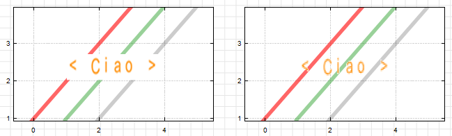

Hi. A workaround.
XYPlot - Scalable monospaced bitmapped fonts COLOR.sm (2.17 MiB) downloaded 1840 time(s).

what can I say , is really exceptional what you have done .... the problem is that to understand your initial work about conversion of text in BMP required to me more that a 3 weeks and dont't know how long it will require to understand this further step of yours.
However at least I learn a lot of things ( better to say I think that I learn ...) in the process and I thank you and Oscar for that .
