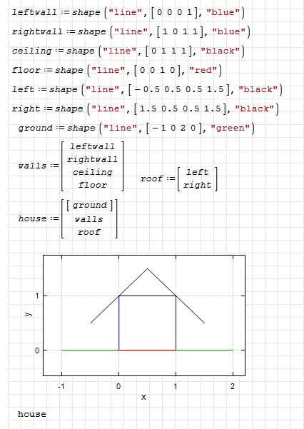

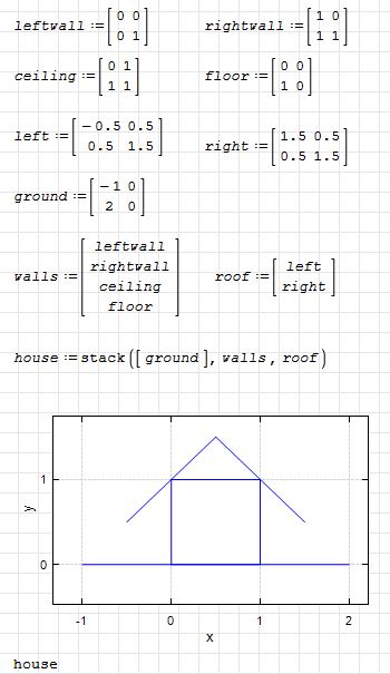

#5 Опубликовано: 04.12.2024 20:07:59
An example of using a set of objects. As you can see, when used this way, the nested matrices are not so noticeable.
Oscar Campo 04.12.2024 21:34:00, francesco rapuano 04.12.2024 22:57:00, Alvaro 05.12.2024 21:06:00
#6 Опубликовано: 06.12.2024 17:38:27
The same for polyline.
xyplot-polyline-house.sm (8,37 КиБ) скачан 1621 раз(а).
xyplot-shapes-house.sm (11,72 КиБ) скачан 1670 раз(а).
francesco rapuano 06.12.2024 19:45:00

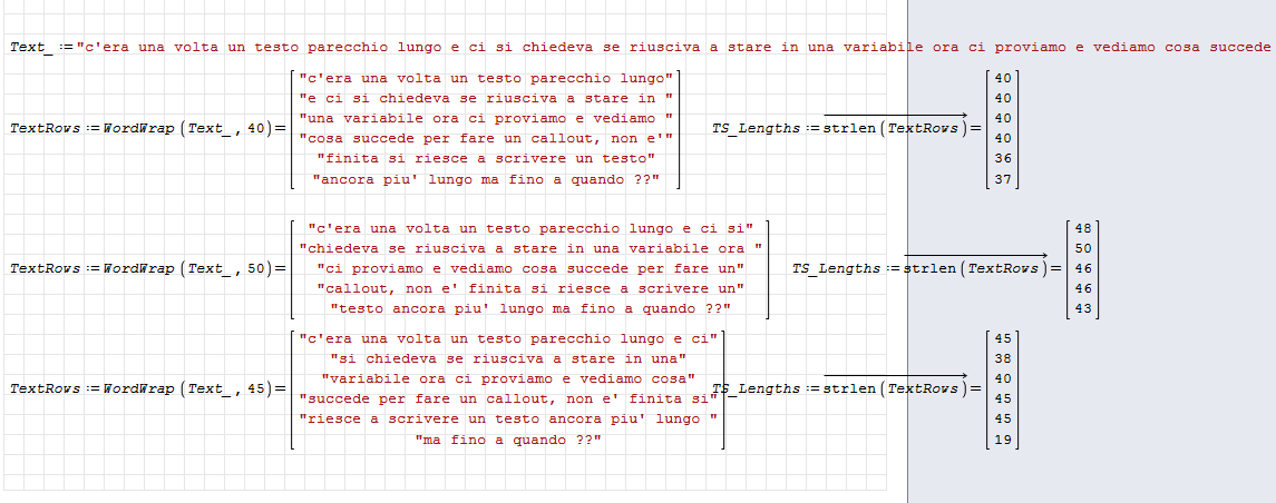

#8 Опубликовано: 14.12.2024 05:38:50
francesco rapuano
francesco rapuano
15 сообщений из 38 понравились пользователям.
Hi Uni,
I am going ahead with the routine to draw a Callout and I have developed in the meantime a small function for the word wrapping of a long text stringXYPlot Word Wrap Tests.sm (21,4 КиБ) скачан 1650 раз(а).
Now I would like to merge this function with the other one that draw the Callout arrow but to accomplish this I need to position vertically the substrings of text that are the output of the WordWrap function; so come out quite naturally the following questions:
1-When you define that the font of a text label is Arial10pt what does it means as a vertical dimension and which is the vertical and horizontal dimension of a letter Arial10pt
2-Which is the relationship - if exists - of the previous vertical dimension with the numbers that I use to specify the position of the label on the xy plane of a plot ( the coordinates where I place the text label) , Is it something with similar units ( which units? )
In the event of having these information probably I'll be able to position the substring of text correctly in the xy plane avoiding their overlapping and moreover I'll be able to evaluate the maximum horizontal length of each substring and define a correct size for a rectangle that will be the border of all the Callout text.
I hope that I was able to explain my concerns and that someone will have suggestions about the points above reported.
Thanks in advance to anyone and best regards
Franco
#9 Опубликовано: 14.12.2024 15:33:35
Determining the size of the rectangle in which the text will be inscribed is quite a difficult task, since its size depends not only on the font parameters. For a monospace font, this procedure may be simpler, but not much. I can’t give any formula, since a special function is used to measure the size of the text in c# - MeasureString. Obtaining size data is done dynamically for each specific case when drawing.
The ability to display text was added by analogy with the built-in component and I will not expand this function any further to maintain compatibility. There are already some differences in drawing that I need to fix.

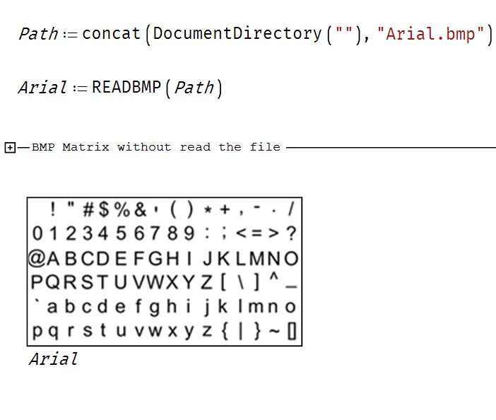

#14 Опубликовано: 16.12.2024 06:38:10
Oscar Campo
Oscar Campo
Yes Oscar, I was thinking about what was shown in the Alvaro's post but now in this last post of him here (Alvaro is really a force of nature ) there is another approach with some monospaced bitmap font scalable .
I need to study it in detail because due to my ignorance I do not undertand the whole method ( even if looks to me that he transit trough the creation of an image of what need to be typed on the plot and images are zoomable in XY Plot so this is a workaround to the zooming problem that we are trying to address) .
My original desire was to create callauts just with one font to semplify the project and I like a lot the Arial one ..but I don't know how to create a Arial Monospaced font with the Alvaro's method so I will try to use the Franklin font that is however a clean and elegant one and see if I am able to merge it in the other funtions that I have tried to develop by myself.
Franco
You need to create a BMP with the characters of your font. Look that this BMP must be 225x121 pixels (for compatibility with Alvaro's script)
This is the bmp for Arial font (please right click on it and "save as..." ) :
And this is the SMath script for read the bmp and convert it on matrix form for use with the Alvaro's script
Arial BMP.sm (1,03 МиБ) скачан 1713 раз(а).
Best wishes,
Oscar
francesco rapuano 16.12.2024 12:41:00, Alvaro 16.12.2024 21:38:00

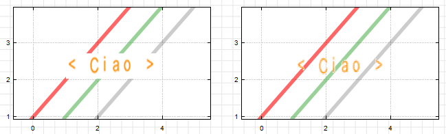

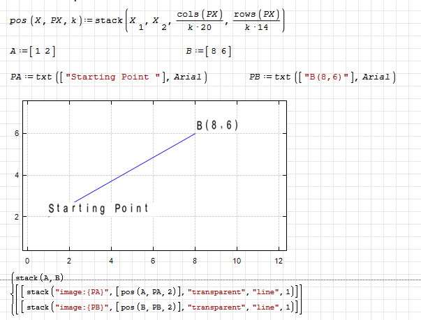

#17 Опубликовано: 29.12.2024 01:56:00
francesco rapuano
francesco rapuano
Hi Alvaro,Oscar,
sorry for disturbing you but I would like to know if it is possible to draw the string of BMP text on the XY Plot Plugin but with a transparent background, as you can imagine going ahead with the project of drawing Callouts rise the problem to have a text that allows to see the background graph or whatsever is in the background otherwise I guess that we lose clarity in what we highlight through the Callout.
I know that BMP doesn't allow a transparent channel ( or not ? ) we should move probably to a PNG format and probably I would be able to save in PNG with a transparent background the font matrix that now are in BNP format but the possibility of the XY Plot Plugin will allow to draw/show images/picture in PNG format with transparency ?
I hope I was able to describe the problem decently.
Thanks in advance for your help and best regards.
Franco
P.S:Herewith we see that the text "Starting point" hide a little bit the starting of the line segment , obviously I have inverted the display order sequence despite the original Alvaro's file to show this.
Ricardo_Herrera 25.04.2026 22:27:40
#18 Опубликовано: 29.12.2024 10:41:07
Hi Franco. At this moment I think the XYPlot plugin supports only one matrix with the grayscale from 0 to 255 or three matrices with the colors [R G B], but not transparencies, to represent images. However, I am not sure and that is something Viacheslav can answer.
Ricardo_Herrera 25.04.2026 22:27:37
#19 Опубликовано: 02.01.2025 18:07:10
Hi. A workaround.
XYPlot - Scalable monospaced bitmapped fonts COLOR.sm (2,17 МиБ) скачан 1840 раз(а).
Ricardo_Herrera 25.04.2026 22:27:36, Oscar Campo 03.01.2025 08:08:00, francesco rapuano 02.01.2025 18:39:00
