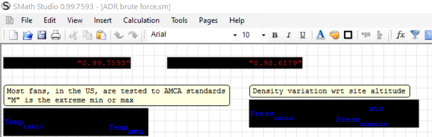

Bug is still present in Jean's file. Funny thing is this was MY work. His items came were hit or miss. I'm working off of portable version. See file post #3
#15 Posted: 2021/1/11 13:24:51
1,443 likes in 2,935 posts.
The bug is solved since the transparent background is no more saved as black, but existing files are still affected because the background color was saved as black (#000000).
Because it is a legit operation to set the background as black it might be excessive to force it as transparent by the program; IMO the fix should be done manually (if you think there are a lot of file affected and is safe to bruteforce replace the backgrounds, a batch script can do the job easily)
