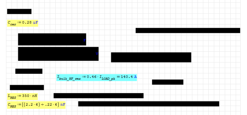

Change the background color of each line from black to white.
Carlos
Carlos
WroteHas anyone seen this ?
That freak is very recent from SS 7219.
Edit menu Select all, background White.
I remember it already happened a long time ago... Can you share the file that loads with different backgrounds?
WroteI remember it already happened a long time ago...
The problem is not constant from all SS 7219 download.
Neither it appeared from day 1.
It first appeared random, now seems every times.
Can it be caused by Win updates crashing some settings ?

WroteWroteHas anyone seen this ?
Problem is I have a bunch of expressions highlighted in various colors (e.g. user inputs, results), and they would get lost.

WroteProblem is I have a bunch of expressions highlighted in various colors (e.g. user inputs, results), and they would get lost.
From the few crappy all black SS 7219 downloaded
from the forum, NONE got lost following the procedure
previously offered. Another way of doing is as simple:
open the document [Work sheet], they are all black,
Edit, Select all, A from menu, select yellow.
You should see all of them yellow on black.
Change background to white, Edit, Select all,
A from menu, change yellow for black.
What we don't know yet: is it Smath or Windows ?
Is SS 7219 not compatible to Win 7 [per say or Win 10] ?

WroteI'm working on the same file at home and at work. Today when I loaded it at work some lines' background turned black. This is version "0.99.7219.26345"

Bug is still present in Jean's file. Funny thing is this was MY work. His items came were hit or miss. I'm working off of portable version. See file post #3
WroteBug is still present in Jean's file. Funny thing is this was MY work. His items came were hit or miss. I'm working off of portable version. See file post #3
The bug is solved since the transparent background is no more saved as black, but existing files are still affected because the background color was saved as black (#000000).
Because it is a legit operation to set the background as black it might be excessive to force it as transparent by the program; IMO the fix should be done manually (if you think there are a lot of file affected and is safe to bruteforce replace the backgrounds, a batch script can do the job easily)
WroteI have the same issue (0.99.7251.32800)
This bug started at SS 7610 from recollection, was reported.
Select all from Edit, background white.
