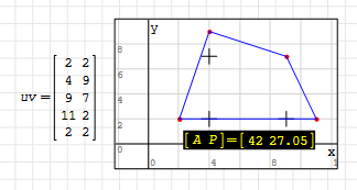

#9 Опубликовано: 01.11.2019 08:56:27
... download this recently created SS 6179.
What do you get in your recent SS 7219, all black ?
Maths Polygon Area_Perimeter.sm (55,37 КиБ) скачан 1563 раз(а).

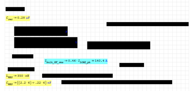

#10 Опубликовано: 01.11.2019 12:35:27
jcuadra
jcuadra
0 сообщений из 12 понравились пользователям.
Thanks.
The only black area is attached below.
#11 Опубликовано: 01.11.2019 13:03:00
Thanks.
Yes, because I created this way [yellow maths on black background].
BTW: black is not [0,0,0] rather [1,1,1].

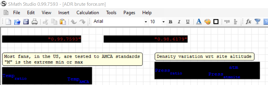

Bug is still present in Jean's file. Funny thing is this was MY work. His items came were hit or miss. I'm working off of portable version. See file post #3
#15 Опубликовано: 11.01.2021 13:24:51
The bug is solved since the transparent background is no more saved as black, but existing files are still affected because the background color was saved as black (#000000).
Because it is a legit operation to set the background as black it might be excessive to force it as transparent by the program; IMO the fix should be done manually (if you think there are a lot of file affected and is safe to bruteforce replace the backgrounds, a batch script can do the job easily)
