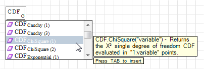

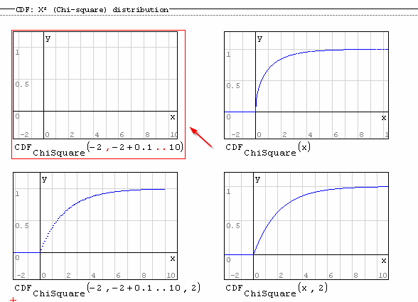

PLEASE REPORT HERE ANY ISSUE.
requirements: .Net Framework 3.5 (Windows) / Mono 2.0 (Linux) / SMath Studio 0.97.5581
installation: Tools > Plugins > change "Local Storage" to "Online Gallery" > Statistical Tools
sources: if you want to see the plugin sources, look in the SVN repository.
embedded plugins: Meta Numerics library 2.2.1.0 (website, license)

Just played a bit, and have seen a problem with CDF.ChiSquare( "variable" )-(image attached). Did not quite understand why this problem appear at the moment. Also, do not quite understand what this description mean
CDF.ChiSquare( "variable" ) - Returns the Χ² sDOF CDF evaluated in "1:variable" points.
I suppose that sDOF means "single degree of freedom"
WroteHello w3b5urf3r,
Many thanks for this plugin.
:d seem that some eval() in the Reguarized Gamma functions it's stricly necessary for some value.... fixed and updated
You supposed right :-p Now I've extended the acronym
