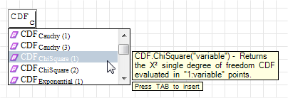

pdf.Cauchy("variable") - Returns the Standard Cauchy pdf (x.0 = 0 and γ = 1) evaluated in "1:variable" points.
pdf.Cauchy("1:variable", "2:number", "3:number") - Returns the Cauchy pdf evaluated in "1:variable" points, using assigned "2:number" location parameter and the "3:number" scale parameter.
pdf.ChiSquare("variable") - Returns the Χ² single degree of freedom pdf evaluated in "1:variable" points.
pdf.ChiSquare("1:variable", "2:number") - Returns the Χ² pdf evaluated in "1:variable" points, using assigned "2:number" degrees of freedom.

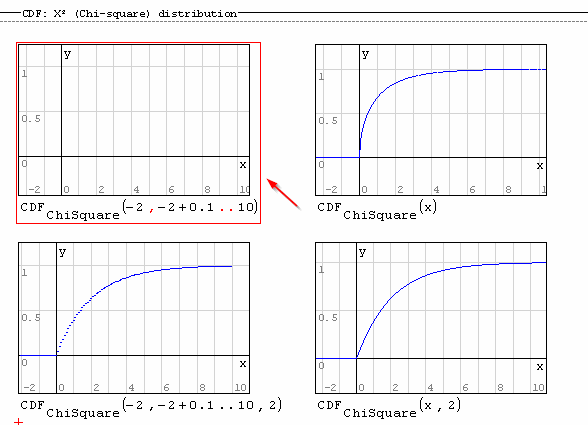

CDF.ChiSquare("variable") - Returns the Χ² single degree of freedom CDF evaluated in "1:variable" points.
CDF.ChiSquare("1:variable", "2:number") - Returns the Χ² CDF evaluated in "1:variable" points, using assigned "2:number" degrees of freedom.

Just played a bit, and have seen a problem with CDF.ChiSquare( "variable" )-(image attached). Did not quite understand why this problem appear at the moment. Also, do not quite understand what this description mean
CDF.ChiSquare( "variable" ) - Returns the Χ² sDOF CDF evaluated in "1:variable" points.
I suppose that sDOF means "single degree of freedom"

:d seem that some eval() in the Reguarized Gamma functions it's stricly necessary for some value.... fixed and updated
You supposed right :-p Now I've extended the acronym
