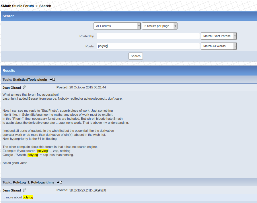

The other complain about this forum is that it has no search engine,
Example: if you search "polylog" ,,, zap, nothing
Google , "Smath, polylog" = zap less than nothing.
Search engine is not ideal, but it can be helpful

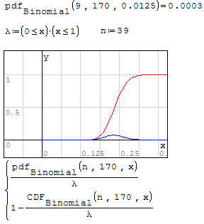

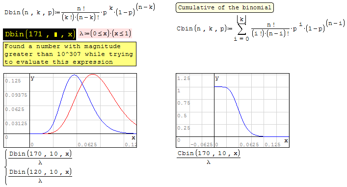

Davide,
Thank you very much for this plug-in. I have a couple of comments.
The CDF for the binomial distribution returns 0 for 0 successes when it should return the same value as the PDF with 0 successes.
The formula that you are using to calculate the PDF uses factorials:
[f(x,n,p):{n!}/{(x!)*((n-x)!)}*p^x*(1-p)^{n-x}]
This limits the value of the number of trial to less than 170 or an overflow occurs (which SMath catches). A better way may be to use the multiplicative formula to calculate the binomial coefficent term of the PDF which won't overflow until 980 and only then when x = n/2. As x tends away from n/2, the number of trials entered can be significantly increased without overflow. In this case, you need to add the condition that if x = 0 then the binomial coefficient = 1 due to a div/0.
Since the CDF just sums over the PDF as x goes from 0 to x, the same issue exists there as well.
None of this is very robust, but it should make the binomial functions a bit more usable.

1. limit 170 => confirmed
2. try to propram "multiplicative"
3. OBSERVE: CDF ... 1-CDF

Thank you both, I'll check it ASAP
Maybe like this above 170 ... ?
Stat Treasury_6 Dbin Multiplicative.sm (13.44 KiB) downloaded 1434 time(s).
