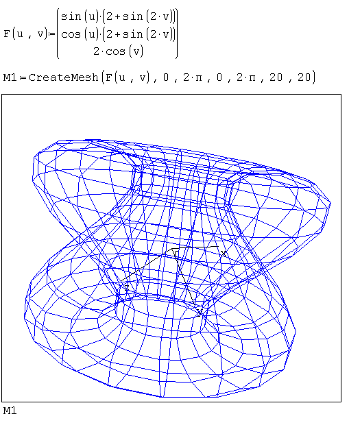

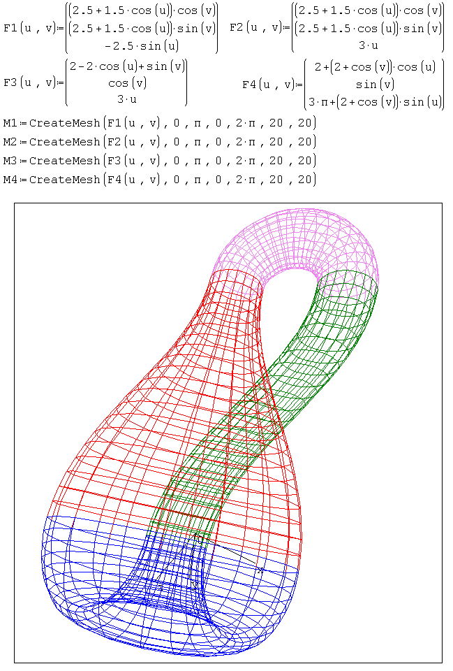

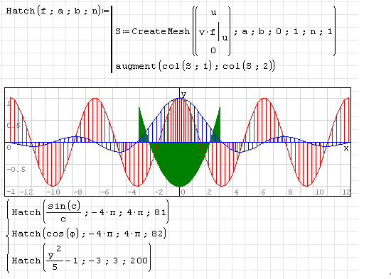

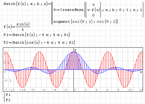

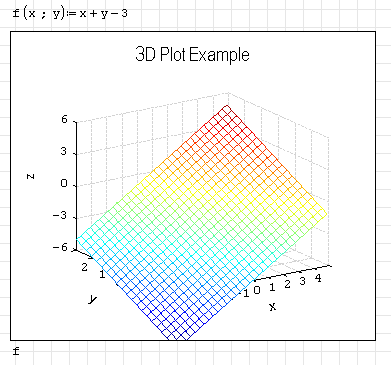

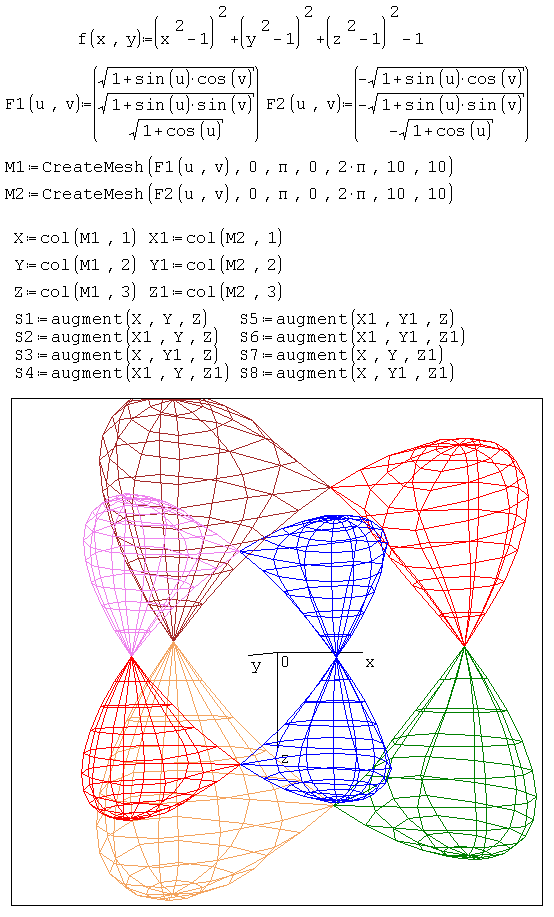

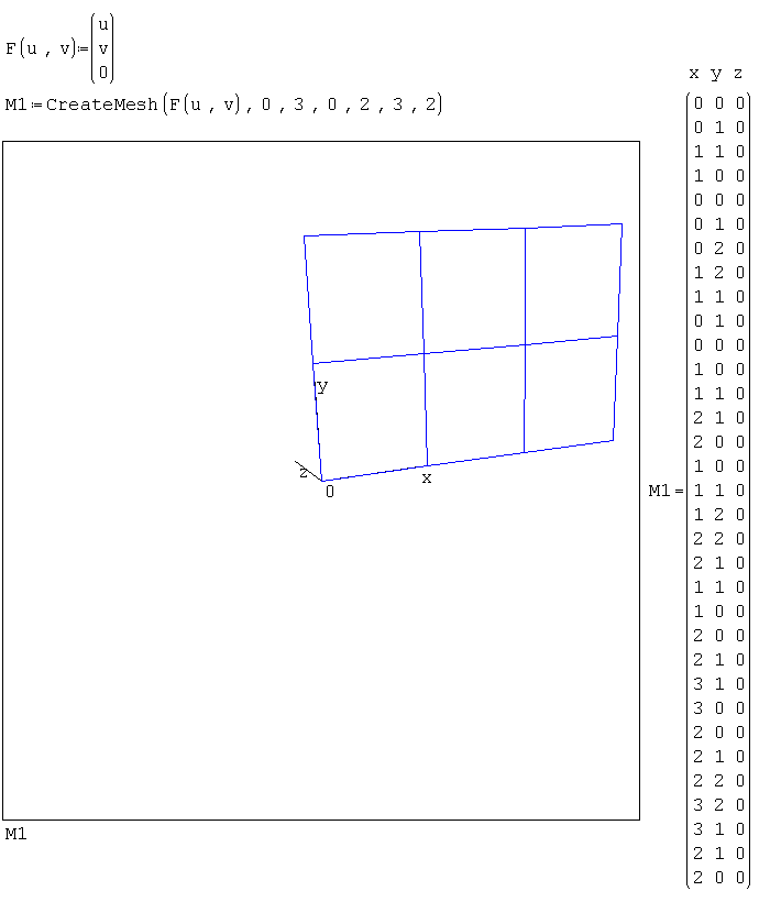

3DPlotRegion_screen1.png 3D Plot. CreateMesh. Example 3.png 3D Plot. CreateMesh. Example 1.png 3D Plot. CreateMesh. Example 2.png 3D Plot. CreateMesh. Example 4.png

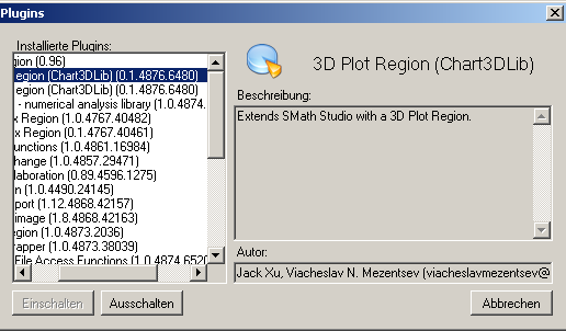

Thanks for the update. I installed the updated version and removed Plot3D.
now the 3DPlotRegion plugin shows up twice in the plugin manager, see attached screenshot.
Don't worry, this is normal. Andrey will correct it.

CreateMesh() is useful for 2D plots as well...
