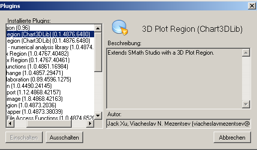

Thanks for the update. I installed the updated version and removed Plot3D.
now the 3DPlotRegion plugin shows up twice in the plugin manager, see attached screenshot.
#13 Posted: 5/7/2013 6:46:03 PM
1,558 likes in 1,868 posts.
Updated. Function CreateMesh() moved from the Plot3D plugin. Do not use it any more.
Don't worry, this is normal. Andrey will correct it.

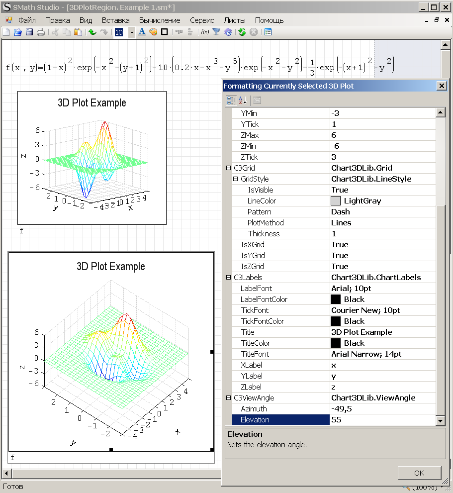

I am using the plugin from the extension manager.
Seems that I can now save the regions, but user settings aren't saved (see attached sheet, where the default settings are not really appropriate).
Is that a local problem or known bug?

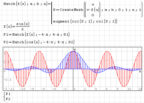

CreateMesh() is useful for 2D plots as well...

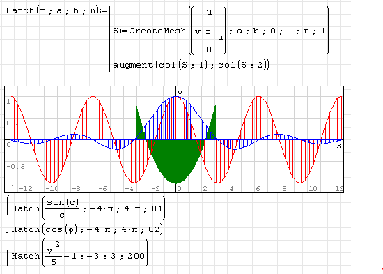

1 likes in 17 posts.
Is it possible to use augment(u;v;f) on 3DPlot plugin, like we use on a X-Y Plot plugin? (u;v;f are vectors).
rod_spring.sm (32.11 KiB) downloaded 2116 time(s).
