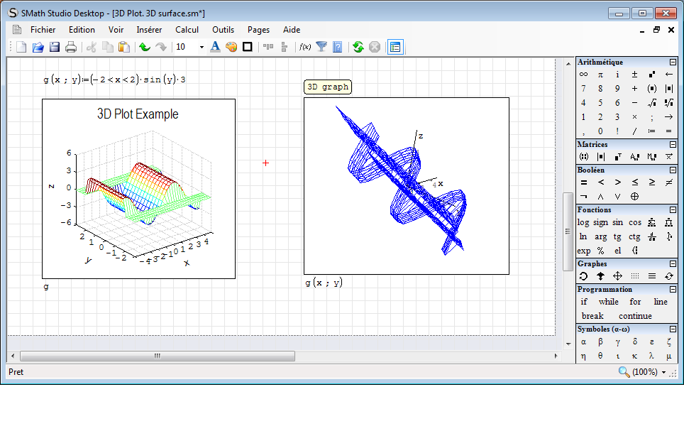

am I wrong or the x and y axis are exchanged?
I have downloaded smath studio a few days ago and made some examples to be more familiar with the program. Today I have tested 3D plot and found 2 strange behaviour.
First on 3D plot x and y seems to be swapped
Second the same formula plotted by 3D plot and by 3D graph give a different view
#23 Posted: 2014/4/8 08:59:12
1,443 likes in 2,935 posts.
The SMath built-in 3D plot is left-handed, the 3DPlot Region is right-handed (being able to choose, I prefer the 2nd but is matter of taste)

But the sin function is defined with y as variable and the step function is defined with x as variable. On the 3D plot the sin is along the X axis and the step function along the Y one.

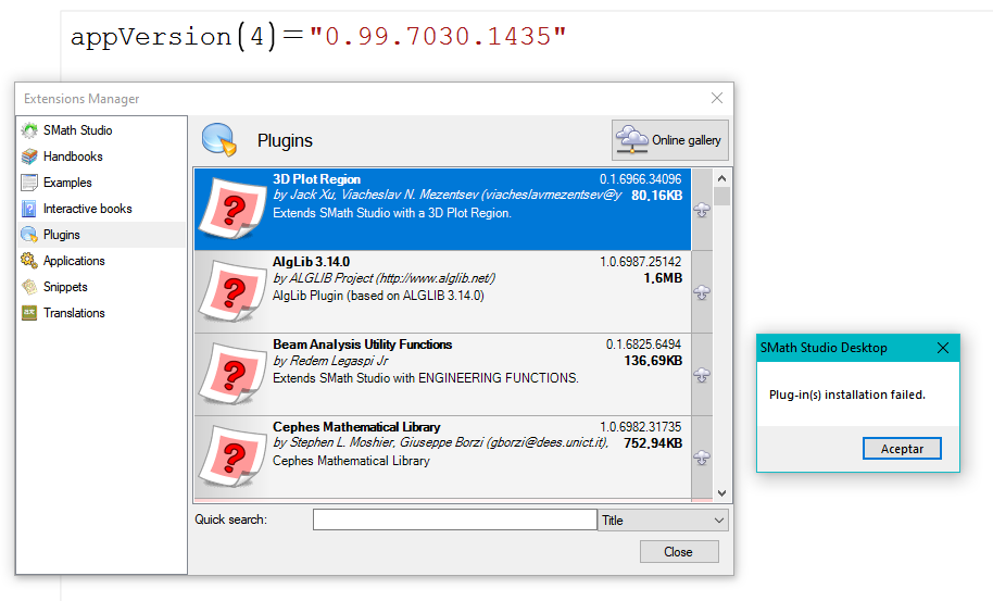

I really need this amazing plug-in to plot around a million independent points, but I am having this issue with the installation. Could someone help me?
Thank you in advance.

Thank you uni and Jean for your answers, now I reviewed my problem. Fortunately I have already installed the 3D Plot Region plugin (99.7030 SM version). I don't know why "plug-in installation failed" last week, but now that problem is solved.

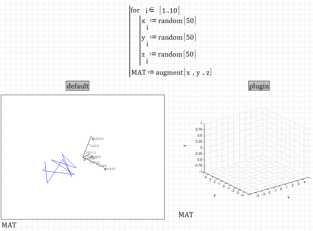

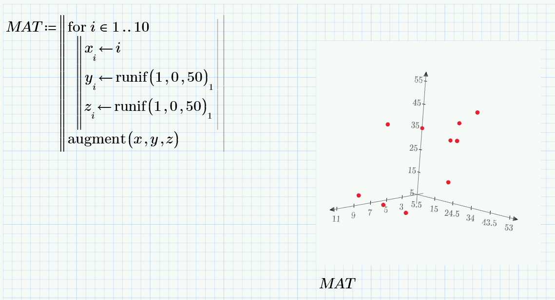

What I understand for the 3D plot region is that you need a function to be plotted, and please correct me if I am wrong. I was reviewing your image creation files Jean, and was very helpful for me to know those functionalities, but in my case, I have a 3D graph more like "scatter plot".
Here, for example, I generate a random matrix 10x3 of ten points in x,y,z coordinates. In the included default 3D plot, it seems that I cannot delete the line between points (I want only the points to be displayed), and also I cannot extend the axis coordinates to verify the coordinates for a point. It looks like the coordinates are reversed, since there is no point plotted in the x+,y+,z+ region (and that region should be the only one with plotted points). Also it seems to be totally out of range because my axis values are around 50000 and I have values no greater than 50.
I hope you can help me, or if you know that I could do this sort of plots in another program but from SMath (I begin to know about Maxima, for instance).
Thank you both again!
SMath:
Mathcad:
SMath file:
Scatter plot.sm (4.54 KiB) downloaded 1408 time(s).
(sorry for the too large images, I don't know how to change that)

Now this component cannot be fully used for your purposes. Point visualization is not implemented. I am still looking for time to study the theory of three-dimensional graphics. Unfortunately, the limitations do not allow the use of free components. Writing everything from scratch is a time consuming task.
