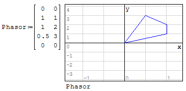

Hello, Basile
On that one you can do a bit more.
Too much may be too much, isn't ?
Maths Polygon.sm (17.1 KiB) downloaded 1076 time(s).

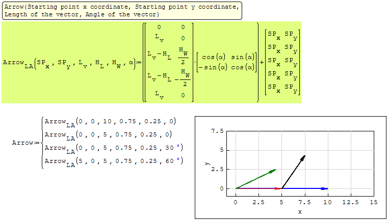

#8 Posted: 2019/5/23 20:32:28
What are the red squares to the right?
Red square in the scroll bar points at the errors in the document.
More elegant arrows proposed.

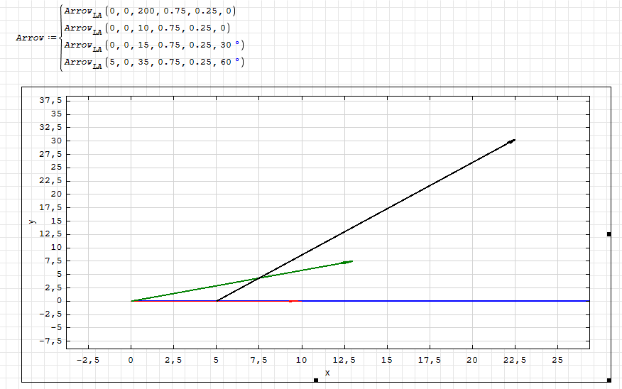

The arrows fail when the length of the vector changes.
I have tried as a percentage of length but does not look nice.
Scaling the vectors to always be one but will loose real valuesSMath-1.PNG.
Any good idea?
Is there a way to auto-scale the 2D plot or X-Y plot?
One of the vectors is out of the visual plane.
Thanks,
Basile

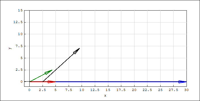

#11 Posted: 2019/5/24 17:35:33
Any good idea?
None of the quick plot or X_Y plot can be made X, Y directions scalable
similar to Mathcad 11 ... to me: useless.
From an original X_Y plot creation, stretch by handles respect aspect ratio.
If you modify the X, Y directions [max/min], apply close enough HL, HW ratio.
Page2-error (1).sm (11.66 KiB) downloaded 1220 time(s).

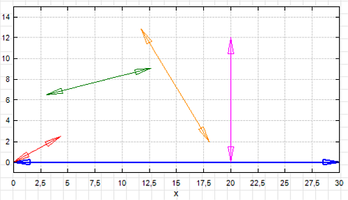

#13 Posted: 2019/5/25 21:24:37
NDTM Amarasekera
NDTM Amarasekera
130 likes in 352 posts.
With both arrow heads, based on Jean's method.
Thank you Jean.
Both Arrows.sm (30.49 KiB) downloaded 1028 time(s).
