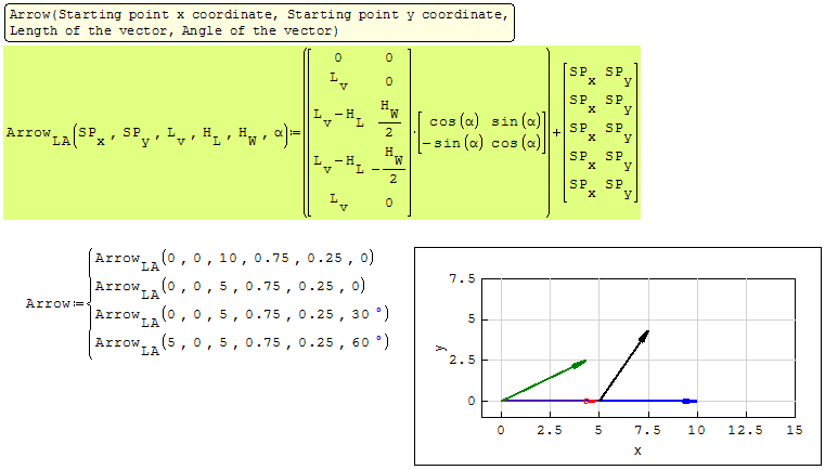

#8 Опубликовано: 23.05.2019 20:32:28
What are the red squares to the right?
Red square in the scroll bar points at the errors in the document.
More elegant arrows proposed.
Page2-error.sm (8,34 КиБ) скачан 1368 раз(а).

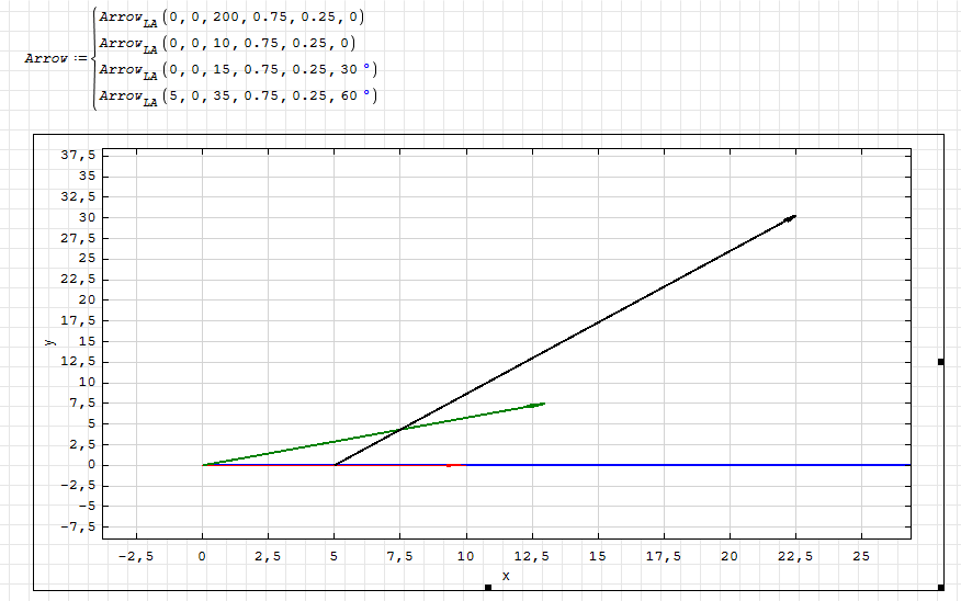

Hi Jean,
The arrows fail when the length of the vector changes.
I have tried as a percentage of length but does not look nice.
Scaling the vectors to always be one but will loose real valuesSMath-1.PNG.
Any good idea?
Is there a way to auto-scale the 2D plot or X-Y plot?
One of the vectors is out of the visual plane.
Thanks,
Basile
#10 Опубликовано: 24.05.2019 15:19:13
1 555 сообщений из 1 867 понравились пользователям.
As I said before:
How about a simple arrow?
I do not know how to do it better. The arrow should look good in different scales and in its own size.

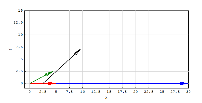

#11 Опубликовано: 24.05.2019 17:35:33
Any good idea?
None of the quick plot or X_Y plot can be made X, Y directions scalable
similar to Mathcad 11 ... to me: useless.
From an original X_Y plot creation, stretch by handles respect aspect ratio.
If you modify the X, Y directions [max/min], apply close enough HL, HW ratio.
Page2-error (1).sm (11,66 КиБ) скачан 1383 раз(а).

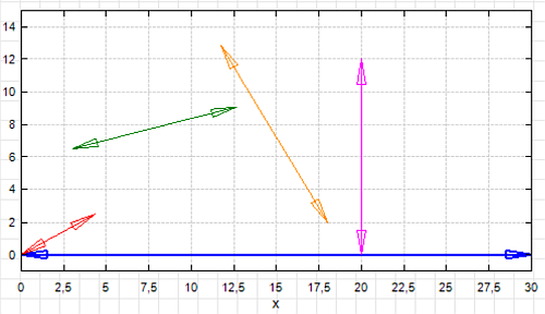

#13 Опубликовано: 25.05.2019 21:24:37
NDTM Amarasekera
NDTM Amarasekera
With both arrow heads, based on Jean's method.
Thank you Jean.
Both Arrows.sm (30,49 КиБ) скачан 1180 раз(а).
#14 Опубликовано: 26.05.2019 00:52:40
Basile
Basile
8 сообщений из 172 понравились пользователям.
Why I am getting errors when load your file?
The latest Stable: SMath Studio 0.99.7030 (01 April 2019)
At the end I am able to open the file.
I do the same with two arrows 2π apart, but yours is more elegant.
Basile
