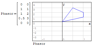

Hello, Basile
On that one you can do a bit more.
Too much may be too much, isn't ?
Maths Polygon.sm (17.1 KiB) downloaded 1266 time(s).

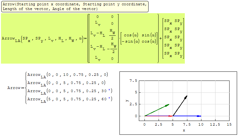

#8 Posted: 5/23/2019 8:32:28 PM
What are the red squares to the right?
Red square in the scroll bar points at the errors in the document.
More elegant arrows proposed.
Page2-error.sm (8.34 KiB) downloaded 1419 time(s).

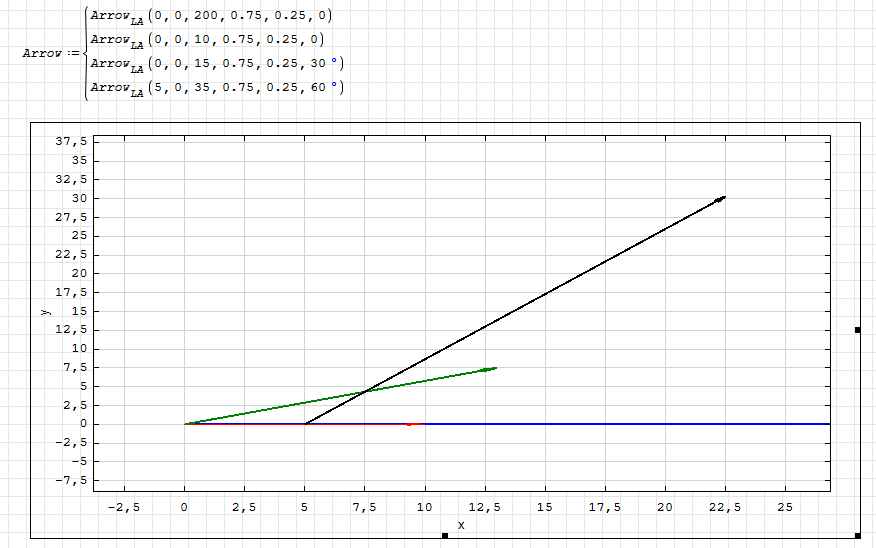

Hi Jean,
The arrows fail when the length of the vector changes.
I have tried as a percentage of length but does not look nice.
Scaling the vectors to always be one but will loose real valuesSMath-1.PNG.
Any good idea?
Is there a way to auto-scale the 2D plot or X-Y plot?
One of the vectors is out of the visual plane.
Thanks,
Basile
#10 Posted: 5/24/2019 3:19:13 PM
1,558 likes in 1,868 posts.
As I said before:
How about a simple arrow?
I do not know how to do it better. The arrow should look good in different scales and in its own size.
#11 Posted: 5/24/2019 5:35:33 PM
Any good idea?
None of the quick plot or X_Y plot can be made X, Y directions scalable
similar to Mathcad 11 ... to me: useless.
From an original X_Y plot creation, stretch by handles respect aspect ratio.
If you modify the X, Y directions [max/min], apply close enough HL, HW ratio.
Page2-error (1).sm (11.66 KiB) downloaded 1432 time(s).

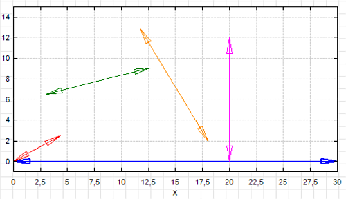

Another kind of arrow.
Arrow.sm (5.46 KiB) downloaded 1177 time(s).
NDTM Amarasekera 5/24/2019 11:22:00 PM, frapuano 5/25/2019 2:46:00 AM, Вячеслав Мезенцев 5/25/2019 6:08:00 AM

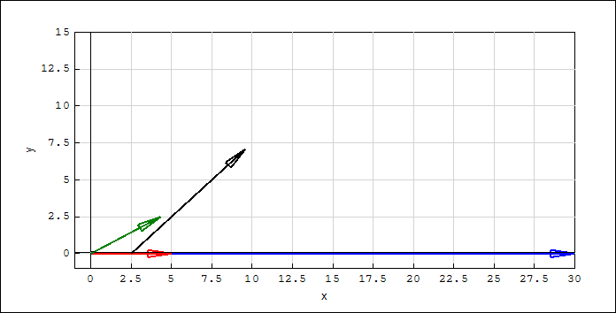

#13 Posted: 5/25/2019 9:24:37 PM
NDTM Amarasekera
NDTM Amarasekera
130 likes in 352 posts.
With both arrow heads, based on Jean's method.
Thank you Jean.
Both Arrows.sm (30.49 KiB) downloaded 1210 time(s).
