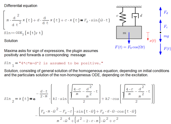

All students are on vacation, but I urgently need to convert the formula from Maple to Smath.
#2 Posted: 2024/2/5 17:58:53
1,308 likes in 2,221 posts.
This is how I'd handle it with the Maxima plugin. In the first case with ODE.2(), Solve() can be applied to use the initial conditions to determine the constants of integration k1 and k2. In the second case with desolve() the initial conditions are specified beforehand with atvalue(). You get the symbolic solution if you disable the value assignments to the system constants.
2024-02-05 10_32_19-SMath with Maxima Inforino 2024 - PDF-XChange Editor.png
