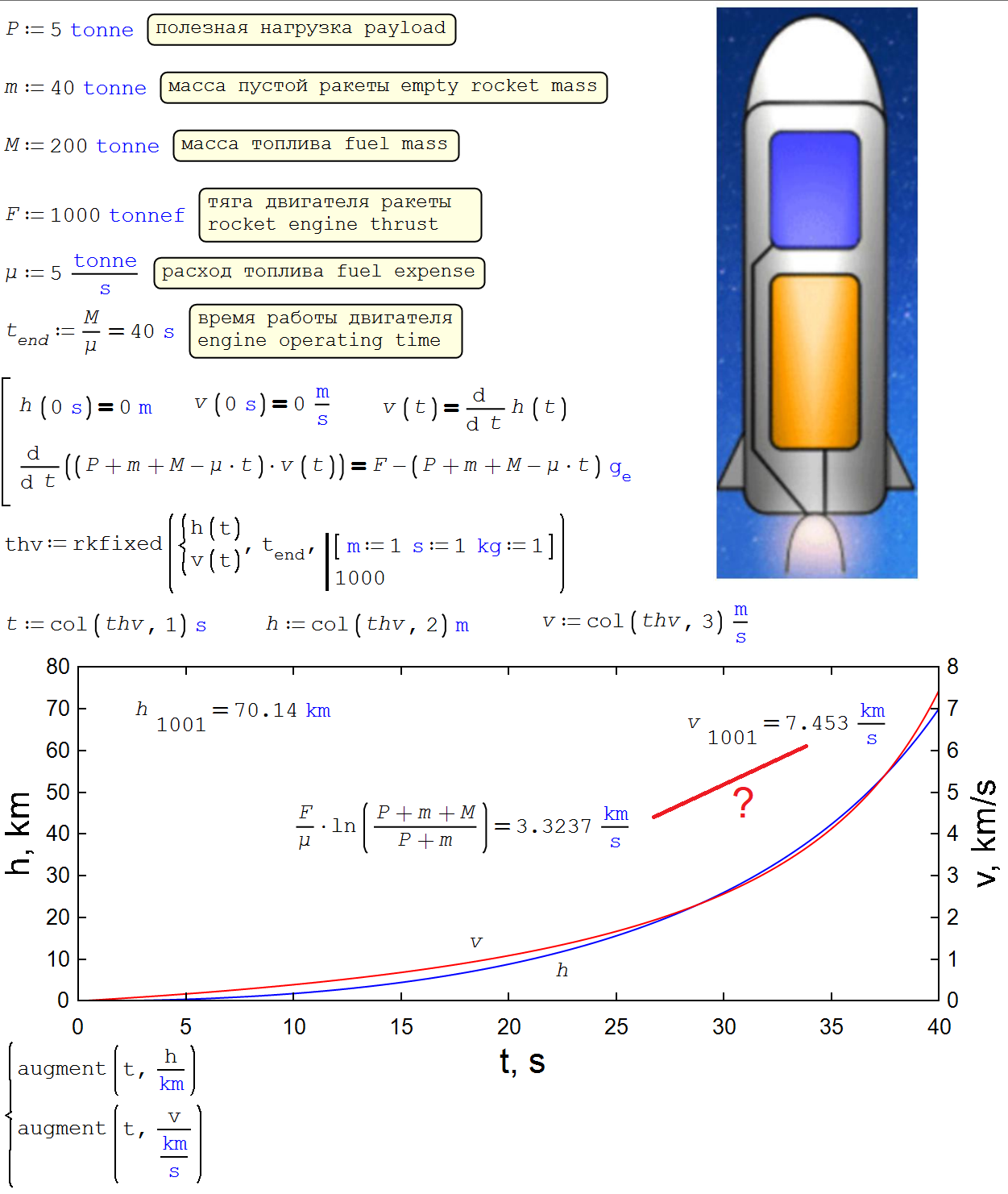

Error by ODEs solution
Error by ODEs solution - Help please - Messages
#1 Posted: 2023/12/14 01:35:18
Valery Ochkov
Valery Ochkov
66 likes in 690 posts.
Here OK Rocket-1.sm (16.79 KiB) downloaded 1251 time(s).
Here not OK Rocket-2.sm (688.11 KiB) downloaded 1286 time(s).
About the problem Study-24-How-calculate-Rocket.doc (1.95 MiB) downloaded 728 time(s).
from the book
https://www.routledge.com/25-Problems-for-STEM-Education/Ochkov/p/book/9780367345259

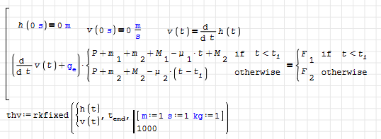

#2 Posted: 2023/12/14 09:58:26
1,123 likes in 1,795 posts.
Hi Valery. Just use cases() instead if() clauses.
Rocket-2.sm (688.31 KiB) downloaded 1310 time(s).
But Newton's second law is not F=ma which is an expression valid only for systems where m is constant. The general expression given by Newton is F=d(mv)/dt or F=dp/dt with p=mv the linear momentum.

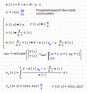

One questions.
How can we solve this problem with ODE as F=dp/dt, not F=m dv/dt?
Will we get others (numerical) answer?
Rocket-2-otherwise.sm (690.02 KiB) downloaded 1282 time(s).
#4 Posted: 2023/12/14 18:32:10
The speed of the rocket cannot be independent of the speed at which the propellant exits. Entering that information gives me this solution
Rocket-1.sm (20.07 KiB) downloaded 1254 time(s).
Another way of looking at it, using the equation F = d(mv)/dt, we must take into account that in a rocket the reaction force is not applied to the same body as the action force, as the 3rd Law says, and therefore the temporal derivative of the product mv must be done by changing the reference frame, which is why it is F = m dv/dt + u dm/dt, where v is the speed of the rocket with respect to the inertial reference system attached to the earth, but u is the speed of the propellant with respect to the non-inertial reference system attached to the rocket
#5 Posted: 2023/12/14 18:35:31
Valery Ochkov
Valery Ochkov

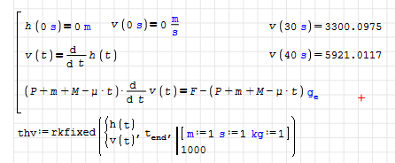

New question
Rocket-1.sm (734.95 KiB) downloaded 1288 time(s).

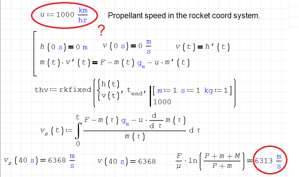

#6 Posted: 2023/12/15 01:16:32
New question...
Hi Valery. You can't take the temporal derivative directly. Please see my previous answer explaining why I think that.
#7 Posted: 2023/12/15 02:39:15
Valery Ochkov
Valery Ochkov
New question...

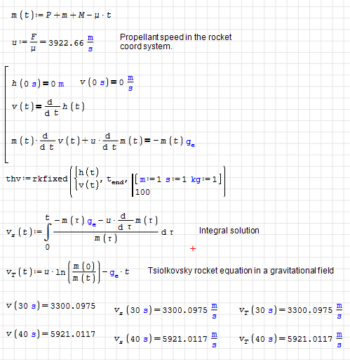

Hi Valery. You're right encircling u. Its correct value is u = F/μ. Thus, the force over the rocket is F = - mg - u*dm/dt
Rocket-1.sm (23.73 KiB) downloaded 1286 time(s).
#9 Posted: 2023/12/15 04:04:15
Valery Ochkov
Valery Ochkov
Thanks, Alvaro.

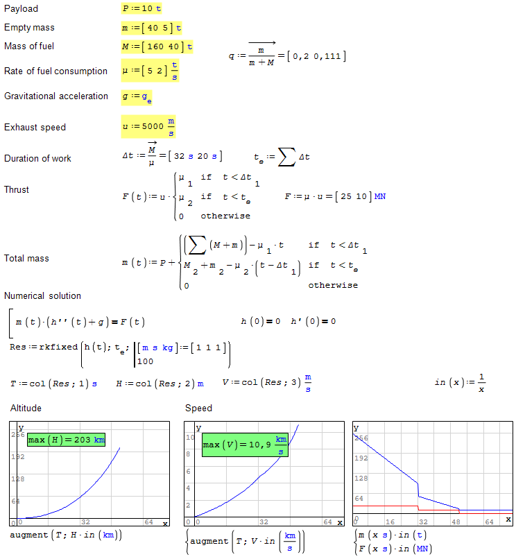

And what about the 2-stage rocket?
Our first try
Rocket-2.sm (690.02 KiB) downloaded 1340 time(s).
#10 Posted: 2023/12/15 04:30:05
Our first try
Hi. Your original solution for rocket-1 is ok, and that implies that the movie's solution is also ok.
I was only pointing out the way to deduce it. Writing the relationship for several stages would imply asking for derivatives for functions with cases(), which cannot be done, because although functions can be integrated with cases() or using inside the Mathcad block, they definitely cannot be derived.
So I guess the best solution is the one you gave at the beginning, simply replacing the if() with cases(). The deduction based on physical principles has already been done for one stage. Now it remains to apply the simplified result for several, which is exactly what the rocket-2 case does.
#11 Posted: 2023/12/15 05:00:55
Valery Ochkov
Valery Ochkov
I think it is easier to solve two equations - for two stages, and then for one (last) stage of the rocket.

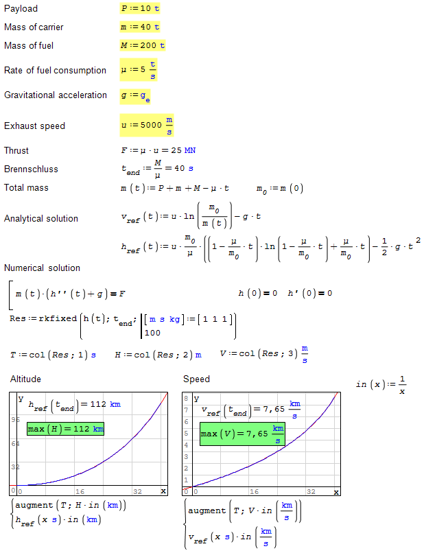

#12 Posted: 2023/12/15 06:58:19
1,355 likes in 2,271 posts.

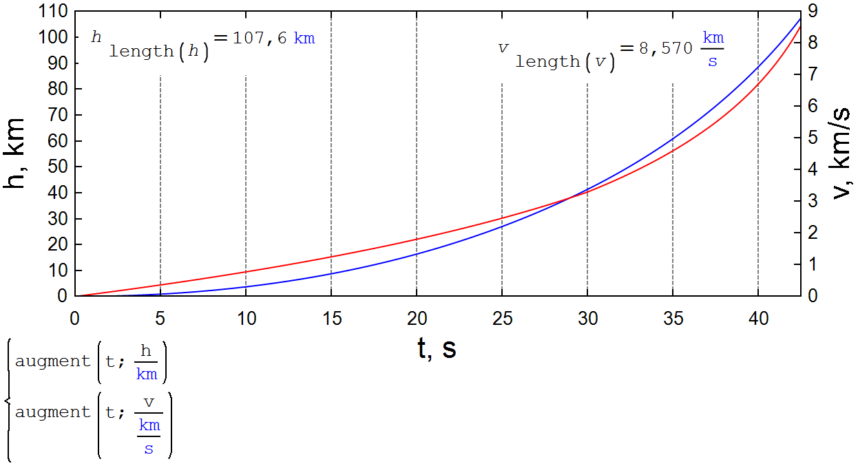

Analytical reference solution for h(t) (from a mechanics textbook) and with a single second order DE. in() would be even better without braces (operator form)
Rakete.sm (21.1 KiB) downloaded 1276 time(s).
Rakete2.sm (21.45 KiB) downloaded 1307 time(s).

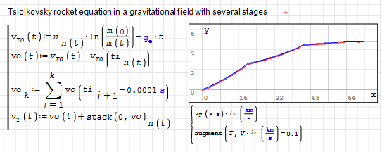

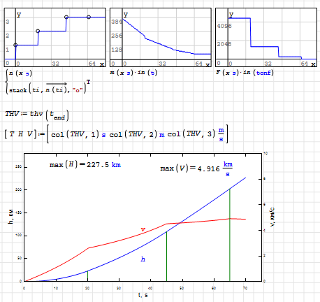

#20 Posted: 2023/12/18 07:35:01
3 stages variation.
Checking with Tsiolkovsky rocket equation in a gravitational field with several stages
Rakete-3.sm (46.49 KiB) downloaded 1303 time(s).
