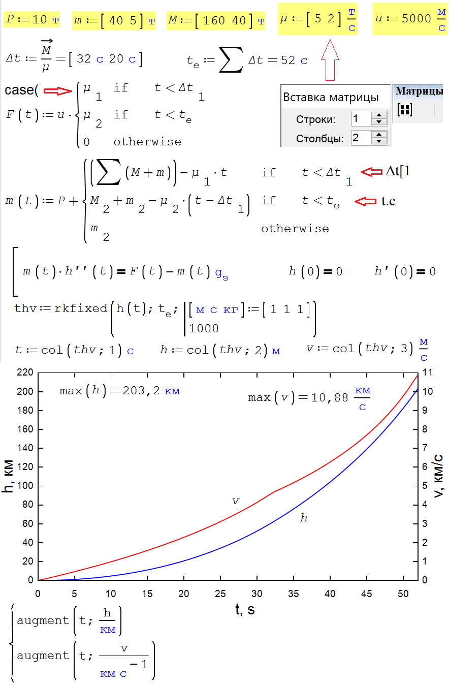

3 stages variation.
Checking with Tsiolkovsky rocket equation in a gravitational field with several stages

New versions
Polet na Lunu.docx (496.8 KiB) downloaded 459 time(s).
Rakete-1.sm (17.75 KiB) downloaded 860 time(s).
Rakete-2.sm (17.14 KiB) downloaded 852 time(s).

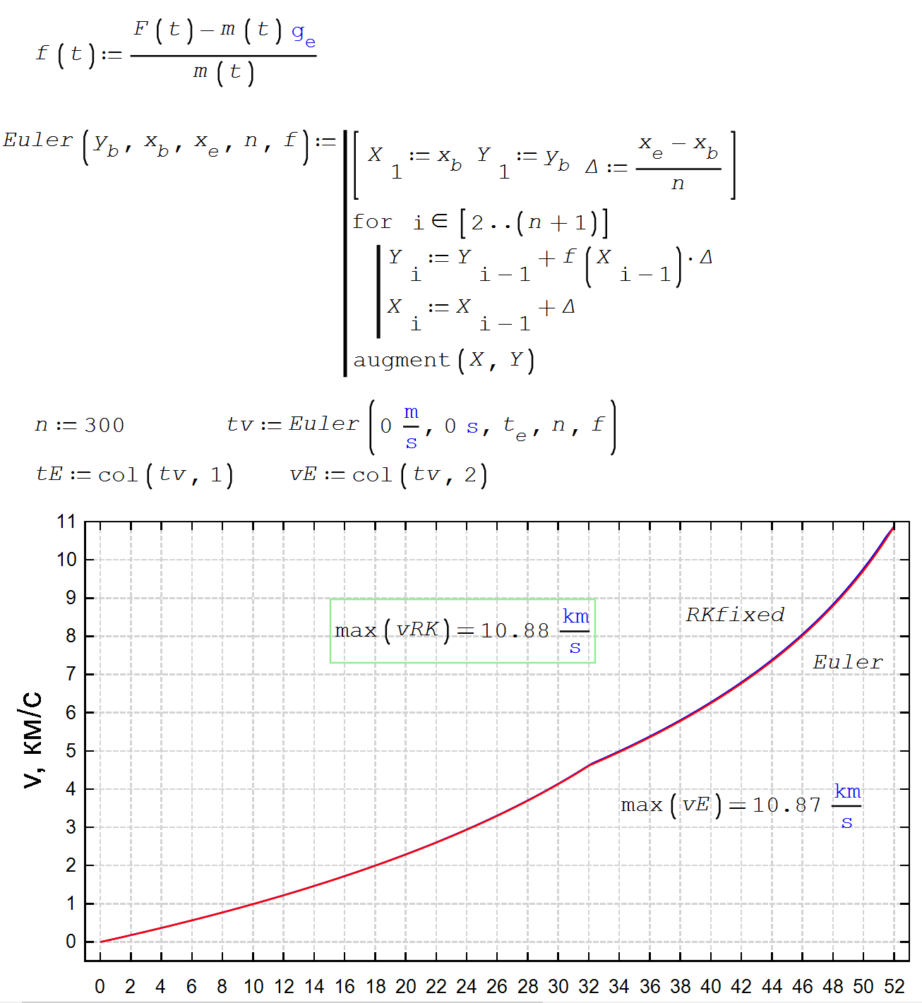

Old good Euler. With units.
Rakete-2-RK-E.sm (27.53 KiB) downloaded 840 time(s).
Martin Kraska 2023/12/23 01:11:00
#26 Posted: 2023/12/23 01:11:01
1,308 likes in 2,221 posts.

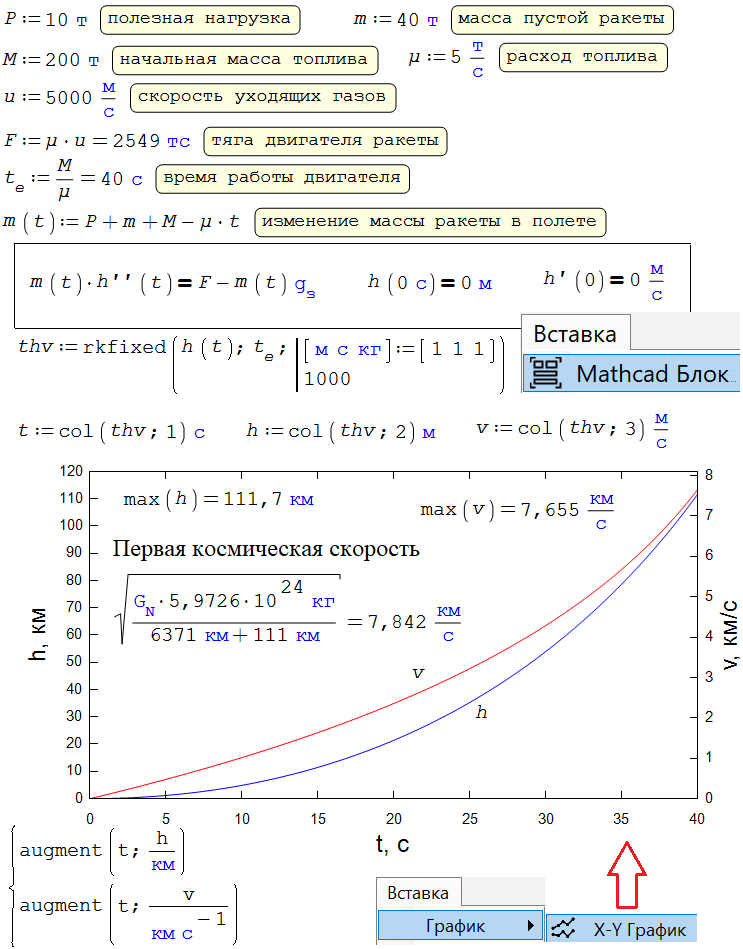

Three examples: the napkin calculation of "Nine Days of One Year", a single-stage and a two-stage rocket with parameters such that humans could survive the flight (limited acceleration).
The first section of the pdf is based on Valery's text posted earlier. It also includes some tasks for the reader.
Rakete.sm (23.7 KiB) downloaded 901 time(s).
Rakete2.sm (24.72 KiB) downloaded 858 time(s).
Serviette.sm (9.43 KiB) downloaded 844 time(s).
Rocket.pdf (421.58 KiB) downloaded 475 time(s).

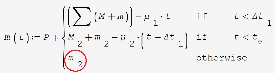

#28 Posted: 2023/12/23 06:16:12
Whether m(t) is P or P+m[2 after engine cut-off depends on whether you get rid of the structure of the second stage or not. As long as we don't consider any subsequent maneuvers, the difference has no influence. If you do nothing, then payload and empty second stage will orbit side by side, separated or not.
#29 Posted: 2023/12/23 15:03:09
Valery Ochkov
Valery Ochkov
64 likes in 670 posts.
In Russia we say - punctual as a German!
