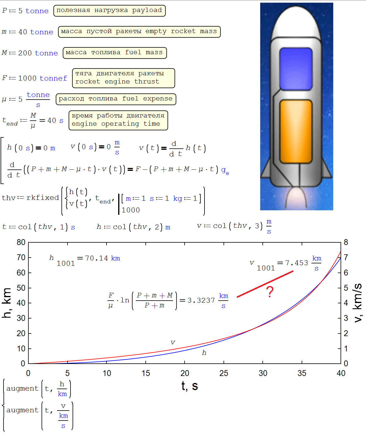

#1 Опубликовано: 14.12.2023 01:35:18
Valery Ochkov
Valery Ochkov
67 сообщений из 713 понравились пользователям.
Here OK Rocket-1.sm (16,79 КиБ) скачан 1421 раз(а).
Here not OK Rocket-2.sm (688,11 КиБ) скачан 1453 раз(а).
About the problem Study-24-How-calculate-Rocket.doc (1,95 МиБ) скачан 842 раз(а).
from the book
https://www.routledge.com/25-Problems-for-STEM-Education/Ochkov/p/book/9780367345259

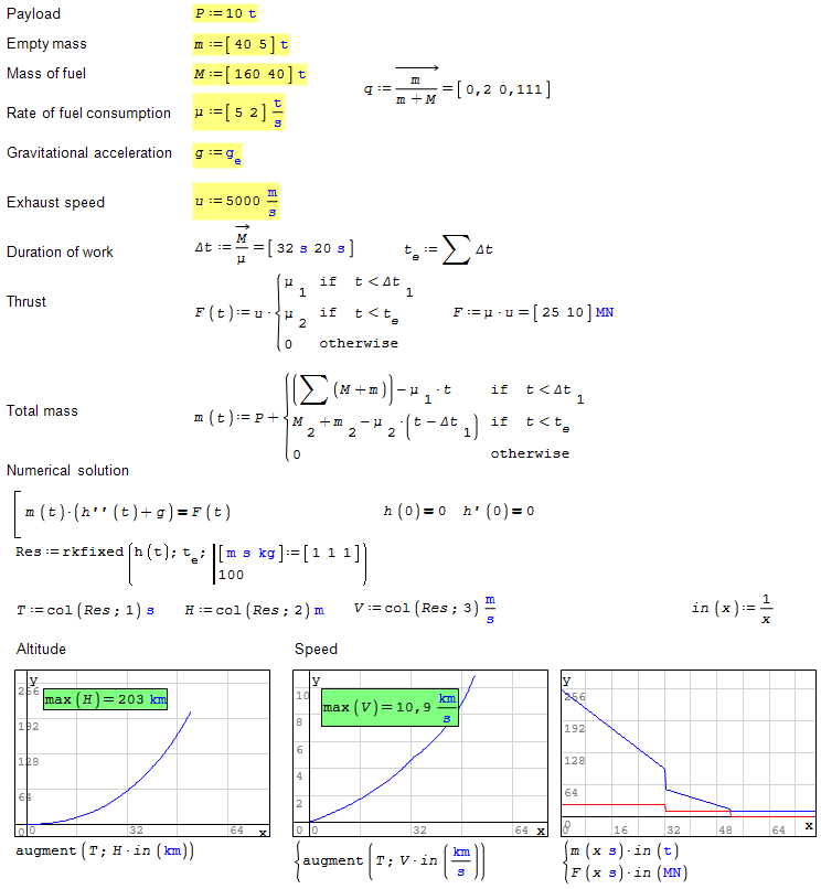

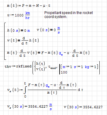

#2 Опубликовано: 14.12.2023 09:58:26
Hi Valery. Just use cases() instead if() clauses.
Rocket-2.sm (688,31 КиБ) скачан 1485 раз(а).
But Newton's second law is not F=ma which is an expression valid only for systems where m is constant. The general expression given by Newton is F=d(mv)/dt or F=dp/dt with p=mv the linear momentum.

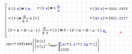

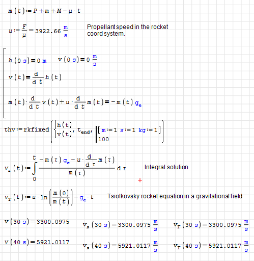

#4 Опубликовано: 14.12.2023 18:32:10
The speed of the rocket cannot be independent of the speed at which the propellant exits. Entering that information gives me this solution
Rocket-1.sm (20,07 КиБ) скачан 1426 раз(а).
Another way of looking at it, using the equation F = d(mv)/dt, we must take into account that in a rocket the reaction force is not applied to the same body as the action force, as the 3rd Law says, and therefore the temporal derivative of the product mv must be done by changing the reference frame, which is why it is F = m dv/dt + u dm/dt, where v is the speed of the rocket with respect to the inertial reference system attached to the earth, but u is the speed of the propellant with respect to the non-inertial reference system attached to the rocket

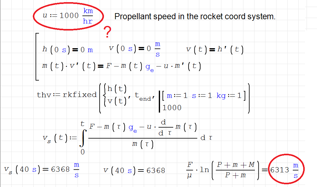

#6 Опубликовано: 15.12.2023 01:16:32
New question...
Hi Valery. You can't take the temporal derivative directly. Please see my previous answer explaining why I think that.
#7 Опубликовано: 15.12.2023 02:39:15
Valery Ochkov
Valery Ochkov
New question...
#8 Опубликовано: 15.12.2023 03:25:33
Hi Valery. You're right encircling u. Its correct value is u = F/μ. Thus, the force over the rocket is F = - mg - u*dm/dt
Rocket-1.sm (23,73 КиБ) скачан 1463 раз(а).

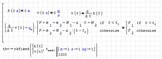

Our first try
Rocket-2.sm (690,02 КиБ) скачан 1518 раз(а).
#10 Опубликовано: 15.12.2023 04:30:05
And what about the 2-stage rocket?
Our first try
Hi. Your original solution for rocket-1 is ok, and that implies that the movie's solution is also ok.
I was only pointing out the way to deduce it. Writing the relationship for several stages would imply asking for derivatives for functions with cases(), which cannot be done, because although functions can be integrated with cases() or using inside the Mathcad block, they definitely cannot be derived.
So I guess the best solution is the one you gave at the beginning, simply replacing the if() with cases(). The deduction based on physical principles has already been done for one stage. Now it remains to apply the simplified result for several, which is exactly what the rocket-2 case does.

I think it is easier to solve two equations - for two stages, and then for one (last) stage of the rocket.

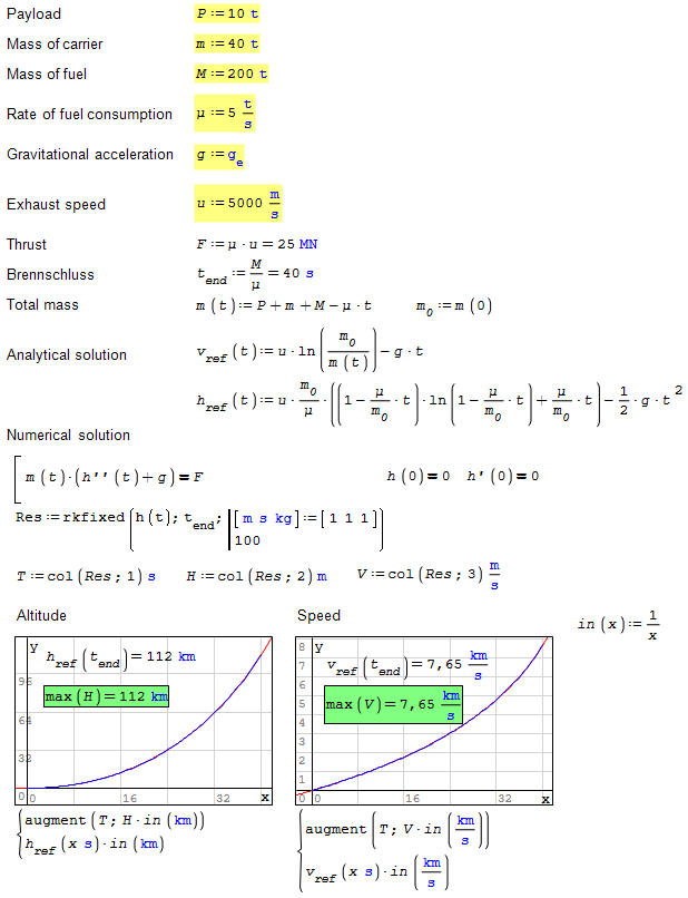

#12 Опубликовано: 15.12.2023 06:58:19
Analytical reference solution for h(t) (from a mechanics textbook) and with a single second order DE. in() would be even better without braces (operator form)
Rakete.sm (21,1 КиБ) скачан 1442 раз(а).
Rakete2.sm (21,45 КиБ) скачан 1483 раз(а).

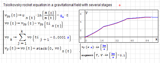

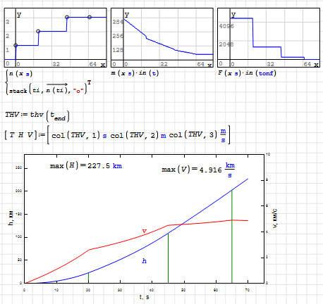

#20 Опубликовано: 18.12.2023 07:35:01
3 stages variation.
Checking with Tsiolkovsky rocket equation in a gravitational field with several stages
Rakete-3.sm (46,49 КиБ) скачан 1485 раз(а).
