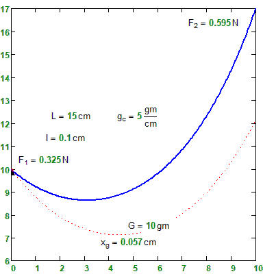

#1 Posted: 2024/4/13 14:19:39
Valery Ochkov
Valery Ochkov
66 likes in 690 posts.
I finally took a ride along this road with my granddaughter. On the way, I was not thinking about the beauty of Moscow, but about how to solve this problem at SMath.
Mathcad 15
Catenary-G-fixed.xmcd (58.54 KiB) downloaded 1311 time(s).

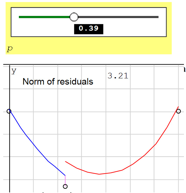

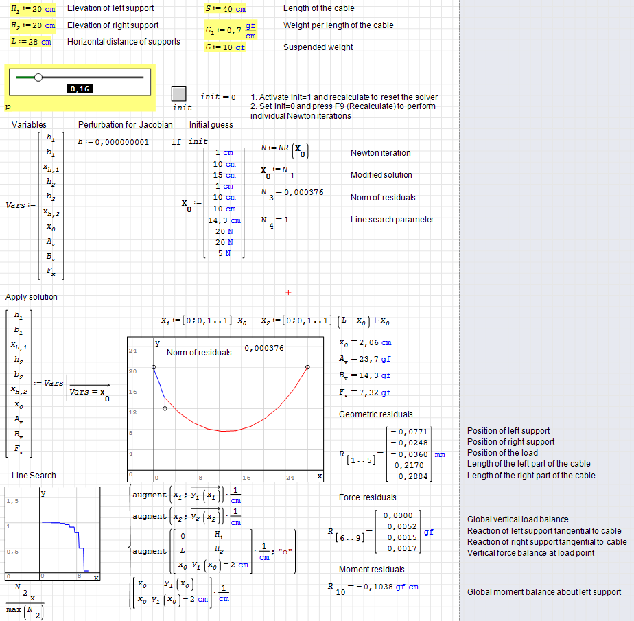

#4 Posted: 2024/4/16 06:01:25
1,355 likes in 2,271 posts.
This solution is not really animated but has a slider to change the position of the suspended load.
The solution is unreliable at the endpoints. The procedure is Newton-Raphson with approximated gradient.
Each new iteration uses the result of the previous one as initial guess. This is done using absolute variables. Just follow the instructions to properly initialize the procedure.
Seilbahn5a.sm (60.26 KiB) downloaded 1318 time(s).
Valery Ochkov 2024/4/16 12:16:00
#5 Posted: 2024/4/16 12:16:47
Valery Ochkov
Valery Ochkov
Sorry - not only
#6 Posted: 2024/4/17 06:05:12
Yes, that is dependent on how fast you move the slider, small steps usually produce good solutions. Note that the procedure just performs a single Newton iteration. To improve the solution, press F9 (recalculate). I forgot to mention this. Yet, this still does not always work.
In the given system there is no traction rope. There is a single rope which runs in an endless loop. There are several ways to parametrize the system. You can use the cable length on either side of the nacelle, or as I did, the fraction of the total length.

#10 Posted: 2024/4/20 15:37:23
Valery Ochkov
Valery Ochkov
My students solve this problem at the intersection of mathematics, mechanics and computer science (STEM education - see
https://www.routledge.com/25-Problems-for-STEM-Education/Ochkov/p/book/9781032174624).
We take an inextensible cable of length L and with a known specific gravity (the mass of one meter of cable). We attach a load of known mass to this cable at a distance l from one end of the cable. Next, the cable with the load is attached at two points. It is necessary to determine the geometry of the cable sag and the force at the attachment points. Then you need to change the value of l from zero to L and create an animation.
I can do this in Mathcad, but I cannot do it in SMath. I turned to you for help.
ioan92 2024/4/22 05:12:00

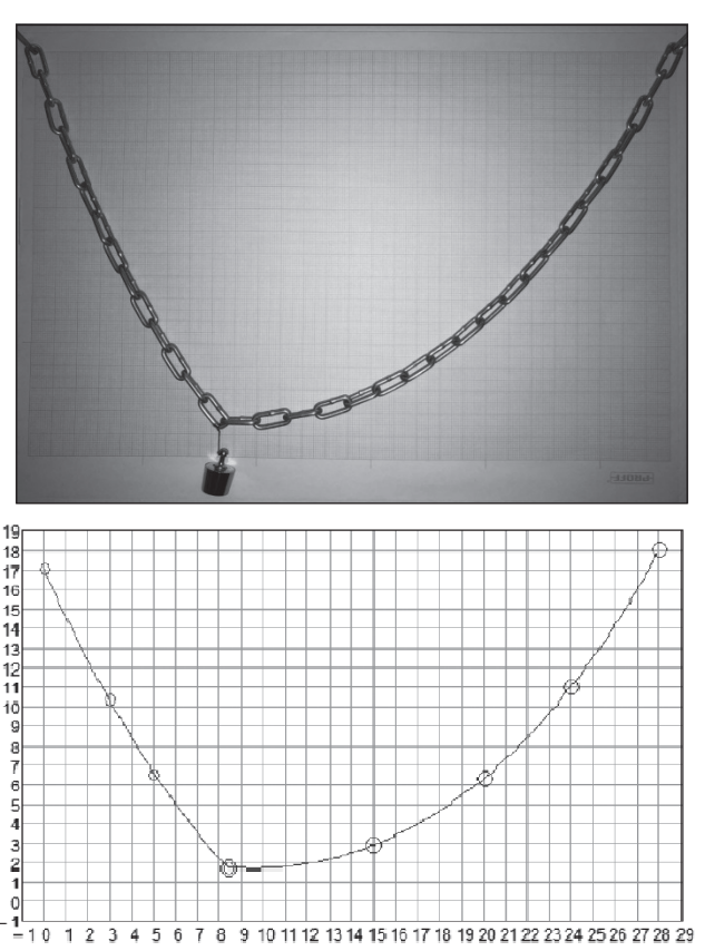

#16 Posted: 2024/4/21 01:43:12
Valery Ochkov
Valery Ochkov
Here is my force-balance approach to this problem.
I divide the cable weight into a number of nodes equally distributed along the cable, then add the cable car weight to one of the nodes (the one nearest to the distance that it was added in the original catenary file here, though this can be changed as desired). The nodes are then assumed to be connected by weightless, inextensible links.
It took me some time to get the syntax right! I’ve no doubt an SMath expert could significantly improve the implementation.
CableCar.sm (44.09 KiB) downloaded 1361 time(s).
See please Figures in my article
http://twt.mpei.ac.ru/ochkov/Chain.pdf
ioan92 2024/4/21 03:57:00
