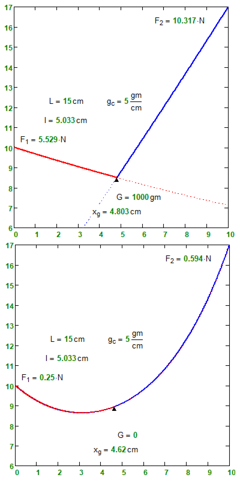

#1 Опубликовано: 13.04.2024 14:19:39
Valery Ochkov
Valery Ochkov
67 сообщений из 713 понравились пользователям.

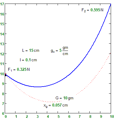

I finally took a ride along this road with my granddaughter. On the way, I was not thinking about the beauty of Moscow, but about how to solve this problem at SMath.
Mathcad 15
Catenary-G-fixed.xmcd (58,54 КиБ) скачан 1539 раз(а).

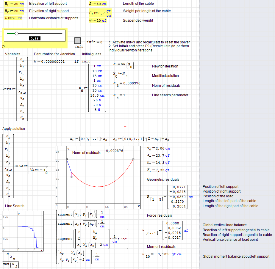

#4 Опубликовано: 16.04.2024 06:01:25

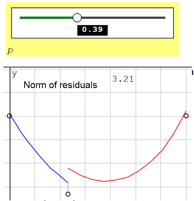

This solution is not really animated but has a slider to change the position of the suspended load.
The solution is unreliable at the endpoints. The procedure is Newton-Raphson with approximated gradient.
Each new iteration uses the result of the previous one as initial guess. This is done using absolute variables. Just follow the instructions to properly initialize the procedure.
Seilbahn5a.sm (60,26 КиБ) скачан 1510 раз(а).
Valery Ochkov 16.04.2024 12:16:00

#6 Опубликовано: 17.04.2024 06:05:12
Yes, that is dependent on how fast you move the slider, small steps usually produce good solutions. Note that the procedure just performs a single Newton iteration. To improve the solution, press F9 (recalculate). I forgot to mention this. Yet, this still does not always work.

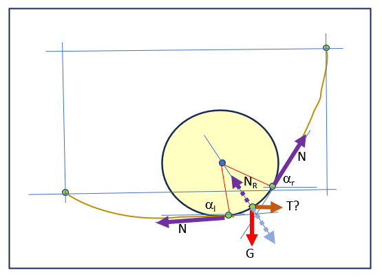

Hi Valery, Hi Everybody,
I think that it could be possible to deal with the problem as a structural equilibrium one, using a FEM technique. The drawing and the animation are details after having the right results.
It seems that the rope is considered as inextensible; an approximation not always accepted.
The proposed dimensions let us think more to a sort of toy than to a technical object as that from the photo.
However, this does not represent a too high difficulty for looking for a solution. In fact, for each X given abscissa value, there is to obtain the Y ordinate value for the nacelle position. In each (X;Y) nacelle position, the force’s equilibrium must be assured. This is the way to determine the Y for each given X. The traction rope must assure the missing force to fix the nacelle in a position. Without knowing the traction rope data, the problem is not enough defined (?).
Another variable could be the length of one of the two segments of the cable...
If I understand, the proposed problem includes some input features and data as:
• A unique nacelle rolling with a pulley on the carrying rope (???) : G=10 g.
• A carrying rope : dX = 10cm; dY = 7cm; L = 15cm; gc = 5g/cm; Gc = 15cm x 5g/cm = 75g.
• A traction rope: undefined as geometry and its end support positions. (???) Its behavior is unclear for me …
An equillibrium possibility:

#8 Опубликовано: 19.04.2024 19:13:06
In the given system there is no traction rope. There is a single rope which runs in an endless loop. There are several ways to parametrize the system. You can use the cable length on either side of the nacelle, or as I did, the fraction of the total length.

I asked if the animation introduced by Valery concerns a real technical problem like in his photo or is a simple mathematical abstract discussion.
Perchance, I’m familiar enough with cable’s analysis focusing on the engineering use. Next, I’ll point some basics, as I understand them now. I’m grateful for any eventual critics or suggestions.
From the practical viewpoint, there are two main families of cable transportation application:
* Using one alone cable with the cabins sealed on it:
* Using a couple of:
i. a carrying cable, on which the cabin(s) are rolling with pulleys and
ii. another traction cable for controlling the movements of cabin(s).
From geometrical viewpoint, an inextensible catenary (cosh(x)) cable is a plan figure, enough defined by three geometrical data (e.g.: the two projections H and V and the developed length of the cable L).
From mechanical viewpoint it is necessary to know also the load (constant on the whole length of the cable) w.
These data are enough to establish its full geometry and also the 4 (3 distinct – the two horizontal reactions are equal) values of reactions on its length using one equation.
The problem in discussion here can be reduced to a couple of two elementary cables, linked to the point where the G force from the cabin is applied. For each position of the cabin fixed on the cable, there can be identified two elementary cables.
A solution to obtain the two coordinates of the cabin is (as Martin mentioned) to use as input variable the length of one of the two elementary cables and to deduct from the two equilibrium projections, the two coordinates of the cabin (X and Y). These can be used to draw (animate) the cabin’s position.
A parametric formulation is useful.
Once these hypotheses are accepted, the rest is nothing than some mathematical developments. I do not reproduce all the mathematics development here because I’m in a publishing progress with the subject of catenary and parabolic cable as well extensible as not extensible.

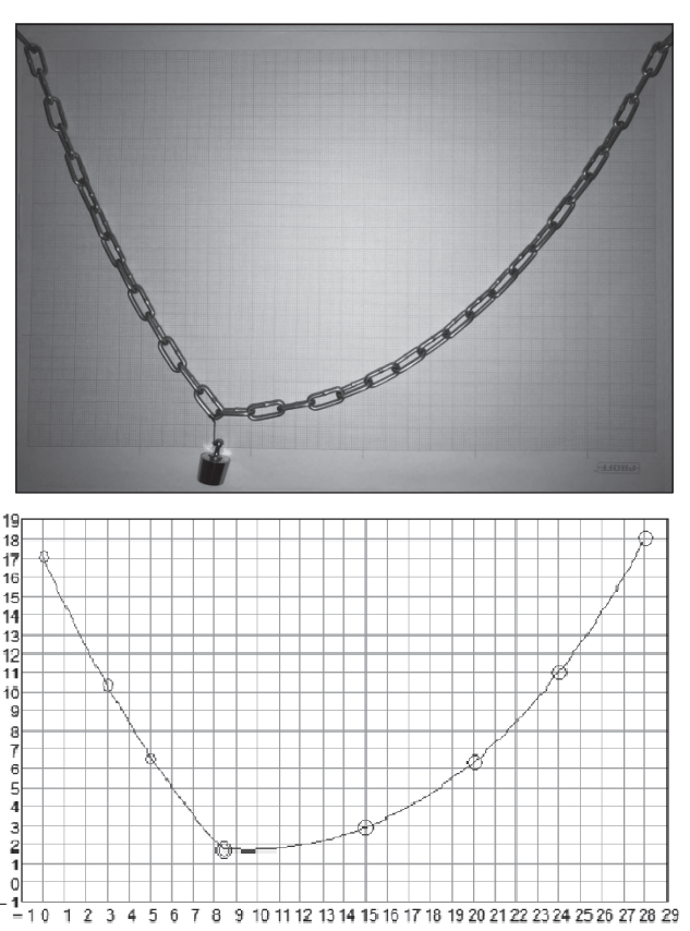

My students solve this problem at the intersection of mathematics, mechanics and computer science (STEM education - see
https://www.routledge.com/25-Problems-for-STEM-Education/Ochkov/p/book/9781032174624).
We take an inextensible cable of length L and with a known specific gravity (the mass of one meter of cable). We attach a load of known mass to this cable at a distance l from one end of the cable. Next, the cable with the load is attached at two points. It is necessary to determine the geometry of the cable sag and the force at the attachment points. Then you need to change the value of l from zero to L and create an animation.
I can do this in Mathcad, but I cannot do it in SMath. I turned to you for help.

The dotted lines are a phantom continuation of the catenary.
If G=0 we have one line.
#13 Опубликовано: 20.04.2024 16:48:57
ioan92
ioan92
181 сообщений из 125 понравились пользователям.
If the cable is fixed on its two ends, "the phantom" must be a cosh curve passing through this 2 same points ??? !!!

See please Figures in my article
http://twt.mpei.ac.ru/ochkov/Chain.pdf

See please Figures in this article too
http://twt.mpei.ac.ru/ochkov/catenary.pdf
