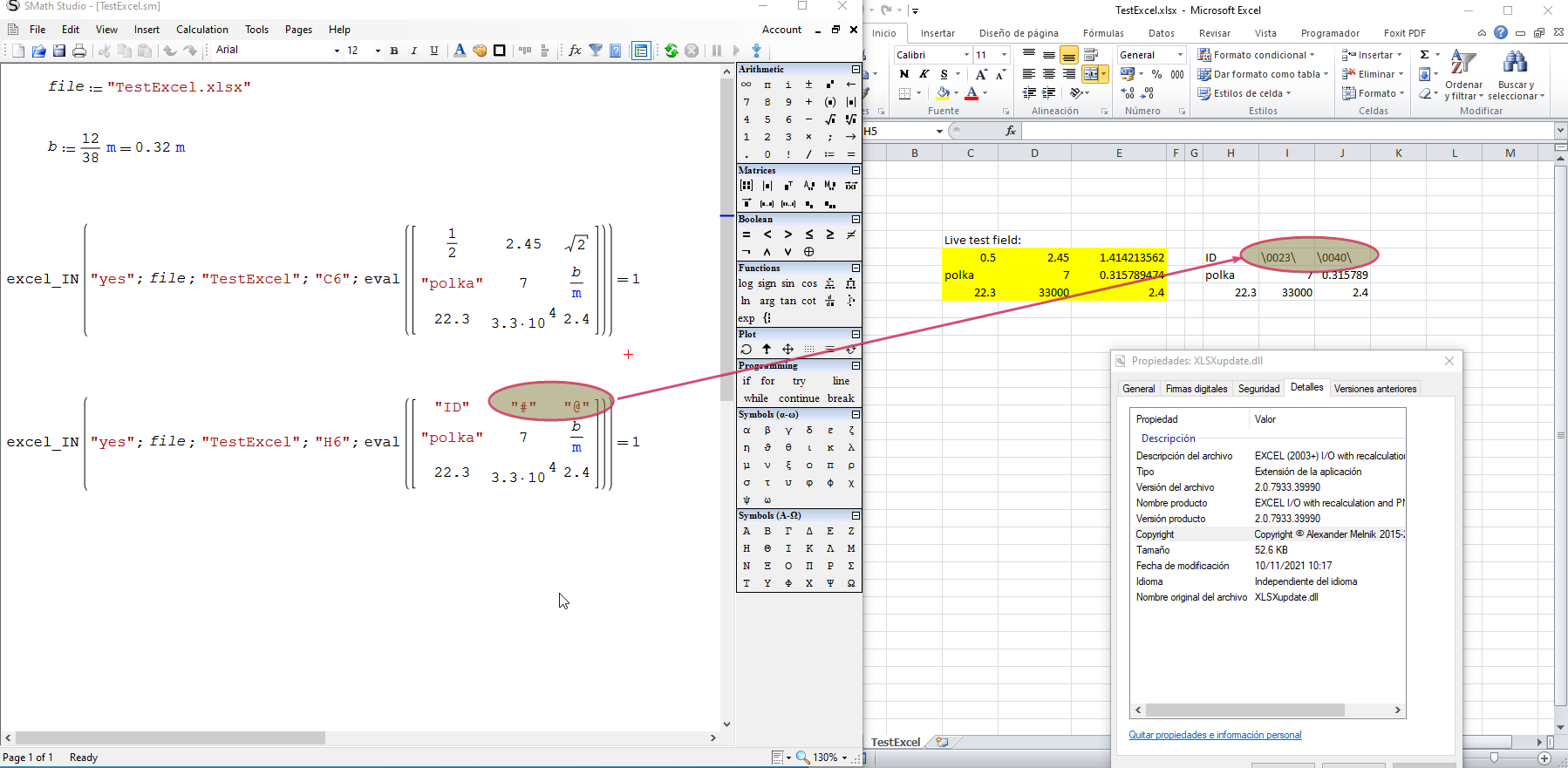

Hi! I'm having trouble sending String variables to Excel.
For instance, ". - / ! ? ;" turns into \002E\\0020\\002D\\0020\\002F\\0020\\0021\\0020\\003F\\0020\\003B\ in Excel.
I'm using most recent SMath and Excel I/O versions.

#109 Posted: 2021/11/10 12:26:03
oscar mauricio
oscar mauricio
1 likes in 10 posts.
Hi, I have the same problem as Ricardo, any recommendations to solve it?
Show Spoiler
#110 Posted: 2021/11/11 05:35:29
1,554 likes in 1,864 posts.
SMath Studio compatibility
Plugin updated.
Changes:
- excel_in(): text encode issue fixed.
João Felipe Seráfico Melo 2021/11/11 08:48:00, oscar mauricio 2021/11/11 08:49:00

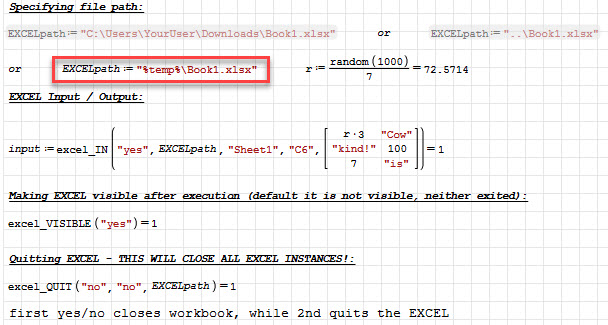

#113 Posted: 2022/7/3 05:04:57
1,123 likes in 1,795 posts.
Plugin updated. ...
- added support for environment variables;
Hi Viacheslav. An example about what does that mean? Thanks.
#114 Posted: 2022/7/3 06:10:06
You can use operating system environment variables in the file path.
4 users liked this post
NDTM Amarasekera 2022/7/3 08:00:00, churichuro 2022/7/3 12:59:00, Alvaro 2022/7/3 15:51:00, oscar mauricio 2022/7/7 11:37:00

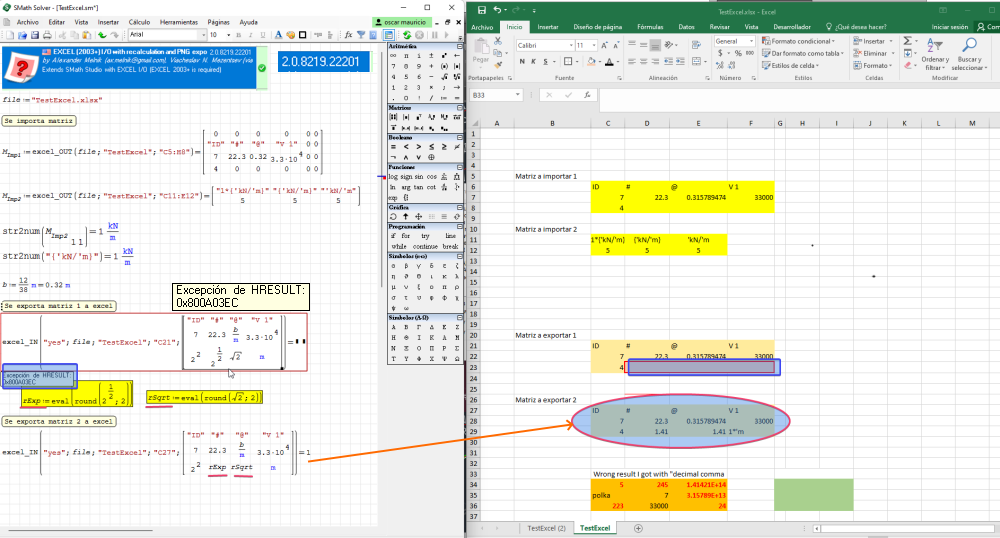

#115 Posted: 2022/7/7 11:54:58
oscar mauricio
oscar mauricio
Hello thanks for the plugin, I found a problem in the excel_In() command. I present it in the image, I hope it can be resolved in future versions.
#116 Posted: 2022/7/8 04:45:19
Plugin updated. Please try.
Changes:
- ToCell(): Globals.Excel.DecimalSeparator replaced by the CultureInfo.GetCultureInfo( "en-EN" ).NumberFormat.NumberDecimalSeparator;
- ToCell(): Double.Parse() fixed;
- part of the book "Excel 2002 VBA Programmer's Reference" added (Chapter 22. International Issues).
Click to enlarge
oscar mauricio 2022/7/8 16:00:00

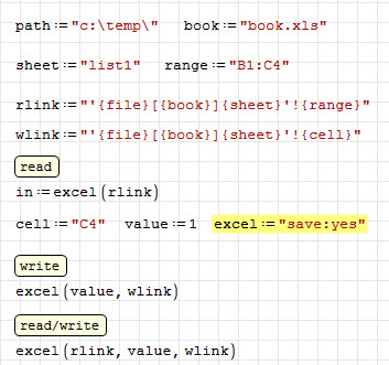

#117 Posted: 2022/7/8 07:01:35
It is possible to simplify the interface. I can add a new feature. You can suggest your own version for a new feature.
#118 Posted: 2022/7/9 06:43:56
In a future release I will remove functions from ExcelIOCom to XLSXupdate. One function and one operand will be added.
churichuro 2022/7/9 11:09:00, sergio 2022/7/9 11:20:00
#119 Posted: 2022/7/9 12:41:31
SMath Studio compatibility Examples
Changes:
- excel operand and excel() function added;
- readCell() and writeCell() moved from the ExcelIOCom plugin;
- examples added;
- refactored.
sergio 2022/7/11 05:47:00
