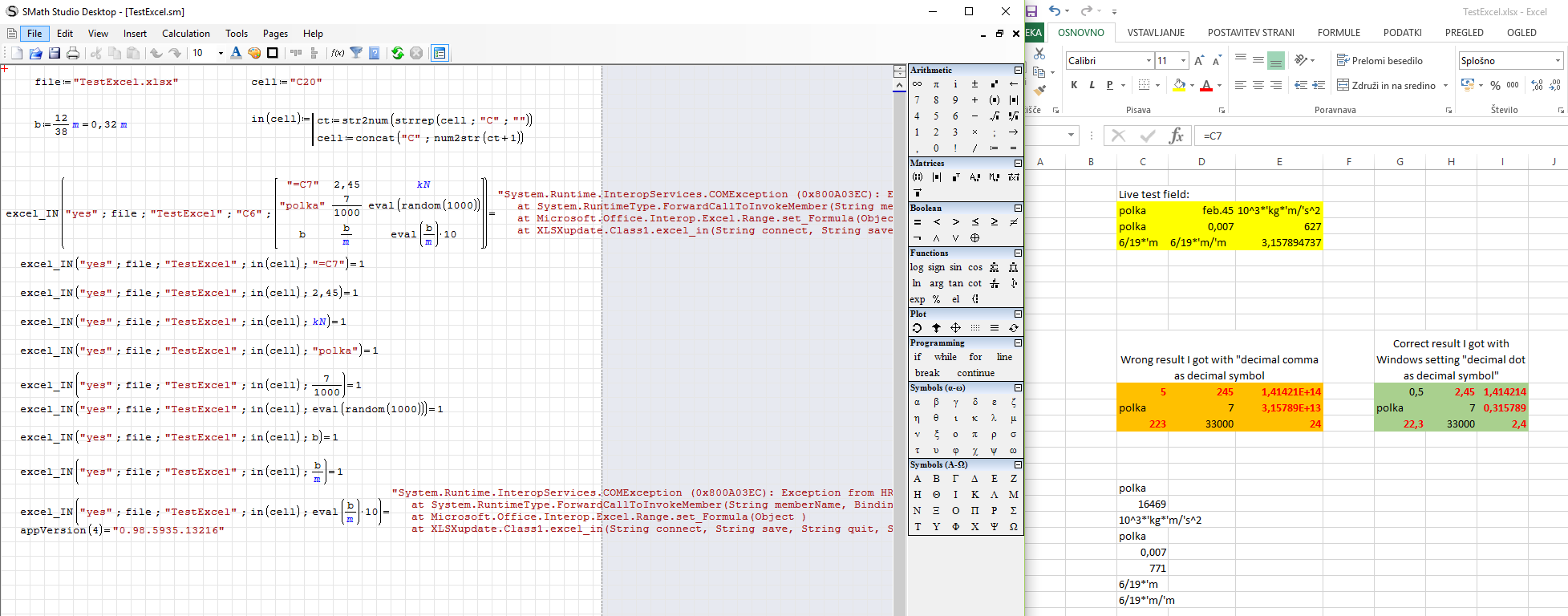

Please post offending Smath file, xls file, Decimal and argument separator settings from Smath, decimal and argument separator settings from Windows (with directions where to find them - never used comma as my system decimal separator before)
I tried once again. The problem is stil present. Setting of decimal symbol in Smath (I tried with dot ("." ) and with comma ("," )) doesn't have influence. Argument separator is defined as ";".
Influence has Windows system setting. Everything work correctly when dot ("." ) is defined as Decimal symbol and comma ("," ) as Digit grouping symbol. When it is defined vice versa (this is standard setting for many European countries), values in SMath which does have decimal part are treated in such a way as their decimal symbol is ignored (for example 12,45 is treated as 1245).
I use eval function in order to properly treat also values with units (otherwise I got en error))
Here http://www.softwareok.com/?seite=faq-Windows-7&faq=78 you can see how to change Windows system setting (I have Slovenian version of Windows 7 and Windows 10, so above link would be more helpful to you than screen shots from my computer.
In attachment you will find offending Smath file and excel. In Excel you will find also "staticaly entered" values I got in both cases.
TestExcel.zip (7.92 KiB) downloaded 433 time(s).

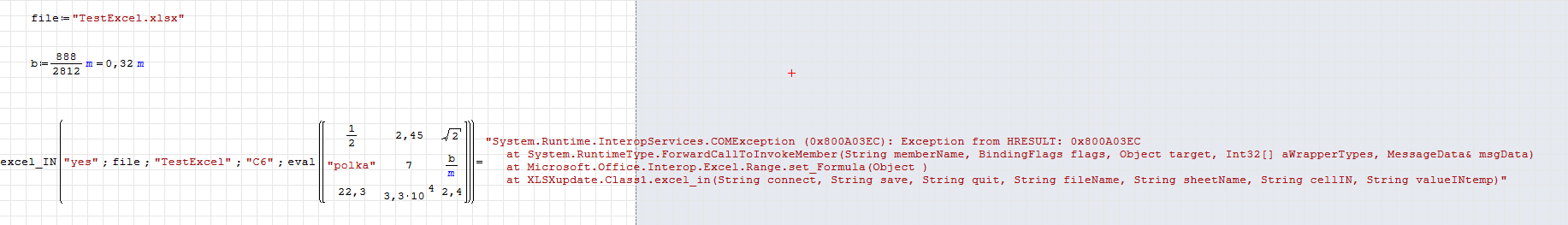

Thank you very much, but I am sorry to report that the test example I sent in previous message produces COM exception when testing with plugin version 0.2.0.14035. The only difference is plugin version. TestExcel.sm file with plugin version 0.2.0.11351 works correctly (but, as expected, with bug), when I change to plugin version 0.2.0.14035, I got a message as you can see below. If it helps: When trying with newer version -- Excel file is opened correctly, after that I got an error in Smath and excel file is not updated. At my computer is quite repeatable -- no other change than plugin version is neccessary to reproduce.
Smath version: 0.98 build: 5935
Excel version: Microsoft Excel 2013 (15.0.4805.1001) 32 bit

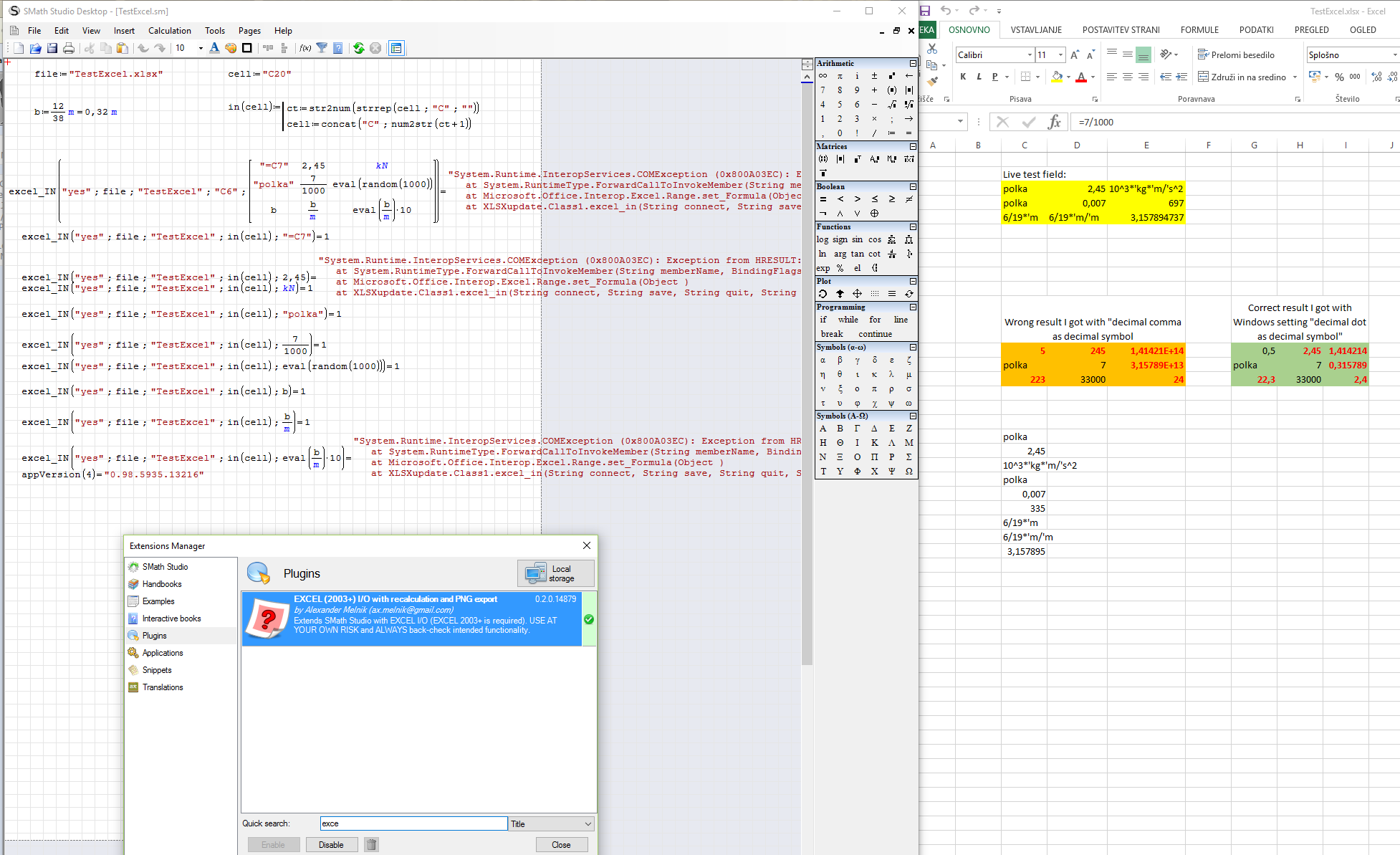

Here are results from me. I tried to give you similar information as you. I don't see any pattern. :-(

Yes. After I sent a message, I saw this detail. It seems that problem exists when it is neccessary to transfer "real floating" (not fraction) number. Unfortunately plugin version .14879 does not help:

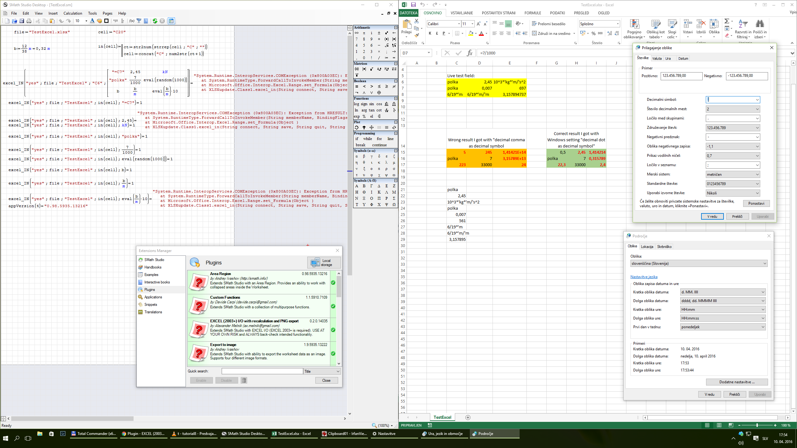

Here is the result. In order to be much clear what is transferred and what is not I deleted target cells in TestExcel.xslx before opening TestExcel.sm. As you can see, 2.45 is reported as transferred, but value in Excel is incorrect. Last value (eval(b/'m)*10 still didn't go through.Test Excel3.png

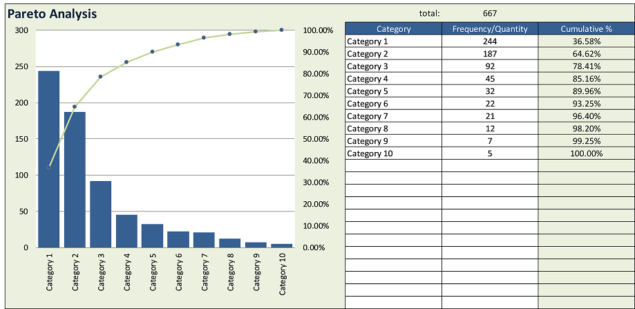

Plugin update.
With the help of Davide I have managed to increase the speed of EXCEL range screenshot capture by a factor of X4 to X8. Captured screenshots can be displayed using the Image Region.
Why is this important? User can display visual feedback of EXCEL I/O with virtually no loss in performance. This is useful for visual check of I/O values not only by user but also by anyone who can visually see the printout of SMath workbook.
Export of pixel perfect EXCEL charts is now an option as well.
Function excel_PNG() was modified to take 5th argument – the font size of excel range table headers (set to 0 if none). Functions excel_PNGv0 and excel_PNGv2 are obsolete, however kept for the sake of backward compatibility.
