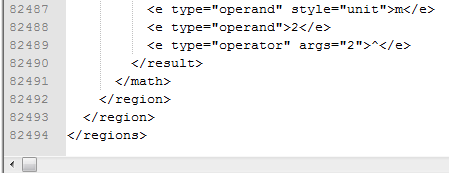

Hi all,
Trying to reopen a file that I wrote and that refused to be closed normaly, I receive this message:
"Unexpected end of file occured.
The following elements are not closed:
result, math, region, regions. Line 82490, position 12."
I posted the file here:
file
Is it possible to recover the file ? If yes, how ?
Thanks a lot for any help,
Ioan

the link to the file points to a hoster which requires login/registration. I won't create a login at a filehoster just to download a single file. You might use dropbox or the smath wiki file management.
The problem might be solved by just closing the xml tags in the file, but I can't try...
The solution is indicated by mkraska and the result is in the attached file
regards,
w3b5urf3r

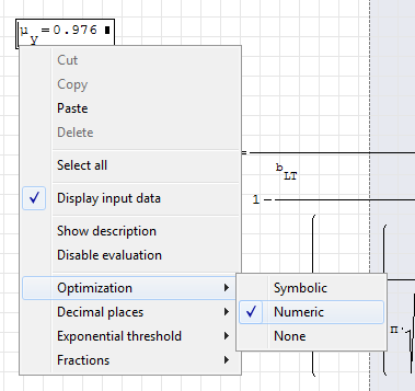

I still have a problem with this file:
all results are in fractional mode, against my temptatives of changing.
#6 Posted: 2012/7/3 07:18:06
1,443 likes in 2,935 posts.
You are welcome
simply change the result optimization from "none" to "numeric"
regards,
w3b5urf3r
