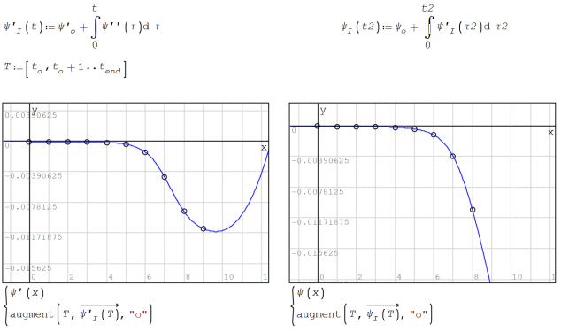

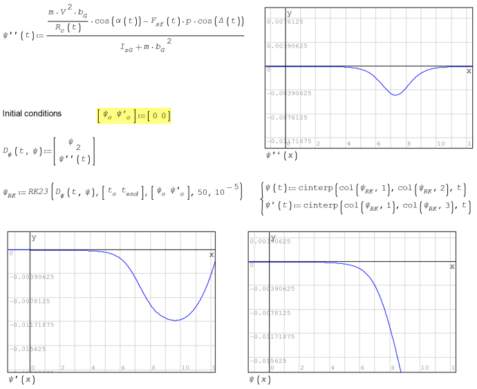

Hi, sorry if I bother you again. I'm trying to integrate a function, the function in question is psi''(t) in order to derive psi'(t).
I tried using Simpson and Romberg's recursive methods, but without getting a solution.
Where am I wrong?
PROJECT.sm (69.12 KiB) downloaded 1216 time(s).
#32 Posted: 2019/12/28 21:59:18
You have phi in your document ... psi is a built-in function.
So, if phi''(t) is the 2nd derivative ... then the derivative
is simply the integral. To expedite fast: done discrete.
If you have questions: please re-post this document.
Cheers ... Jean.
PROJECT [1].sm (30.82 KiB) downloaded 967 time(s).

#34 Posted: 2019/12/29 09:18:44
... lot more maths in there.
PROJECT [1].sm (44.37 KiB) downloaded 993 time(s).

1,123 likes in 1,795 posts.
Where am I wrong?
Hi. You can use any Runge Kutta solver for integration.
Also, you can use SMath int procedure, but it's very (very) slow:
For the theory, remember that you can integrate (with definite integrals) both sides of an equation and get an equality too, which don't work with derivatives.
PROJECT.sm (74.9 KiB) downloaded 1194 time(s).

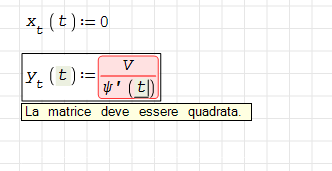

Hi, I have calculated the function psi '(t) through dn_GearsBDF.
But now I can't calculate the ratio in the picture.
The error says, "The matrix must be square"
PROJECT.sm (57.24 KiB) downloaded 1202 time(s).
#37 Posted: 2019/12/29 14:19:55
Result from numerical ODE solvers is a data set.
Generate an interpolation scalar to 'x' ... then plot.
@ the end of the document ... more questions: -this one.
PROJECT (1).sm (74.9 KiB) downloaded 1184 time(s).
