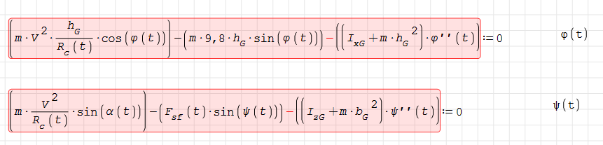

Hello everyone! I wanted to know if it is possible to solve differential equations with Smath Studio. in particular I would be interested in solving ordinary nonlinear second order differential equations.
Thanks in advance.

Hi, the differential equations that i should solve are like the ones in the picture:
here is also the .sm file… Documento2 DE.sm (21.27 KiB) downloaded 1143 time(s).

Yes, the problem is the same as a few days ago. This time, however, I had to modify it slightly and I must be able to derive the psi and phi functions using the differential equations in the figure.
... still undefined wrt φ'(t)
If you can help more: please re-post this document
so to avoid refactoring.
If you have the original work out and solution it
might help converting to Smath
Documento2 DE [explain more].sm (33.26 KiB) downloaded 921 time(s).

Why should i define the phi function?
Should I get it by solving the differential equation, or am I wrong?
#12 Posted: 2019/12/23 14:46:23
You are right, after the numerical ODE solver you will have
the manipulate the solution depending upon sin/cos
The 2nd term is not a simple coefficient. That induces FinDiff.
So, you have nothing from source ? Pure invention top/bottom.
Documento2 DE [explain more].sm (66.82 KiB) downloaded 944 time(s).

Hi, thanks for the help and patience.
This is a task I have been assigned and I am not following any source.
If it can be helpful to derive the function phi, I know that:
-for t=0, phi=0
-for t=6.187, phi=0.867 and phi'=0
#17 Posted: 2019/12/24 23:31:28
-for t=0, phi=0
we have that from freaking p1 parameter
and obviously phi'=0
for t=0, phi=0 ...that can't be
whereas the system starts @ IC 0.005
1. Make sure the DE as proposed is OK
2. What software the presumed assignment is based on ?
... it could be wrong from the onset !!!
Documento2 DE [explain more].sm (48.35 KiB) downloaded 973 time(s).

I modified some values ​​and a relationship because I noticed an error.
The differential equation, on the other hand, should be correct because it comes out of the physical problem it is trying to solve.
As for the assignment of values, I always get them from the physical system knowing more or less the trend of the phi function to be obtained.
If it can help the progress of this function it is the following:
-The phi function starts from 0.147 for t = 0, grows up to a maximum equal to 0.867 for t = 6.187 and finally decreases
-The function phi' instead starts from a value 0 for t = 0, in the interval between t = 0 and t = 6.187 reaches a maximum and then returns to 0 when t = 6.187
Then I would have a question, why does phi' appear in the differential equation and not phi?
#19 Posted: 2019/12/25 10:21:29
Good question: you are the Man who proposed the DE phi'.
For your above attempted explanation, you are just presuming.
1. Setup the DE ... as per the assignment
2. Confirm the reference solver software the Originator is using.
Will be back while waiting.
The project is pure blue sky ... sending a fly to Cirus ?
