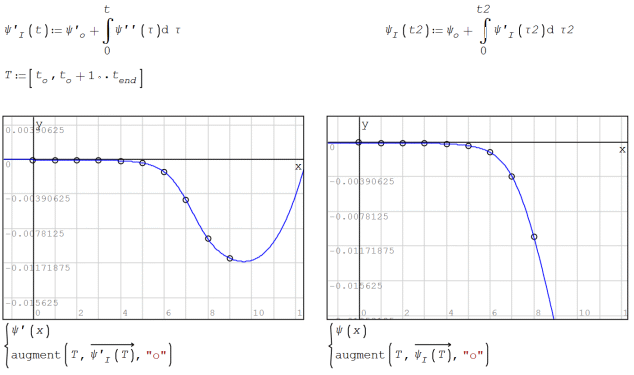

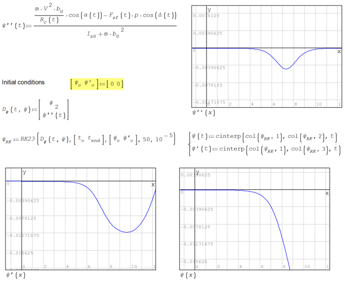

#31 Опубликовано: 28.12.2019 18:49:56
Ale16595
Ale16595
0 сообщений из 35 понравились пользователям.
Hi, sorry if I bother you again. I'm trying to integrate a function, the function in question is psi''(t) in order to derive psi'(t).
I tried using Simpson and Romberg's recursive methods, but without getting a solution.
Where am I wrong?
PROJECT.sm (69,12 КиБ) скачан 1382 раз(а).
#32 Опубликовано: 28.12.2019 21:59:18
You have phi in your document ... psi is a built-in function.
So, if phi''(t) is the 2nd derivative ... then the derivative
is simply the integral. To expedite fast: done discrete.
If you have questions: please re-post this document.
Cheers ... Jean.
PROJECT [1].sm (30,82 КиБ) скачан 1138 раз(а).
#33 Опубликовано: 28.12.2019 23:19:45
.... in fact you have PSI''(t).
Maple does not find an explicit integral.
PROJECT [1].sm (21,91 КиБ) скачан 1151 раз(а).
#34 Опубликовано: 29.12.2019 09:18:44
... lot more maths in there.
PROJECT [1].sm (44,37 КиБ) скачан 1163 раз(а).
#35 Опубликовано: 29.12.2019 11:16:00
Where am I wrong?
Hi. You can use any Runge Kutta solver for integration.
Also, you can use SMath int procedure, but it's very (very) slow:
For the theory, remember that you can integrate (with definite integrals) both sides of an equation and get an equality too, which don't work with derivatives.
PROJECT.sm (74,9 КиБ) скачан 1393 раз(а).
frapuano 29.12.2019 14:27:00

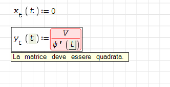

#36 Опубликовано: 29.12.2019 11:21:10
Ale16595
Ale16595
Hi, I have calculated the function psi '(t) through dn_GearsBDF.
But now I can't calculate the ratio in the picture.
The error says, "The matrix must be square"
PROJECT.sm (57,24 КиБ) скачан 1377 раз(а).
#37 Опубликовано: 29.12.2019 14:19:55
Result from numerical ODE solvers is a data set.
Generate an interpolation scalar to 'x' ... then plot.
@ the end of the document ... more questions: -this one.
PROJECT (1).sm (74,9 КиБ) скачан 1371 раз(а).
