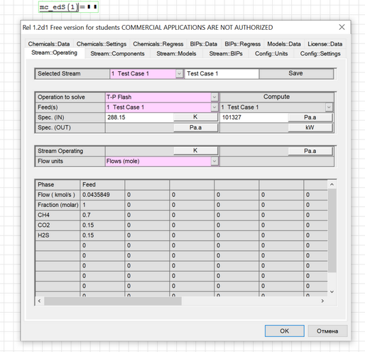

3. When second popup window, the Prode archive, appears, it should show stream 2. Click OK.

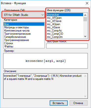

I added the ppp.dll to userefi folder, but only kronecker and Psi show in the function list for EFI. I have restarted the SMath program and also disabled EFI and then enabled it an still no mc_xxxx functions.

The GOOD NEWS: Prode Phys. Properties works! The functions appear in the function list and the test file opens. There were some errors but I may be able to fix those. It appears that one problem is the SMath program doesn't recognize disabled math statements. That could explain some of the errors.
