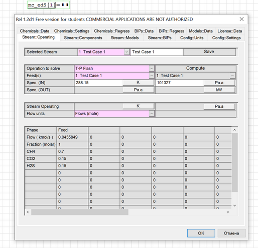

You must copy ppp.dll and prode.dll to the userefi folder and restart the program. After that you must point to some location when document opened.
Procedure:
1. Calculate the entire worksheet, ctrl-F9
2. Select dep.ppp archive when first window appears, and click Open
3. When second popup window, the Prode archive, appears, it should show stream 2. Click OK.
I don't have this archive and this folder and I no longer remember what it is for. But now all functions are accessible.

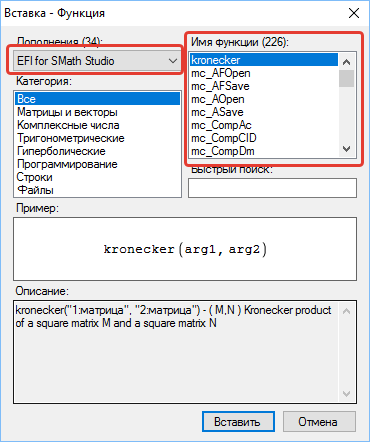

I added the ppp.dll to userefi folder, but only kronecker and Psi show in the function list for EFI. I have restarted the SMath program and also disabled EFI and then enabled it an still no mc_xxxx functions.

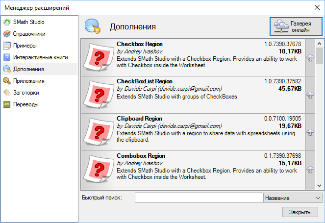

#15 Опубликовано: 30.05.2020 16:44:57
Using this window

The GOOD NEWS: Prode Phys. Properties works! The functions appear in the function list and the test file opens. There were some errors but I may be able to fix those. It appears that one problem is the SMath program doesn't recognize disabled math statements. That could explain some of the errors.
