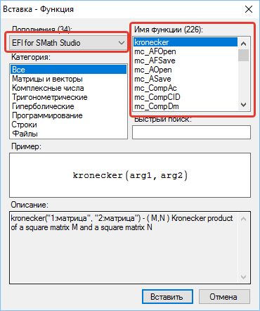

You must copy ppp.dll and prode.dll to the userefi folder and restart the program. After that you must point to some location when document opened.
I don't have this archive and this folder and I no longer remember what it is for. But now all functions are accessible.
When the program is running, you can see the list of loaded functions in the log file (mcadefi.log) in the folder with the plugin.

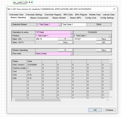

Procedure:
1. Calculate the entire worksheet, ctrl-F9
2. Select dep.ppp archive when first window appears, and click Open
3. When second popup window, the Prode archive, appears, it should show stream 2. Click OK.

I added the ppp.dll to userefi folder, but only kronecker and Psi show in the function list for EFI. I have restarted the SMath program and also disabled EFI and then enabled it an still no mc_xxxx functions.

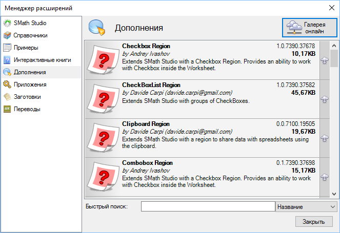

Reopen I mean, try to reinstall the plugin using the Extension manager.
The default path for plugin is: C:\Users\%user_name%\Application Data\SMath\extensions\plugins\91a20d24-c30b-4774-9b1b-4d502a80420f\x.x.x.x\

Before I start the re-installation process, I have a question: By Extension manager do you mean tools>plugins? I see no Extension manager.
